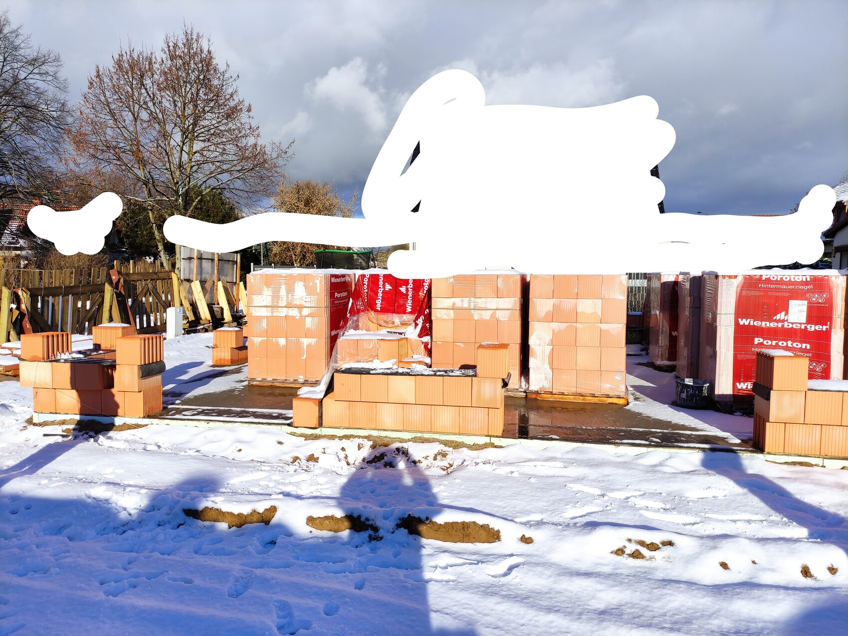

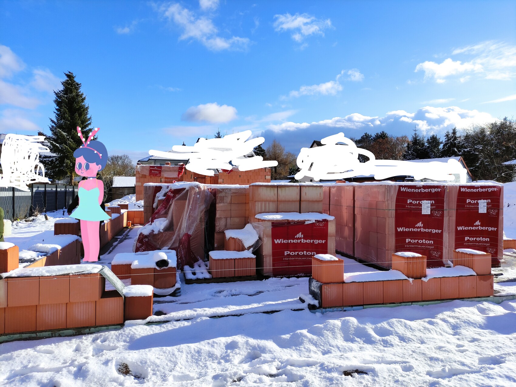

Another brick will surely be added there. Because of the perspective, I can’t accurately judge the offset of the first layer above the base, but the overlap dimension seems to require inspection.
Tolentino schrieb:
The last photo shows a fairly large gap. Up to what size is that still allowed?
Tolentino schrieb:
Up to what size is that still allowed? 😱 What were you thinking with that little doll?
Well, I prefer not to share my lovely wife on the web, but next time I can post a neutral image. It was just what was on my Chinese phone. I could have used a dinosaur instead, but my wife wouldn’t have liked that...
The lap joint is about 5cm (2 inches) and should be fine since the workers also said that 5cm (2 inches) of insulation will be added on top.
