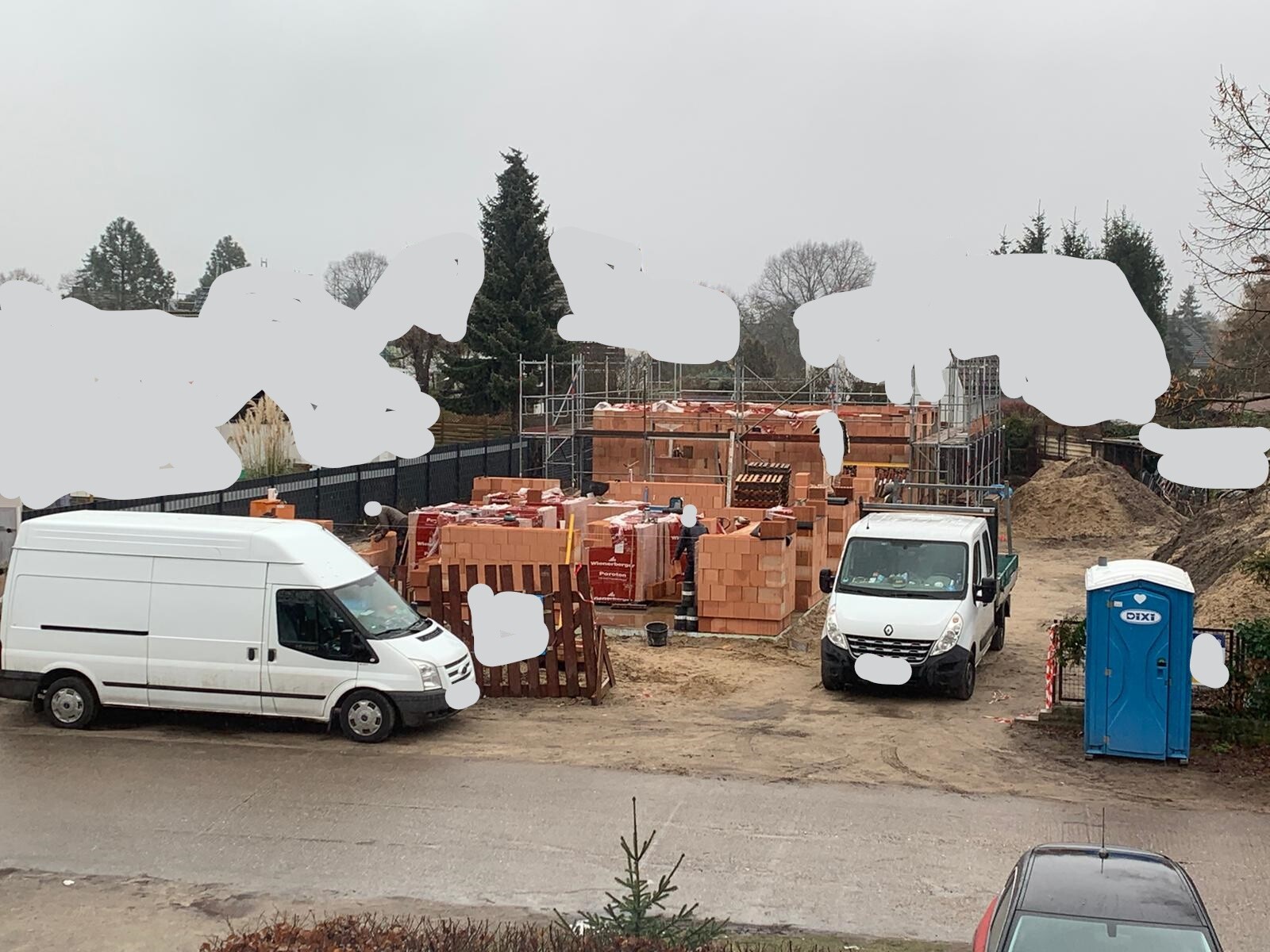

Tolentino4 Feb 2021 10:28
Yesterday morning we were still standing almost two rows back, discussing, and today they are getting serious...
(the front part is mine...)

Tolentino4 Feb 2021 18:16

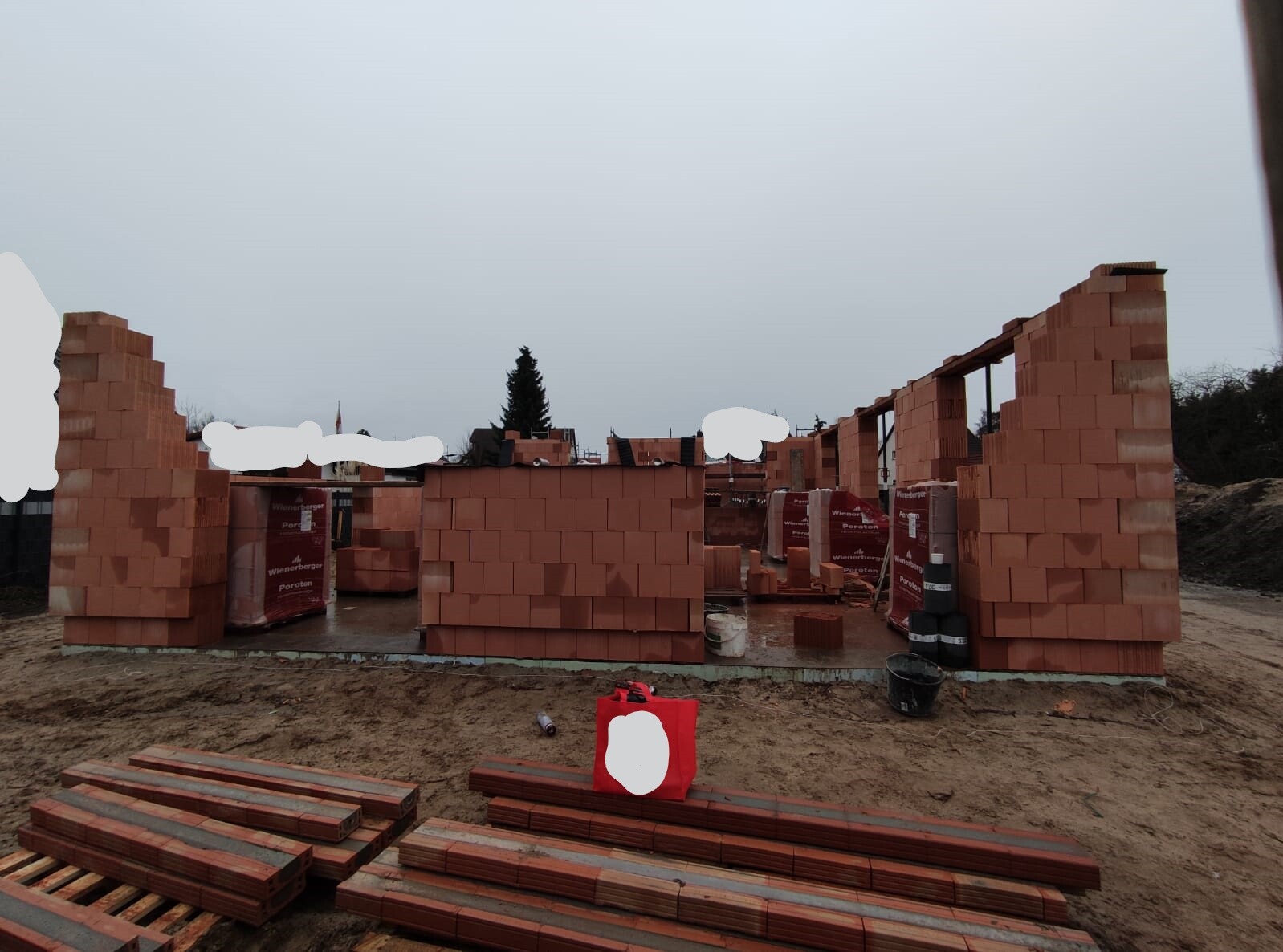

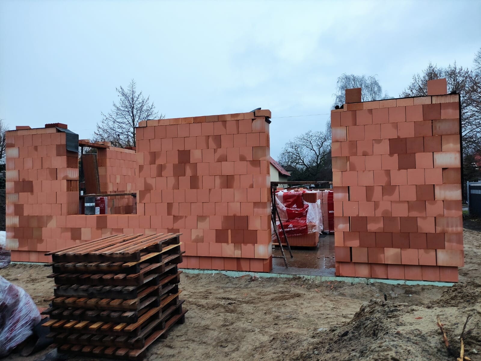

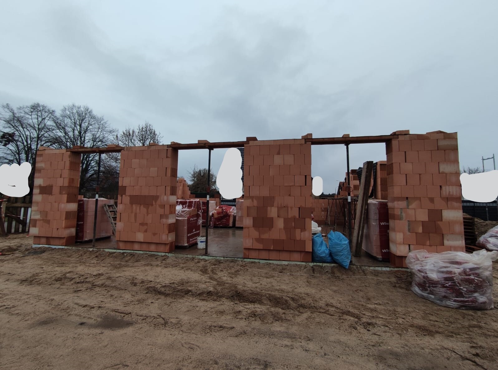

We’ve made significant progress...

Tolentino4 Feb 2021 18:17

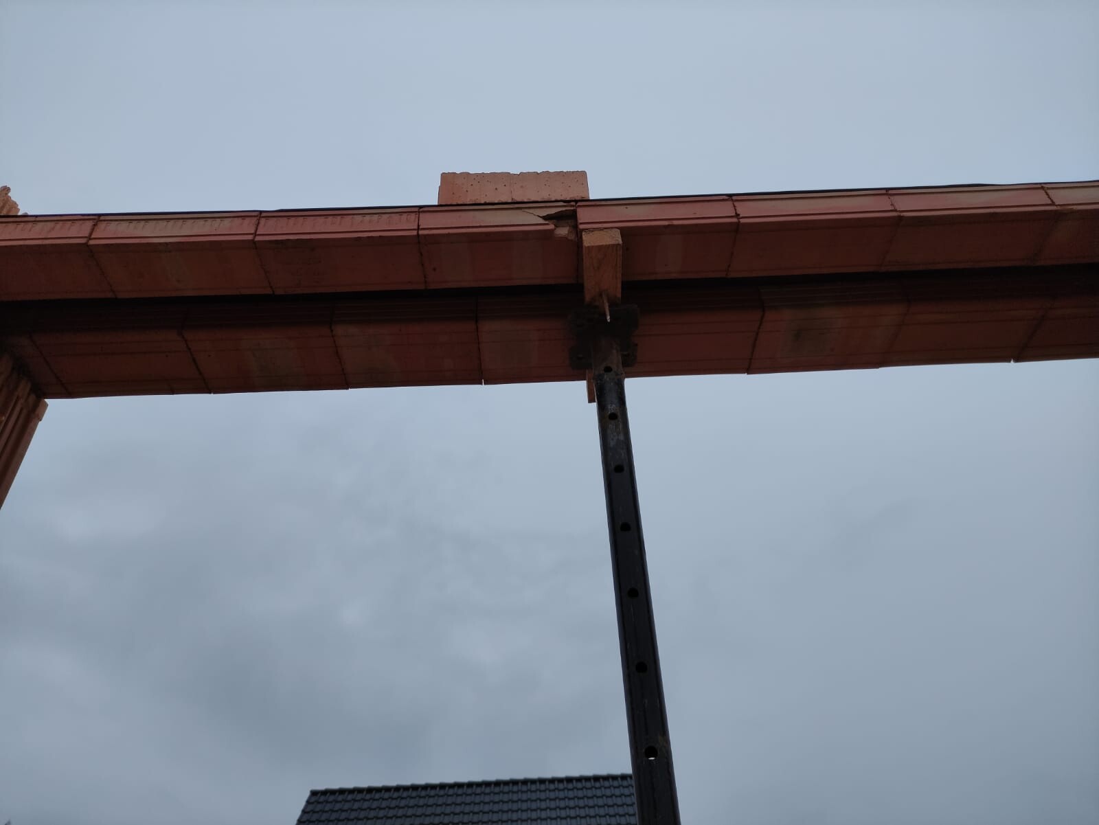

Is it acceptable to have a step like that in the lintel?
Overall, the workmanship seems a bit rushed, doesn’t it?

11ant4 Feb 2021 18:49

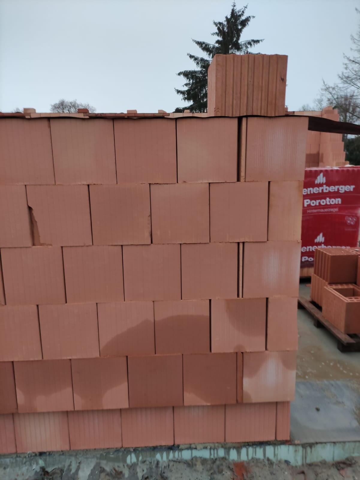

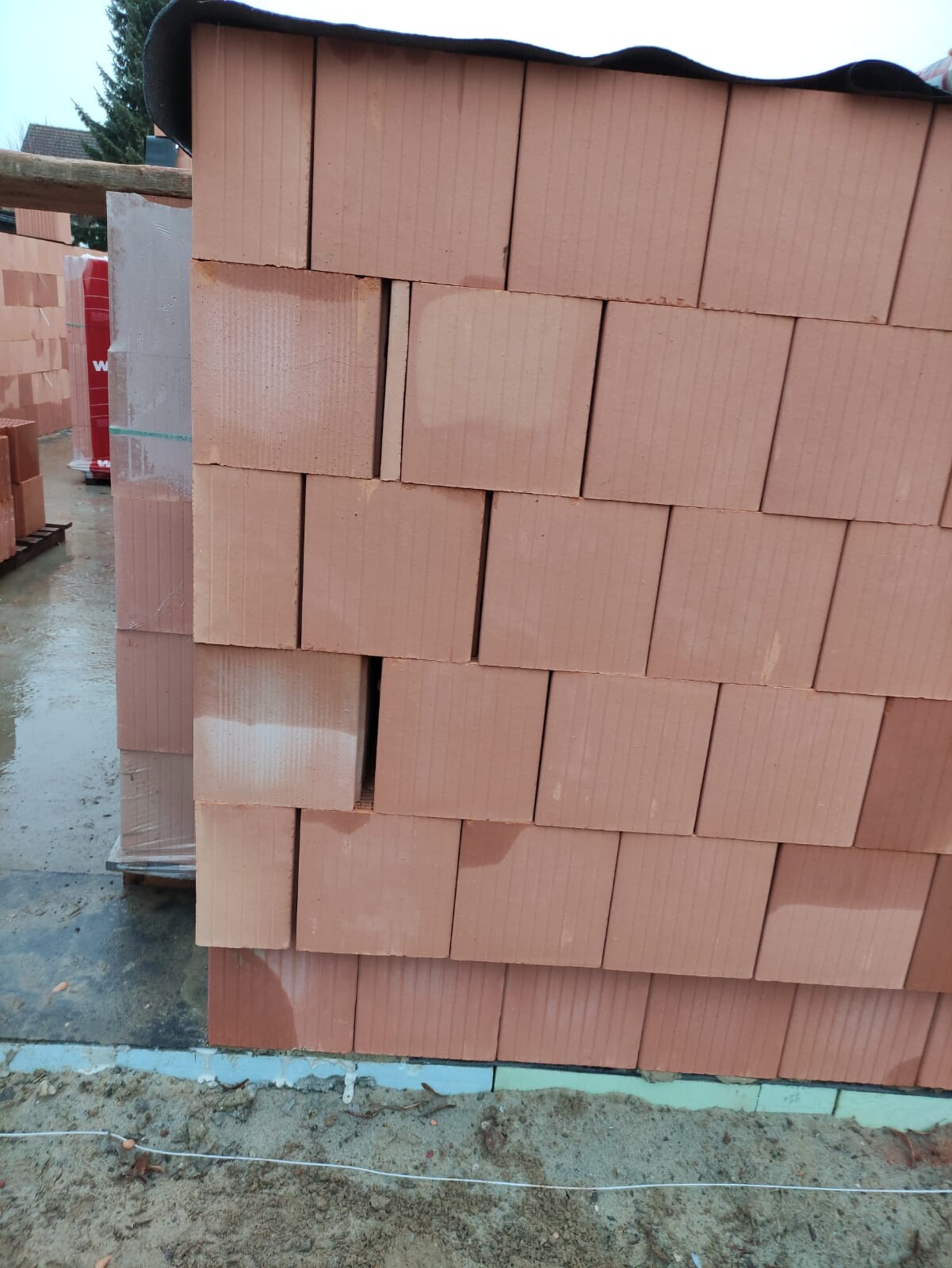

On the wall sections between the patio doors, you can clearly see how dimensions that do not exactly fit whole bricks (161.5cm (64 inches)) in every row lead to cut bricks. Even more surprising is that gaps were left in place. Not critical, but somewhat hastily "done," the gaps were not immediately filled with mortar either and will have to be "filled" later :-(
Tolentino4 Feb 2021 19:45
Yes, I suspect they want to finish building the ground floor walls before the cold snap, as the next payment installment would then be due. However, I think they miscalculated if the workmanship continues to be this sloppy.
How do you assess lintel #427?
