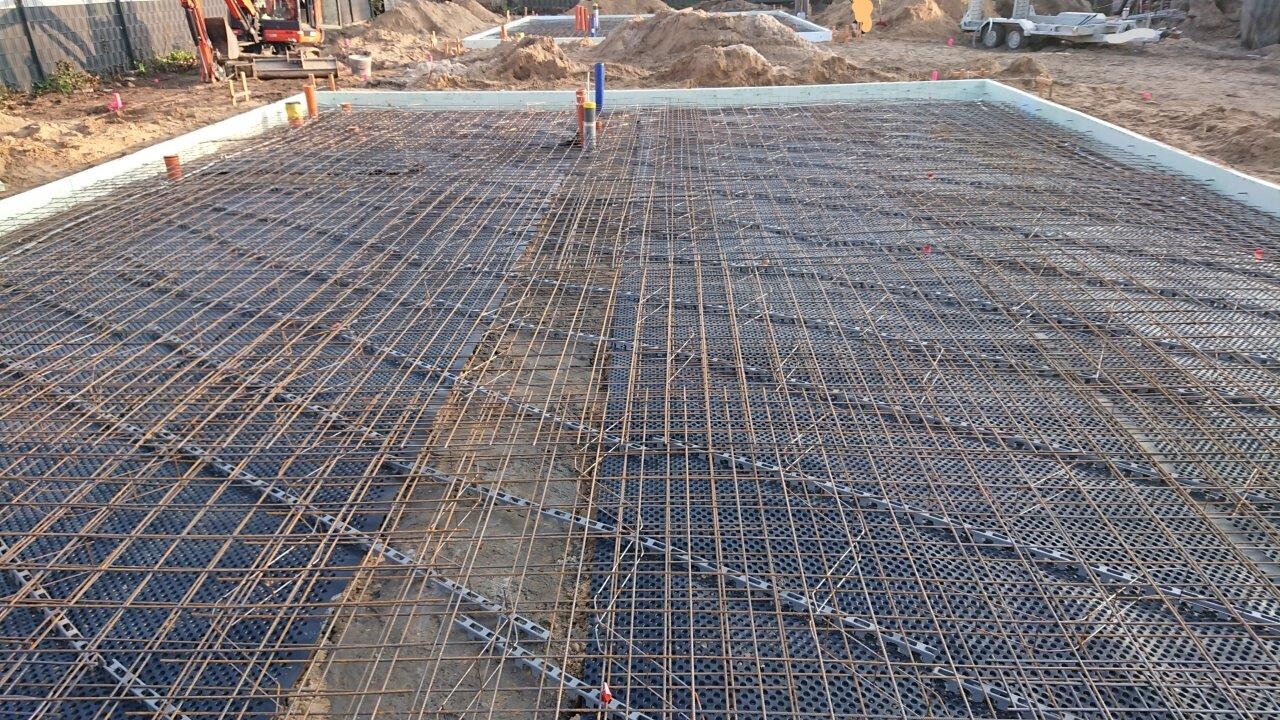

Not yet. I thought this could be done by laying the empty conduits up to the transfer point... And then I also have to do it with the set of four KG pipes. These are for electricity, communication, and the doorbell. So far, all the pipes only run laterally into the ground. There are no further pipes connected yet...

So, yesterday was the first appointment with the building inspector (an independent one who also inspected my condo 5.5 years ago and luckily was the only one still available for me). He didn’t really have any major complaints, but the report is still pending. However, he didn’t exactly praise the workmanship either. A bit of reinforcing steel is still missing on one side (it had run out), but the structural workers who were still on site had already mentioned this.
What’s interesting (to me) is that the formwork for the slab is being done together with the insulation. I had always seen the process done by installing wooden formwork first and then adding the perimeter insulation afterward.
The workers also mentioned that my general contractor always installs an additional 5cm (2 inches) of insulation afterward. Is that unusual?
All wall and pipe penetrations are in the correct places, and there should be sufficient coverage everywhere.
A few pipes are still too short and will be extended. One of their angle grinder discs broke yesterday, and they didn’t have a replacement yet.
