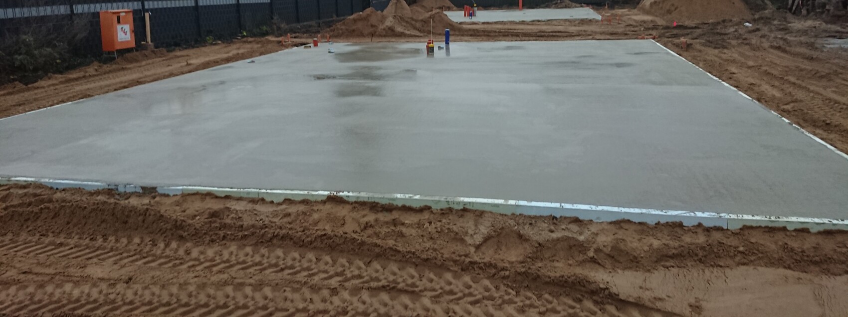

Are puddles actually a problem?The screed must have some purpose after all; I haven’t heard of floor tiles becoming loose because of it.https://www.instagram.com/11antgmxde/
The screed must be good for something; I've never heard of floor slabs being ready for finishing.Any Swedish or climate floor slab is ready for covering. We had that, it went smoothly.G
Grillhendl12 Dec 2020 09:5611ant schrieb:
Screed must be good for something; I haven't heard of floor panels that are ready for covering yet.Actually, there are such panels. These are the thermal floor panels that already have the underfloor heating integrated.
Grillhendl12 Dec 2020 09:57Oh, I saw too late that @opalau has already commented. It’s so confusing on the phone.
