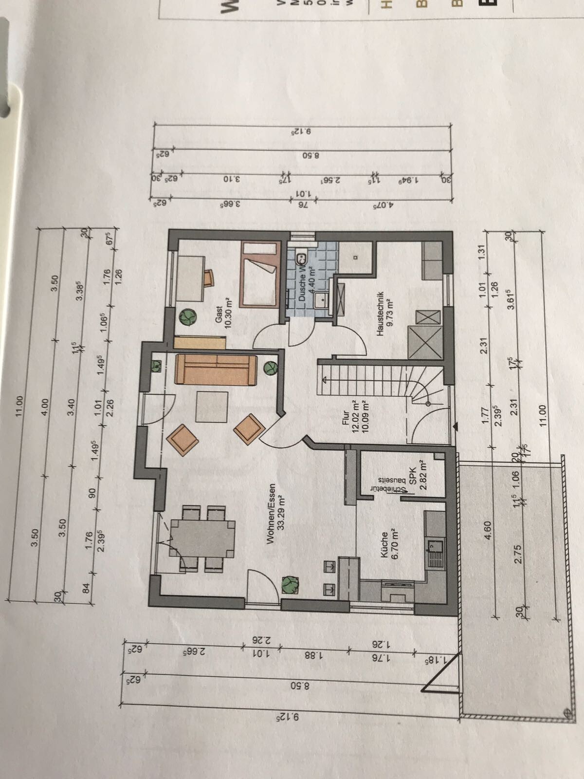

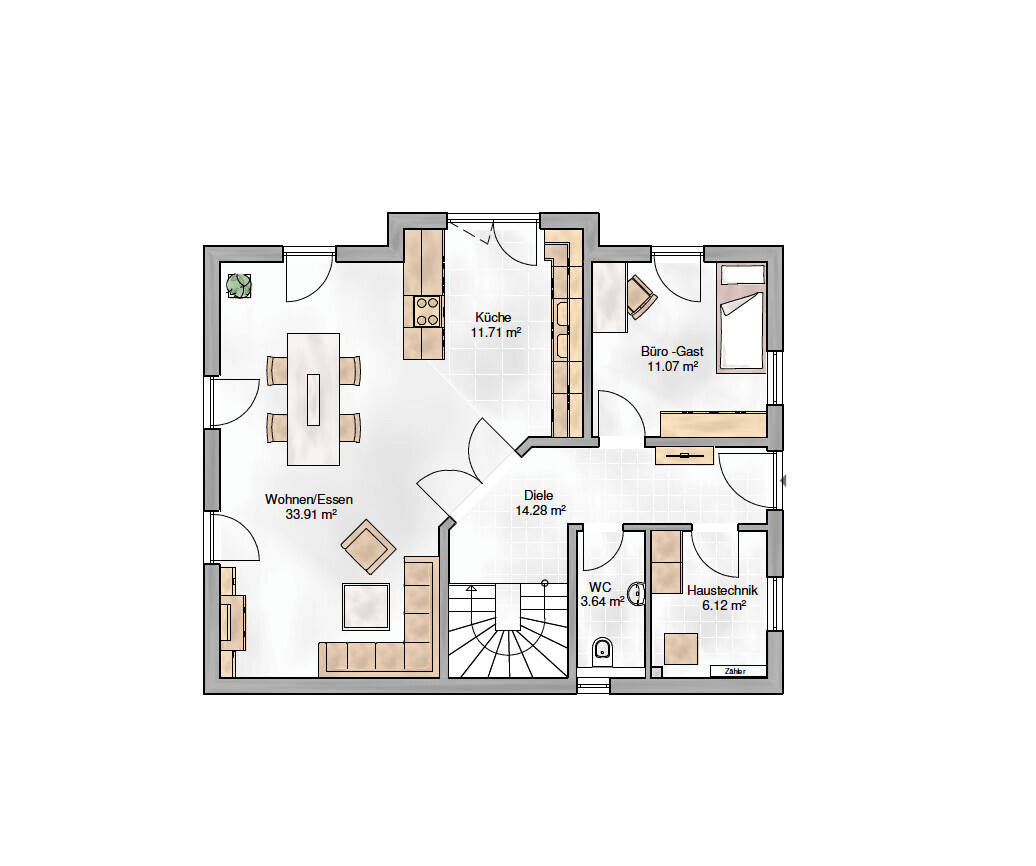

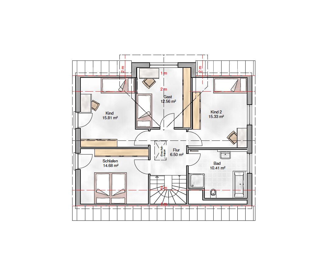

polydeikes18 Aug 2018 10:59I took the suggestion of having two floors and looked at floor plans of 145–160 m² (1560–1720 sq ft) designs from various providers’ websites (Scanhaus Marlow Marlow, Danhaus, Gussek, Danwood). At first, none of them immediately appealed to me or seemed to work. This is probably mainly because the ground floor area tends to be smaller, which makes it difficult to fit an office, utility room, and pantry.
Attached are the designs from the initial consultation. The kitchen is quite small due to the pantry. At the moment, this would probably not be an issue, but looking ahead?
It’s a typical general contractor floor plan.
I would definitely choose a house with a two-quarter turn staircase that is not located at the entrance.
Without slanted walls, a larger kitchen, access not through the living room, a pantry of 2-3 sqm (22-32 sq ft), and more space in the shower toilet, as well as knee wall height of at least 1.20 m (4 feet).
It’s worth considering whether the kitchen could be placed on the west side.
polydeikes18 Aug 2018 12:37On the property, the house proposal seems to meet these considerations so far, see the image.
From our perspective, it had the following disadvantages:
- Entrance far from the garage
- We couldn’t fit a pantry
- Shower bathroom downstairs is difficult
For us, it’s mainly the combination of a home office + pantry + shower bathroom downstairs that causes problems.

polydeikes schrieb:
What exactly is wrong with angled walls?Angled walls are basically a workaround when something doesn’t fit due to poor planning or lack of space. Also, I don’t like it when the sofa is immediately in view. There should be a bit more privacy planned in.
Personally, I prefer 90-degree corners in my house. Furniture can be placed at an angle if needed.
However, if you like it, go for it. After all, it’s supposed to please you 🙂
In the first example, the pantry is way too long, which is why the angled wall was introduced...
