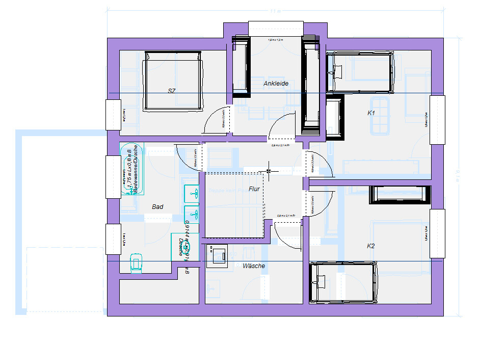

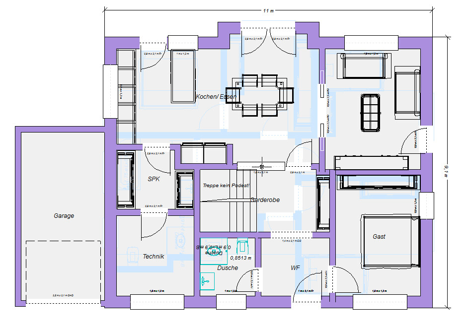

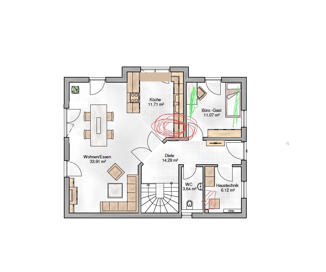

polydeikes18 Aug 2018 14:01I believe the lady of the house especially liked the French door in the original floor plan.
You certainly have much more experience. As a complete beginner, I don’t see any particular issue with the one slanted wall, for example.
The problem in the original floor plan is the pantry. It can basically only go where I have scribbled in red here. And that might come at the expense of the office, where I need at least one wall of 2.5m + (8 feet 2 inches) without a window.
Also, the shower still somehow needs to fit into the guest bathroom downstairs.
polydeikes schrieb:
I believe the lady of the house originally liked the French door in the floor plan.
The problem with the original layout is the pantry. It really can only be placed where I marked in red here. Possibly at the expense of the office, where I still need at least one wall of 2.5m (8 feet 2 inches) or more (without a window).
Also, the shower will somehow need to be fitted into the guest toilet downstairs.The original floor plan is in your first post.
If someone says it’s too long, then it must be there 😉
A French door can also be installed on a flat wall, but many say it’s impractical.
kaho674 schrieb:
On the other hand, it is of course much more expensive to build two full stories. To quote the Bremen Town Musicians: "we can find something better than a knee wall fiddled under 87cm (34 inches)".
What exactly is more expensive about straight vertical walls? And with a “setback story” (or “step-back floor”), you can still build a one-and-a-half-story house if the upper floor has less area than the lower one.
When looking for inspirational floor plans, keep in mind to scale down if you want to adapt an upper full story.
I don’t mind sloped walls, but somehow they feel a bit 90s to me.
What exactly is supposed to be more expensive about the vertically rising walls? – And with a "setback floor" (also known as a recessed upper floor), it is still possible to build a one-and-a-half-story house if you use less floor space on the top level than on the lower one.I might be mistaken, but I believe that a setback floor is significantly more expensive than a simple gable roof. After all, you immediately have several different roof surfaces that need to be designed, calculated, and constructed.kaho674 schrieb:
But I do think that a recessed top floor is significantly more expensive than a simple gable roof. After all, you immediately have several different roof surfaces, I agree. I just wanted to point out that straight-wall floors and floors that are not full upper floors do not exclude each other. I also see the ideal solution in a two-story house with the same floor area distribution for the upper floor as the ground floor, classic with congruent exterior walls. Of course, this means a smaller footprint compared to a one-and-a-half-story house.
kaho674 schrieb:
Double door possible. Your floor plan suggestion makes me smile – it looks a bit like a more refined version of the layout in https://www.hausbau-forum.de/threads/grundrissoptimierung-stadtvilla-180m2-mit-visualisierungen.28529/ – and compared to Polydeikes’ initial concept (considering his plot), I find yours a bit too conservative.
