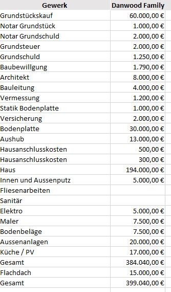

Hello to the forum. I’m new here, a complete construction novice, and I’m hoping for your help. We (aged 45 and 41) are currently considering whether or not to start a house building project. We could get a good building plot relatively cheaply, but based on my research so far, the budget of 450,000 (approximately, depending on currency) is quite limited. It’s not extremely tight, but we don’t really want to spend more than that. Our expectations are modest: a simple Danwood Family house with 110 m² (1,184 sq ft) and a list price of 245,000 should be the base. I’ve been researching for weeks, but now I really need help from people with relevant experience. Accordingly, I have put together a very rough cost estimate and would like to know how you assess it—whether it is at least somewhat realistic, or if we should better walk away from this project right away. The building site is in the rural area of Baden-Württemberg.
Übersicht Baukosten: Gewerke und Beträge (Danwood Family) in einer Tabelle.

That looks quite plausible. The architect might be cheaper, and the foundation slab as a self-managed task as well. Doesn’t Danwood handle the structural engineering for the slab? Danwood also does the plastering, right?
As I said, for electricity, telephone, and water I would estimate $8,000–12,000. You tend to get overcharged there.

That seems quite plausible.
That’s hardly plausible, as Danwood is a prefab house manufacturer that includes exterior plaster and structural costs in their pricing, and project management is also included.
SeppWeller schrieb:
Family house with 110 m2 (1,184 sq ft) and a list price of 245k should be the basis.
Honestly? I’m not familiar with the current scope of work. As far as I know, I’m not sure if you’re accounting for €0 on plumbing and €0 on tiling work.
If I quickly check the Danwood Family page, I can see that interior doors are not included in the house, but the plaster definitely is.
Therefore, I don’t understand your list at all.

The manufacturer doesn’t affect connection costs. You contact the local water and electricity suppliers and get the exact costs down to the cent.
SeppWeller schrieb:
What I’m really trying to do is, based on your experience, determine whether the budget is basically sufficient or if I’ve misinterpreted or forgotten anything important.
Well, you should definitely revise your figures. Some things are misunderstood. There’s a big difference between paying €800 or €8,000 for connections.
Kitchen and photovoltaics are two different things and each has its own costs.
Temporary construction power and water are missing.
We also don’t know if you plan to install the flooring yourself. Hiring a professional varies regionally in cost.
We have no information about the plot (difficult ground conditions, slope). Many costs depend heavily on the land.

Complete construction novices falling for a Danwood is almost a causal connection. This is a provider whose marketing examples successfully create the impression that the non-inclusive items in the price quotes are just a hop away, making building affordable after all. Better take a look at models from providers who are less economy-oriented—that puts things into perspective. Viebrockhaus, for example, offers a wide range of catalogue models with regionally differentiated price lists. 245k divided by 3k results in just over 80 m² (860 sq ft)—quite sufficient for two people. The final ready-to-move-in price will only be noticeably lower if your expectations are extremely modest (shower with hand shower and low-entry bath, single garage doors as ribbed up-and-over doors operated manually, patio French doors, 30x30 cm (12x12 inch) floor tiles, ...).
