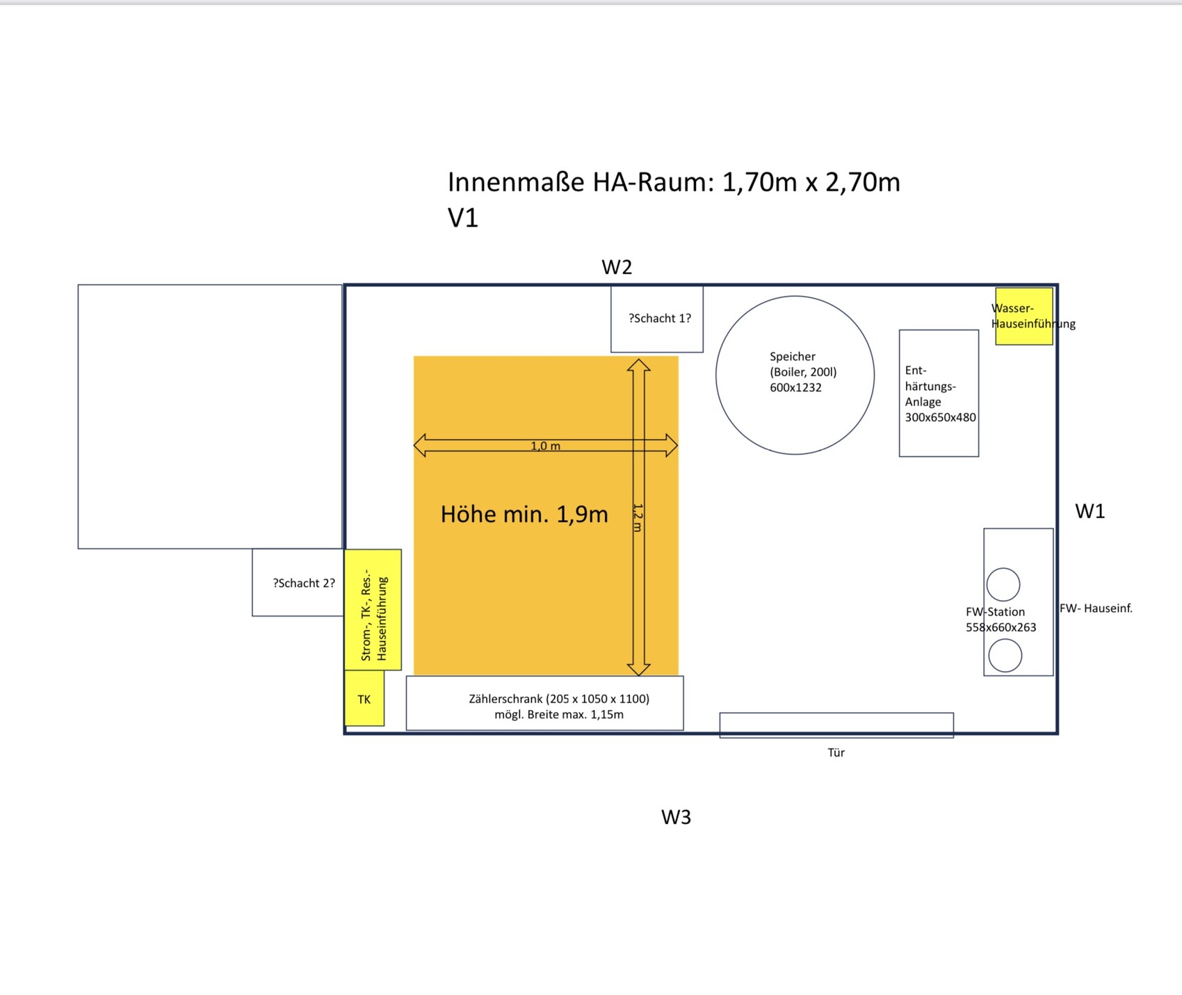

Unfortunately, I don’t have a basement and only planned an interior utility room. We’re about to start building and I’m currently getting quotes from several heating installers.
Do you think it’s reasonable to expect the companies to work with the size of my utility room? It will be about 1.7 m x 2.7 m (5.6 ft x 8.9 ft). It needs to accommodate the electrical panel, water meter, water softener, a 200 L (53 gallon) water tank, and a district heating transfer station.
I’m going to bring this up with the companies right away, but I wanted to get a sense of how confidently I can defend the room’s size. I’m sure the heating installers will immediately start looking for additional spaces where they can expand.
The box in the upper left of the image (not marked) is the area under the stairs. There’s no standing height there anymore. The door opens outward.
