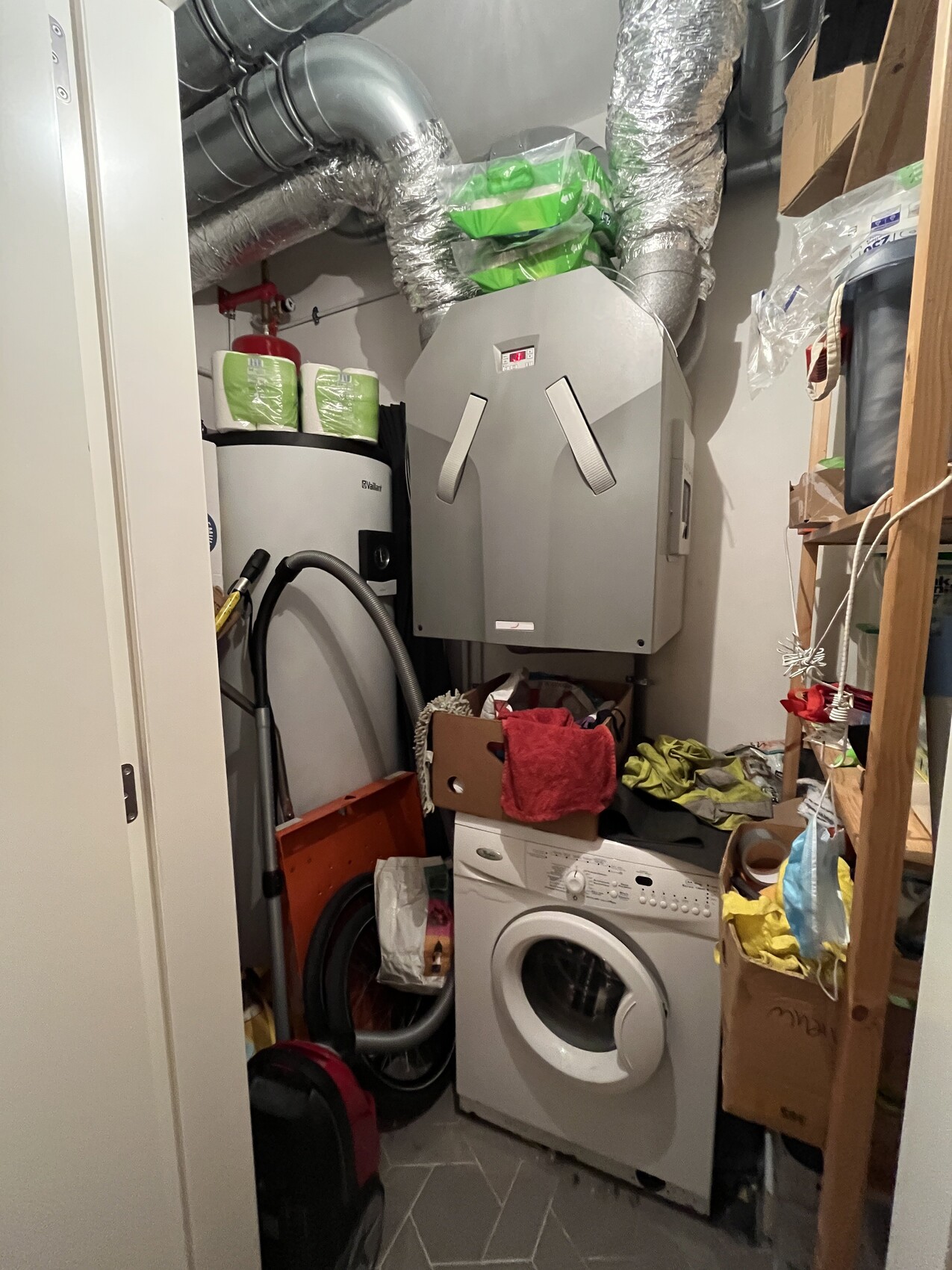

The equipment room for the major equipment is a bit over 3 sqm (32 sq ft), an interior room without windows. It contains the hot water tank, controlled ventilation system, heat pump connection, and rainwater filter for the washing machine. The washing machine is also inside this 3 sqm room, along with an Ivar storage shelf.
Overall, I find this setup quite space-efficient, especially when you consider all the extra construction often required around the equipment in Germany. I am happy with my maximally efficient solution. Also, the utility room is located on the least attractive side of the house, so it doesn’t take up any nice space. That’s also practical.

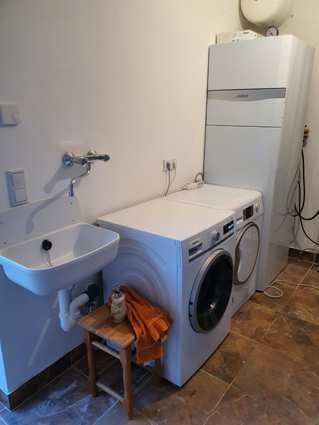

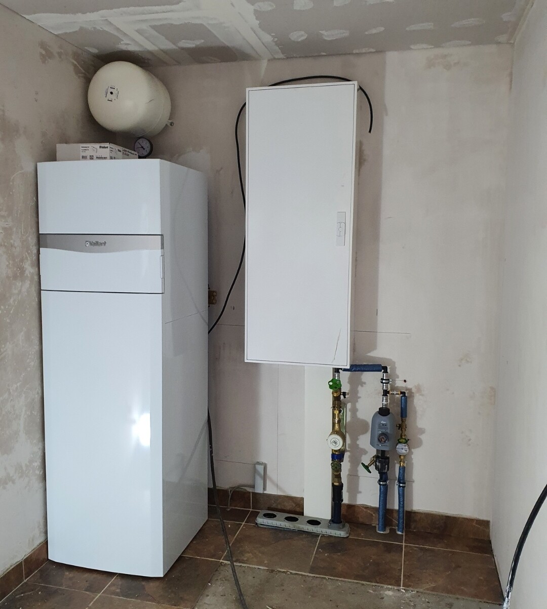

It can also be space-saving in Germany. Water, electricity, heating—all on one wall.
Washer and dryer in front of the heater.
But that really requires communicating with the tradespeople and being present during installation.
