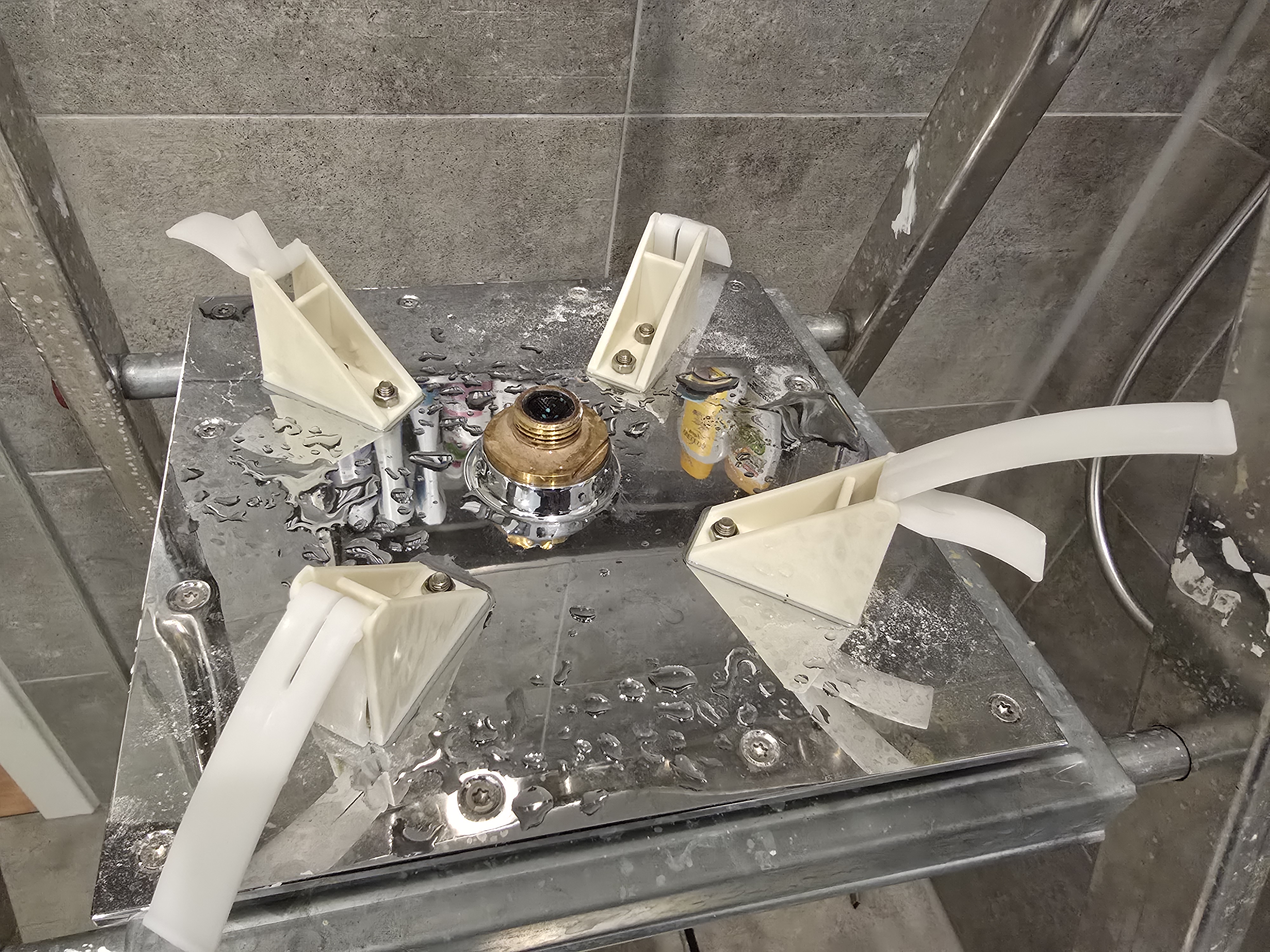

It looks like the showerhead was attached to the suspended ceiling using spring clips (if that’s the right term):
One of these clips broke, which is why the showerhead was no longer secured in the ceiling and came loose. Unfortunately, Grohe doesn’t seem to offer replacement parts for this... Anyway, this type of mounting doesn’t seem very reliable to me if the material fatigues and breaks over time.

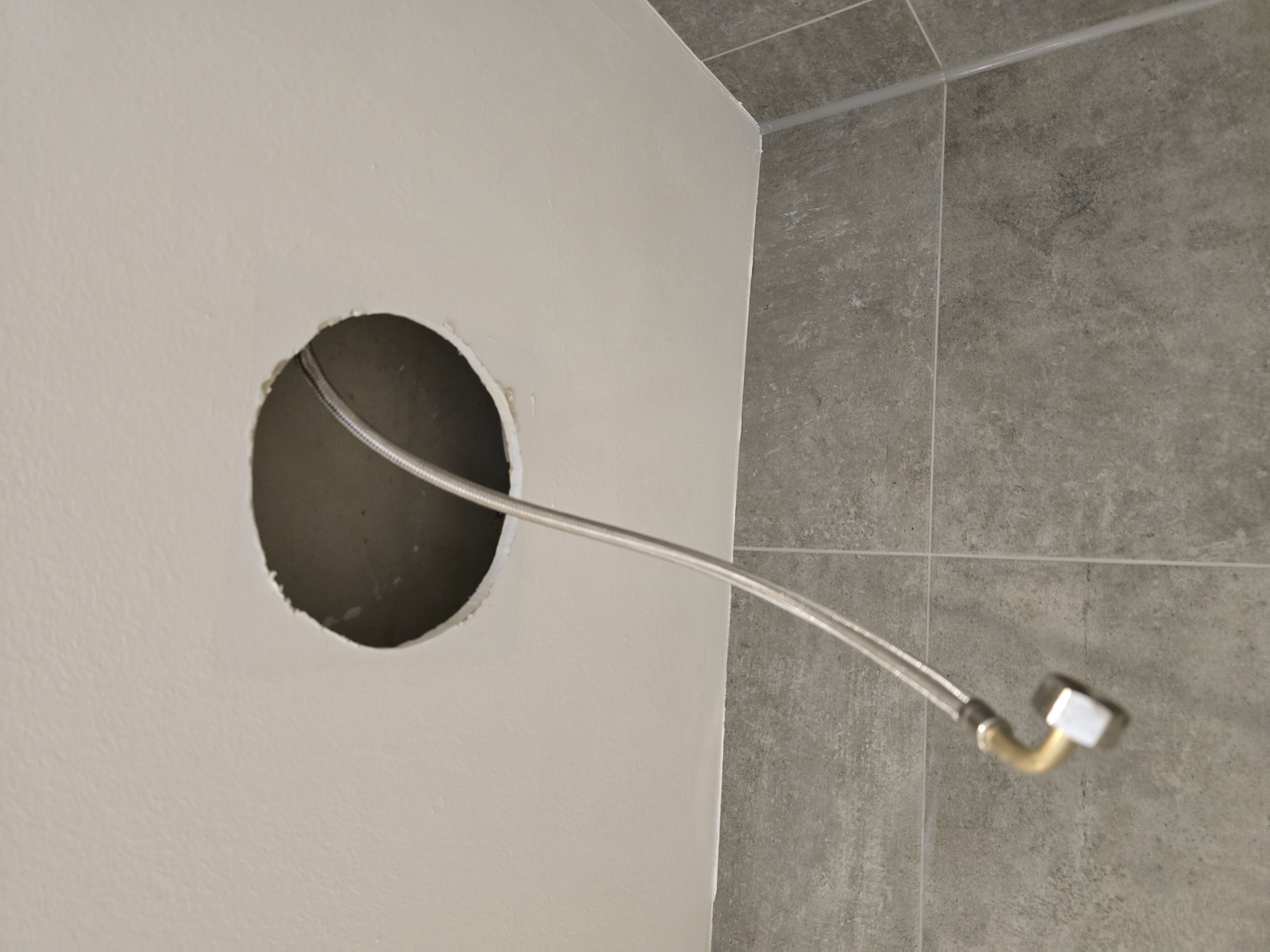

I would really appreciate any advice on how I, as a non-professional, can securely and neatly fix the showerhead back into the designated opening in the suspended ceiling (diameter 22cm (9 inches)). There is about 9cm (3.5 inches) of space between the suspended ceiling and the structural ceiling.
Here’s a photo of the opening in the suspended ceiling:
I’d be very grateful for any suggestions on the best way to handle this DIY fix.

this is a typical case of "it lasted for years, so it must be fine," until it suddenly isn't. These spring clips are borderline for the weight of the rain shower; 230mm (9 inches) plus the water inside quickly add up to over 4kg (9 lbs), and that’s constantly hanging from a suspended ceiling. Honestly, I’m not surprised by the material fatigue. It’s also no surprise that Grohe doesn’t supply individual parts for this—they just assume the system will never fail. For a non-professional, I would suggest less jury-rigging and more proper load transfer, for example, a mounting plate above the drywall ceiling, screwed to the substructure, with the shower head then installed flush again. Gluing or fiddling with new clips might hold up for two weeks but will be frustrating later. Have you checked whether there is still space above the opening all the way to the structural ceiling, or is the part sitting very close? The 220mm (9 inches) opening is definitely not a problem—in fact, it’s more of an advantage. And yes, the original solution was rather mediocre, even if it says Grohe on it.

Thanks for the feedback! So, above the opening, I still have about 9cm (3.5 inches) of space up to the raw ceiling. Your point about the mounting plate sounds very interesting – did you have a specific material or component in mind that I could take a closer look at or get right away? Thanks a lot for your help!
