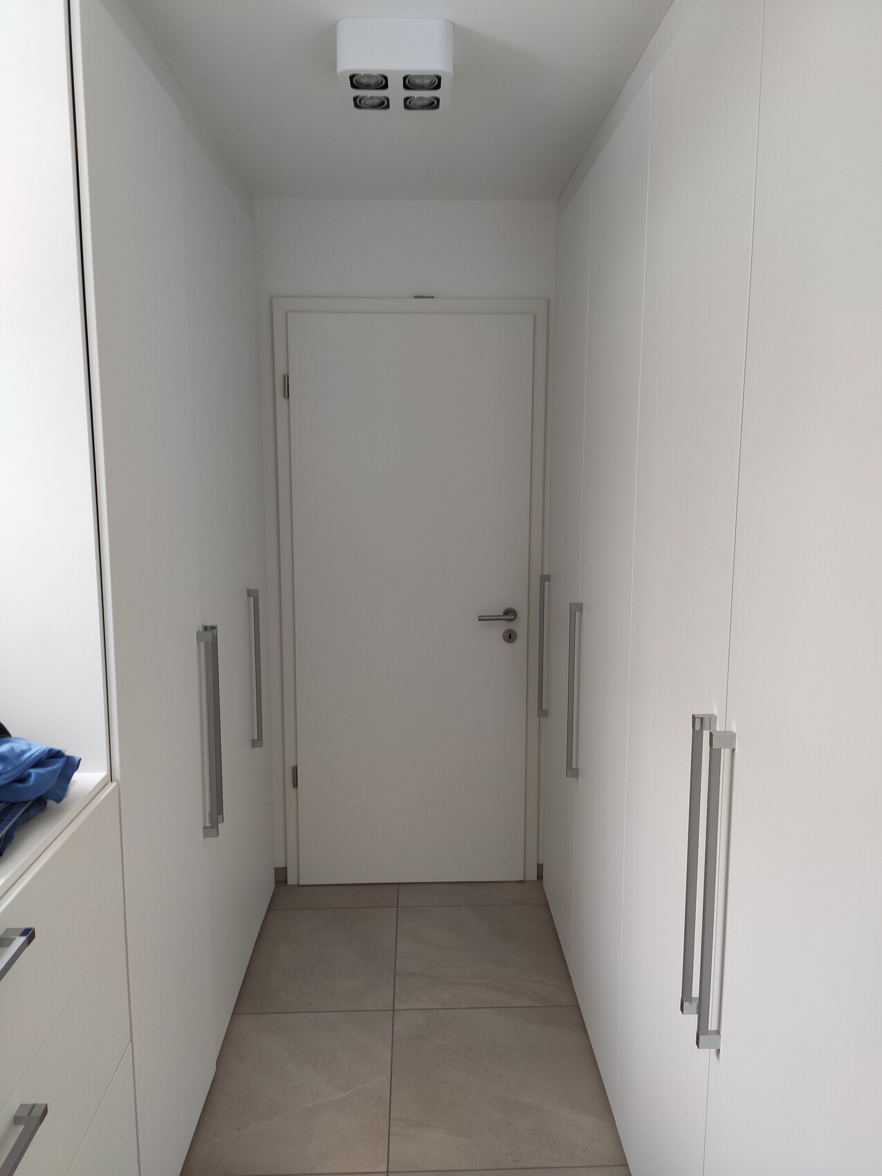

What finished room width have you planned for the walk-in closet? I would guess around 1.60 m (5 ft 3 in), but you still need to account for wall thicknesses.
We have about 2.10 m (6 ft 11 in), with a full-height wardrobe for hanging clothes on one side, and a shallow closet around 45 cm (18 in) deep on the other side.
An extra 20 cm (8 in) would have made a big difference.
In your case, it won’t just be tight—it will be almost impossible... 😉
majuhenema7 Jan 2021 13:33Thank you for your detailed explanation and especially for the photo that helps illustrate your point.
My wife and I are meeting tonight in our home planning office for a crisis meeting. 😉
