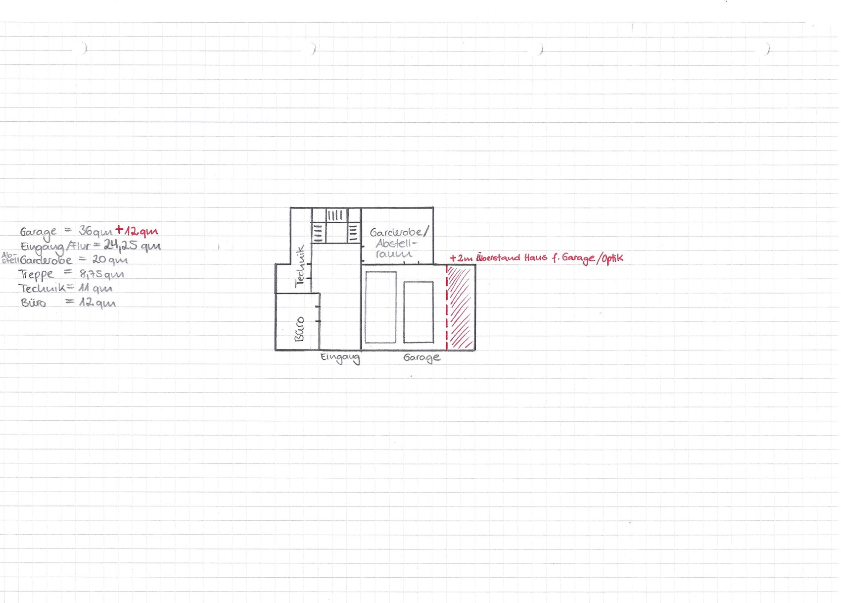

ᐅ Initial floor plan draft on graph paper: hillside, basement, plus two stories.
Created on: 2 Jan 2021 13:09
majuhenema
Disclaimer:

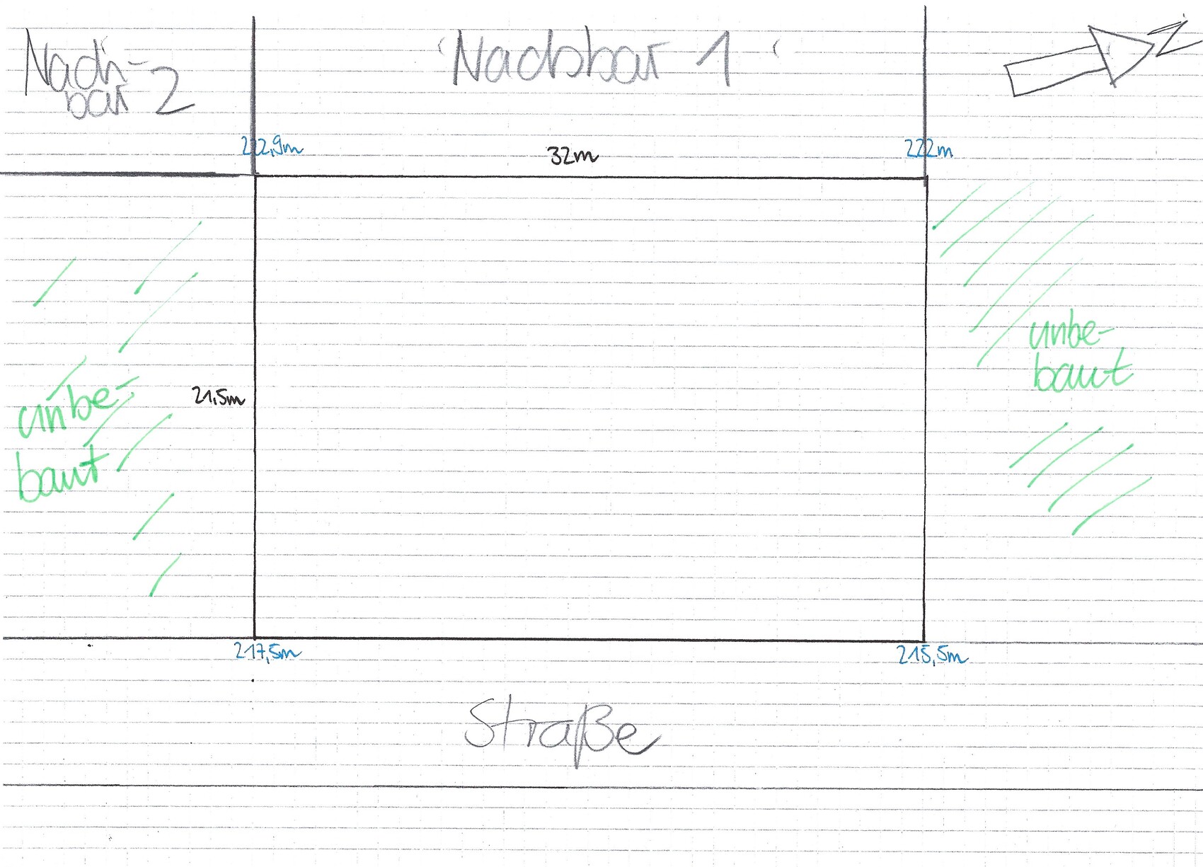

After a long search, we have finally found a plot of land. It is not easy to build on because of a steep slope, but it also has a unique appeal since the north and south sides are undeveloped and should remain so at least in the medium term (both adjacent plots belong to the neighbors uphill). Additionally, we have views of the river and the vineyards beyond to the north, east, and southeast. Therefore, we plan to build two floors above the basement, to reach higher elevation and to have ground-level access to the garden from the first floor.
The shown design is our “dream concept.” We noted our spatial ideas and wishes and sketched them on graph paper. Each square corresponds to 1 meter (3 feet). Our budget excluding the land and landscaping is set at 500,000 euros.
Zoning and Restrictions
Plot size: 682 sqm (approximately 7,338 sq ft)
Slope: Yes, about 6 m (20 feet) downhill from west to east
Gap in an old residential area, no formal zoning plan available, similar houses already built
Style, roof type, building category: open, modern, clearly structured, roof form depending on practicality (height, appearance, photovoltaic panels)
Basement, floors: Basement/entrance level + 2 upper floors
Number of occupants: 2 adults, both 31 years old, no children yet, 2 children’s rooms planned
Space requirements:
Basement: entrance area, office, garage, storage room, technical room
1st floor: living room, dining area, kitchen, utility room, guest toilet, pantry
2nd floor: 2 children’s bedrooms, children’s bathroom, master bathroom, master bedroom, walk-in closet
Occasional guest sleeping: 4 per year (sofa bed in office or utility room)
Conservative or modern building style: modern
Open kitchen with island: open, large + island
Seating capacity for dining table: large table (2.40 m x 1 m (8 ft x 3 ft)), seats 6–8 people
Fireplace: optional (not planned due to cost-benefit consideration)
Music/stereo wall: turntable in living/dining area
Balcony, roof terrace: balcony on the east side on the 2nd floor would be great for the location and views
Garage, carport: double garage in the basement, 2 parking spaces in front
Additional wishes/special features/daily routine:
The north and south sides of the plot will remain undeveloped in the short and medium term. To the east is a quiet street (cul-de-sac, with 3 houses beyond us). From north through east to south, there is a river view, so we would like to have access to at least a narrow balcony on the 1st and 2nd floors in those directions. The garden is planned on the south side of the property.
The cooking, dining, and living areas should be as spacious and bright as possible. The other rooms should be practical.
Who designed it: clients themselves – do-it-yourself
What do you like most? And why?
Clear layout, large living area, children’s bathroom included
What do you dislike? And why?
Staircase preference is a half-landing staircase, but it would be too large for the current plan
Price estimation?
Personal price limit for the house including fixtures and fittings: 500,000 euros excluding landscaping, preferably through a general contractor
If you have to compromise, on which details or features
-can you give up:
fireplace, possibly the balcony on the 2nd floor (reluctantly), smaller living/dining area
-can you not give up:
children’s bathroom, open and spacious design, office, utility room
Why has the design developed the way it is?
The design is based on the spatial concept and orientation on the plot. The house should be placed as far northeast as possible to maximize garden space on the south and west sides.
Note: The basement’s red-shaded area is planned so the house does not appear like a tower. The basement is designed to be wider for aesthetic reasons. Additionally, the basement ceiling is planned to project about 2 m (6.5 ft) to create a canopy and serve as a terrace for the 1st floor.
What is the most important/fundamental question about the floor plan, summarized in 130 characters?
1. Is the floor plan suitable as a planning basis for builders/architects?
2. What works well/less well/not at all?

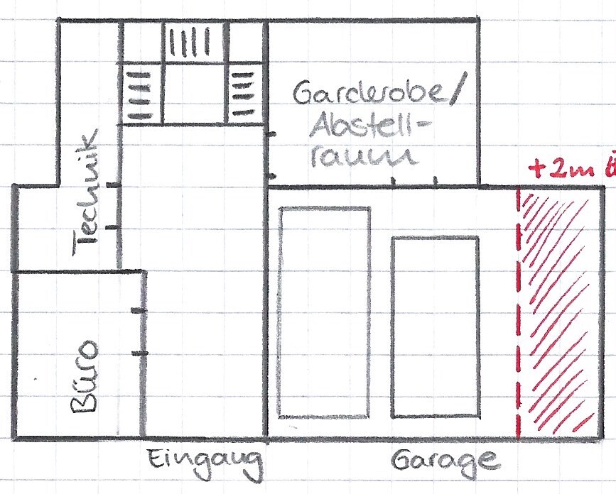

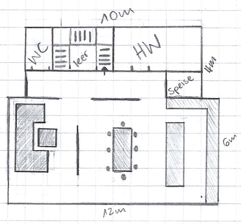

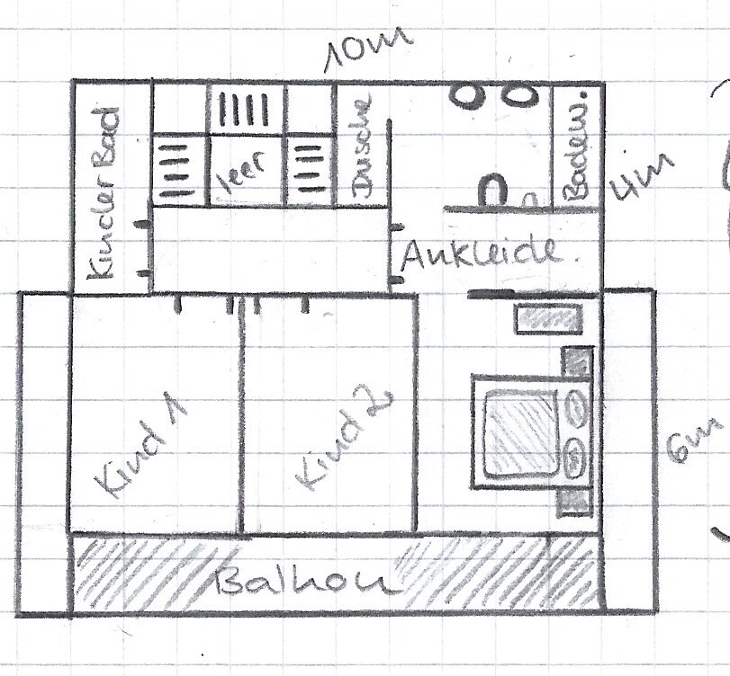

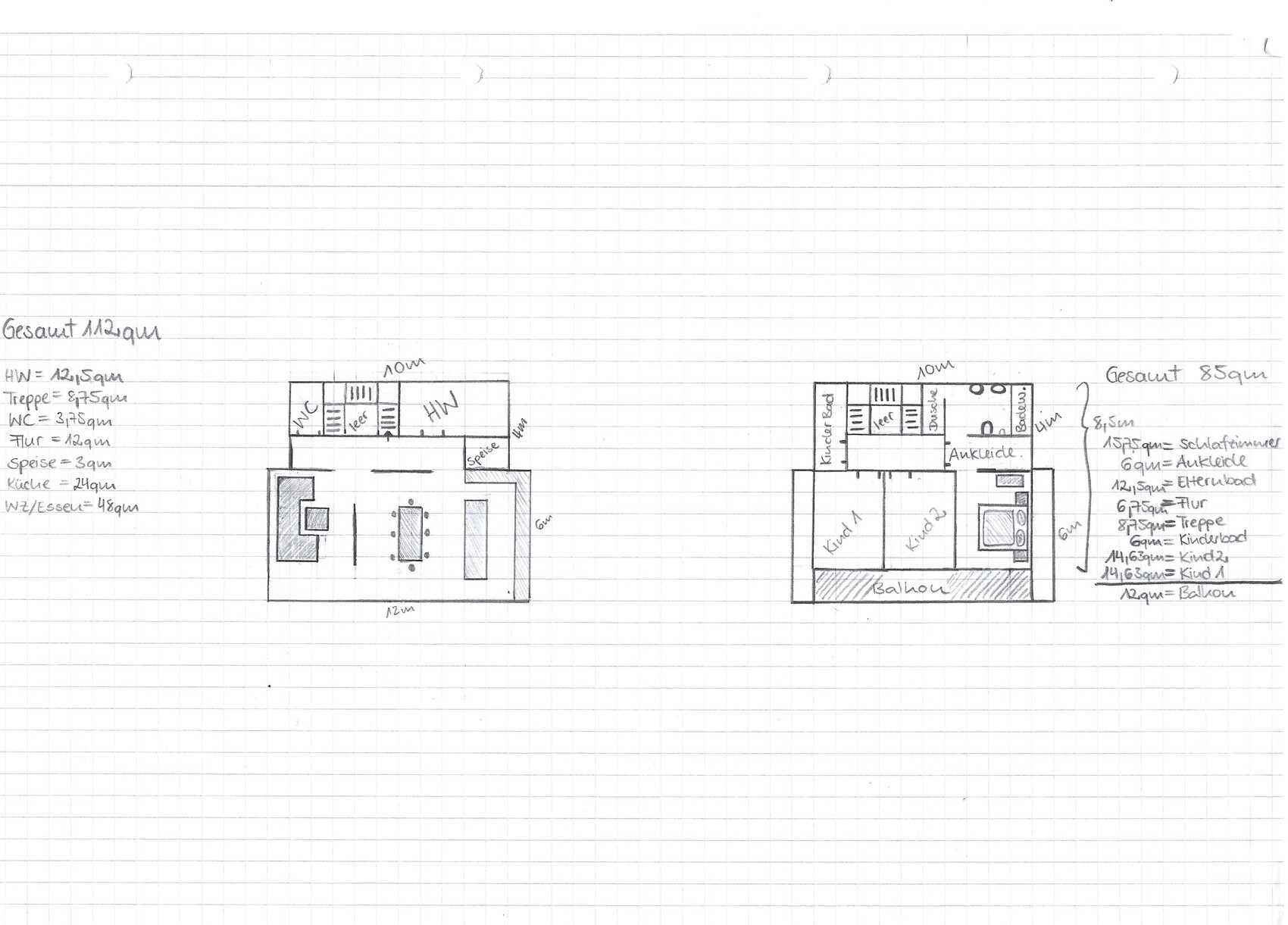

majuhenema schrieb:
Regarding the formats, I want to say that we are (still) not familiar with them and did not choose the sizes according to "standard" formats. For an architect, this is absolutely sufficient to understand where you want to place the windows. In reality, a 40 x 30 cm (16 x 12 inches) window, roughly the size of an A3 sheet, would of course only have a symbolic glass area.
majuhenema6 Jan 2021 23:24haydee schrieb:
You seem to love nature. That’s how I interpret your comment about the country lane.
I often work on the terrace. Both apply to me (as well).
haydee schrieb:
Paint the pantry, you still have a large basement. Staircase more towards the north. Kitchen where the current WC/stairs are. The herb garden would then be right outside the door. I’ll sketch that out for myself tomorrow! Thanks for the suggestion.
For an architect, that’s absolutely enough to imagine where you want to place the windows. In reality, a 40 x 30 cm (16 x 12 inches) window—roughly the size of an A3 sheet—would only leave a symbolic glass area. Great, thanks for your feedback. The goal was to make it clear that we want large windows in the important/appropriate places, and where just some light or ventilation is needed, small windows are perfectly sufficient.
majuhenema schrieb:
The goal was to make it clear that we want large windows in the important/meaningful areas, and where just some light is enough and the windows are mainly for ventilation, smaller ones are completely sufficient.That has become almost caricature-like clear ;-)https://www.instagram.com/11antgmxde/
hampshire6 Jan 2021 23:44haydee schrieb:
We live outside for several months each year.We designed the house so that you don’t really notice the difference between inside and outside over those months; they flow seamlessly into each other.If you want to terrace the slope and need retaining walls, be prepared to significantly increase your budget. I would estimate a total cost of around €700,000 (approximately $740,000).
An architect will be able to make good use of your preliminary ideas. Describe your thoughts in words and images. You don’t need to be very precise; rather, the architect needs to get to know your vision and preferences.
majuhenema6 Jan 2021 23:47I liked your post, but I want to clearly exclude your cost estimate from that. 😉
hampshire7 Jan 2021 00:15majuhenema schrieb:
I want to clearly exclude your cost estimate from this.Sorry about that. If the costs come out lower, that’s fine. It’s essential to include a buffer, so don’t push your budget limits. We built on a slope ourselves. It went really well and turned out great. For the costs, we needed some flexibility and fortunately had it. For example, differences in soil classifications had a noticeable impact on the calculations.Similar topics
