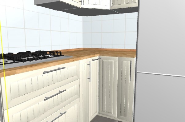

Straubi_Kob17 Jun 2014 11:57Thanks in advance.
Yes, it’s difficult to explain, so here is a picture.
Explanation:
- To the right of the cooktop (middle cooking zone, 40cm (15.7 inches)) I have 150cm (59 inches) (fixed due to the range hood).
- To the left, 180cm (71 inches) up to the door. (Of that I need at least 60cm (24 inches) or 70cm (28 inches) for the refrigerator.)
The rectangular lower corner cabinets don’t fit, there is too little space.
With the 88cm (35 inches) corner cabinet, I still have 20cm (8 inches) space on each side for a pull-out cabinet.
With a 66cm (26 inches) corner cabinet, the cabinet would be smaller. I could place a 40cm (16 inches) cabinet on each side.
Explanation:

IKEA-Experte17 Jun 2014 15:21The wall cabinet won’t give you more space. You would need to install it about 25cm (10 inches) away from the wall. This means it takes up more room than the corner base cabinet. Additionally, a custom-made countertop is required to cover the "angled corner."
In the picture, is the refrigerator on the right?
Please upload the complete plan with the floor layout.
- Left side: 180cm (71 inches) up to the door. (I need at least 60cm (24 inches) or 70cm (28 inches) of that for the refrigerator)
