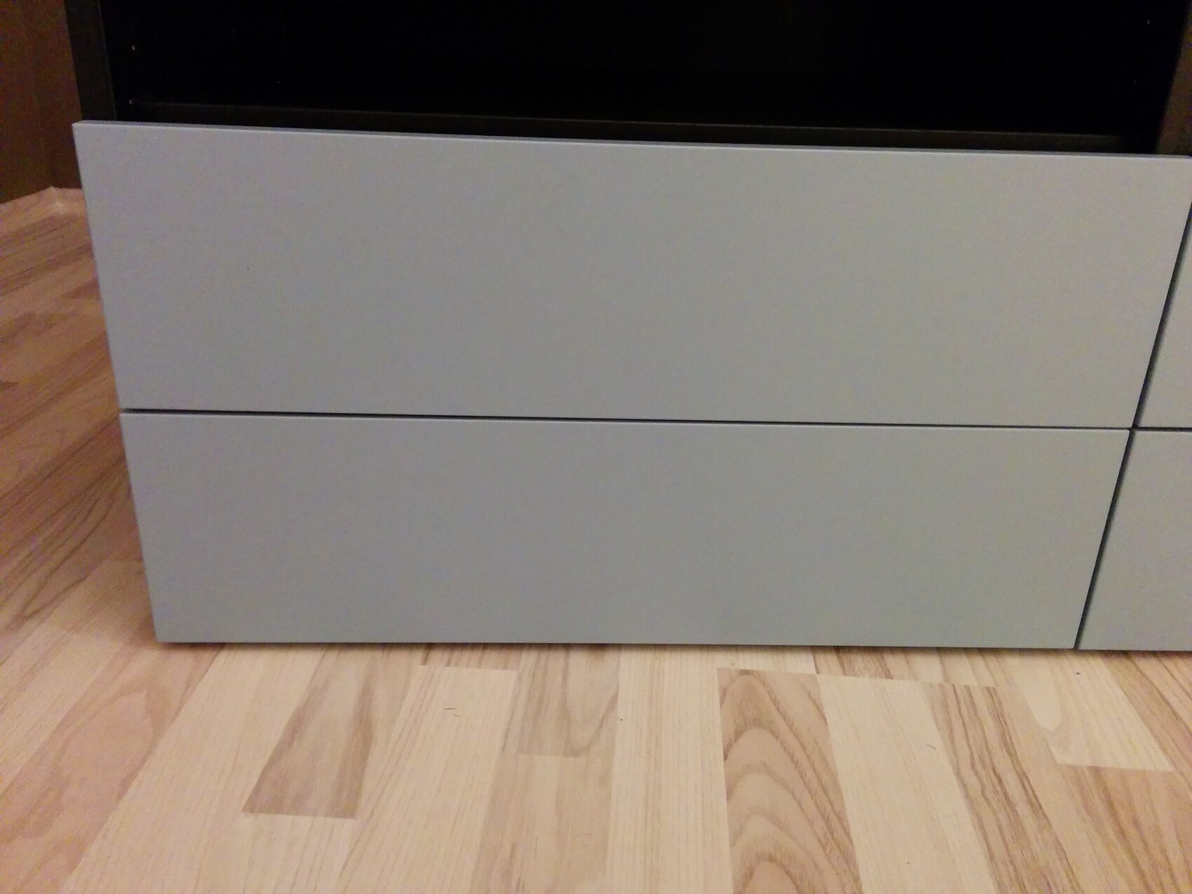

we are currently assembling our new Besta shelves – so far everything looks fine. For the Besta wall-mounted cabinet (120x40x64cm (47x16x25 inches)), we bought the Inreda full-extension drawers. After installing all the drawers, we noticed that they are all a bit uneven:
I think the pictures clearly show that there is a gap between the drawers which is definitely larger on one side than the other.
According to the spirit level, everything is straight – but this clearly is not level, right? Do you know where else we can adjust things to improve the alignment? The screws on the drawer slides are tightened properly, and the drawers are correctly mounted on them.

IKEA-Experte28 Jan 2015 13:56Hello,
at the front pin, onto which the drawer box is pressed, there is a knurled nut that can be used to adjust the height.
dr_zoidberg31 Jan 2015 21:51It worked great, thank you very much!
