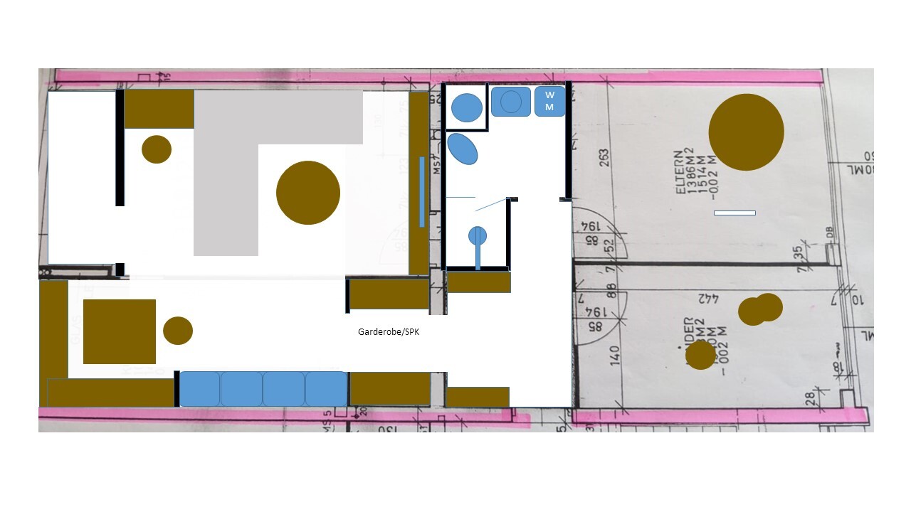

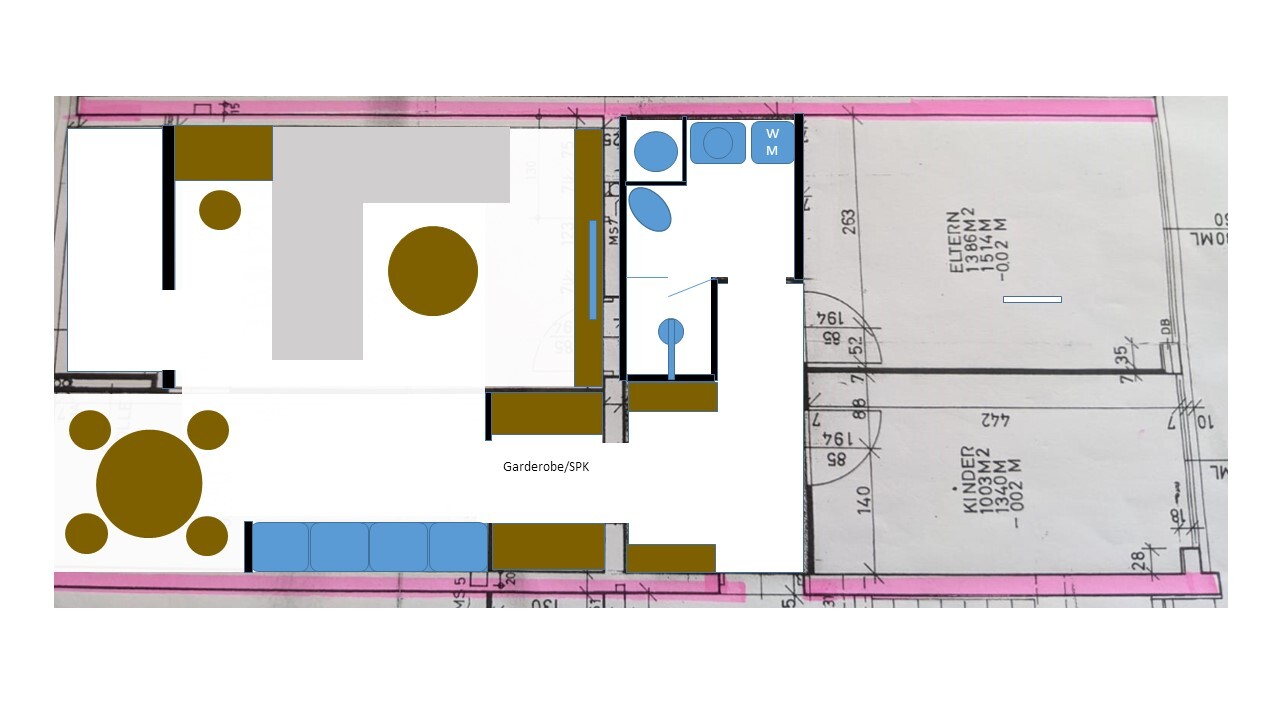

Would this work here?
The dining table is 120cm (47 inches) in diameter.

With a 120cm (47 inch) diameter table, no one can get out of the corner anymore.
What requirements do you have for the kitchen?
Refrigerator, dishwasher, sink, 60cm (24 inch) cooktop with oven below?

Would there be more space with a corner bench?
Grundriss eines Innenraums mit braunen Sitzflächen, blauen Bänken, Garderobe/SPK und pinkem Rahmen.
