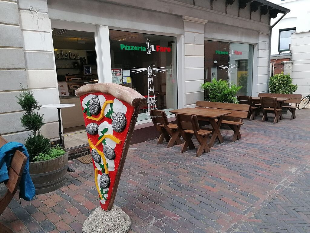

Bertram10013 Nov 2021 11:31Depending on the style of the house, I would probably choose facing bricks. They are simply laid in a sand bed and still look good even if they become uneven after a few years (like with wooden flooring, use only enhances the appearance). This method is used for paving streets in northern Germany and has proven to be effective.

Bertram10013 Nov 2021 12:01Personally, I would probably only install driving lanes. That way, you have green space around them, which I find nice. However, it does require more work.
I couldn’t find a good photo quickly, but here you can see a bit of what it might look like. There are narrow and wide stones in all colors. They are frost-resistant and quite affordable.
