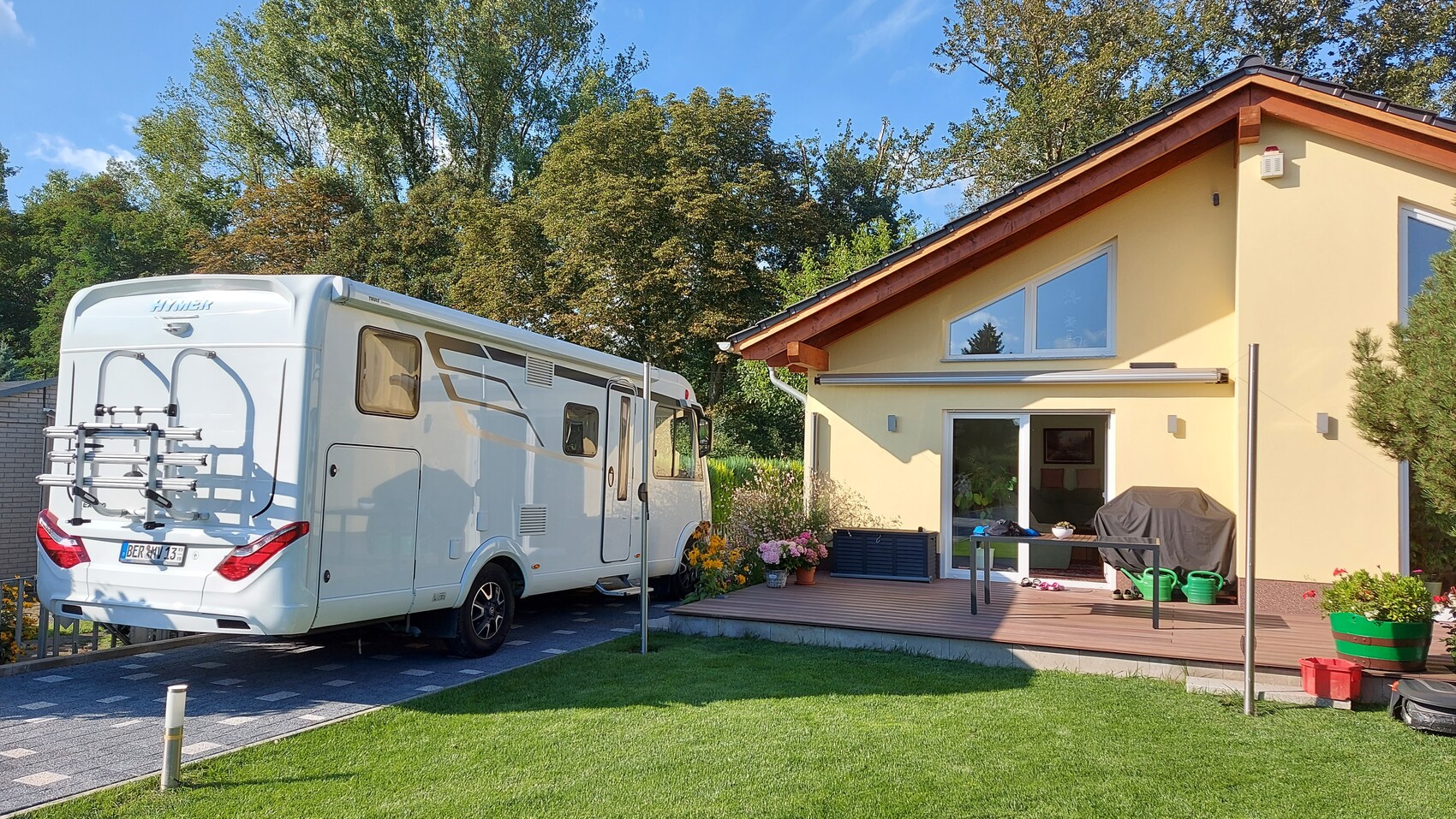

Nida35a14 Nov 2021 09:13
Exactly for that reason, exceptions also have their justification, for example, being able to load and unload the rental motorhome over the terrace with a short path and clean feet. That would then also be a reason for a 3-4 ton (3.3-4.4 US tons) driveway.
White motorhome stands next to yellow single-family house on wooden terrace; garden with flowers, barbecue.
