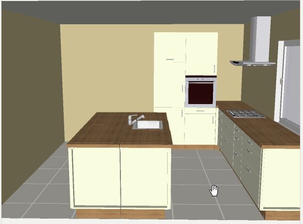

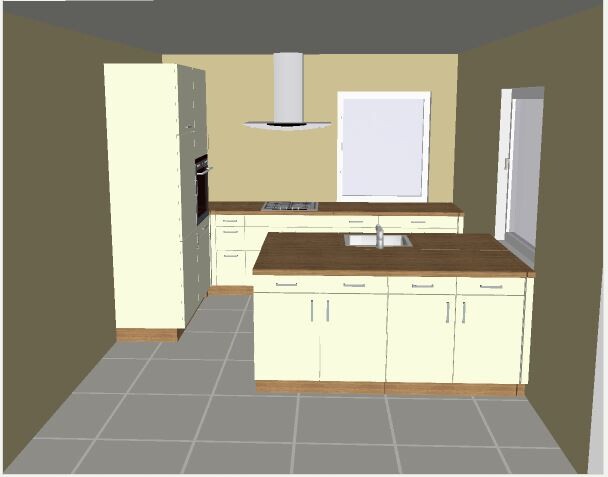

Jaydee5 Jul 2013 09:52

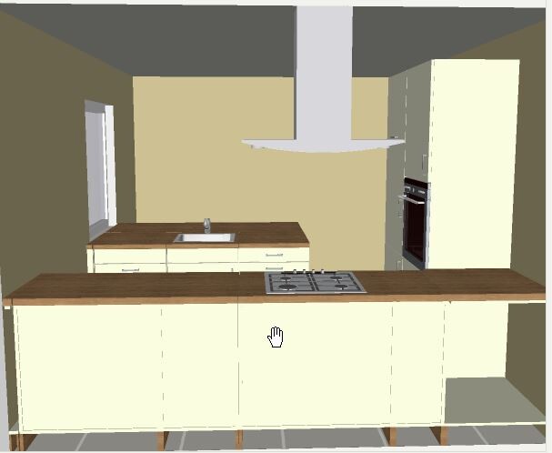

Kitchen with island, light-colored cabinets, stove with extractor hood, sink, and window.
Kitchen: island with wooden countertop, gas cooktop, extractor hood, sink on the left, oven on the right, light cabinets.
Kitchen with island, sink, oven, stove, extractor hood, cream-colored cabinets, gray tiles.
5 Jul 2013 10:14
@Jaydee, I think the access to the kitchen might be too narrow. But I like the idea of the side window; it’s well designed, even if you have to climb onto the countertop to clean it (I’m doing that myself at the moment, and it’s not as bad as it seems).
Jaydee5 Jul 2013 10:30
Yes, the passage will be tight, you are right. The distance between the row in front of the window and the island is currently 1 meter (3 feet 3 inches). It could be increased to 1.20 meters (4 feet).
An L-shape will be difficult because the side where the storage room is located is too short. A galley kitchen (two rows facing each other) is also challenging because the distance between the rows would then be too large.
This was just a quick preliminary plan.
Jaydee5 Jul 2013 10:49
Wow, this is really challenging. If you include the pantry, it becomes a very large room. OK, you can fit a lot of furniture in there, but it might end up feeling too big.

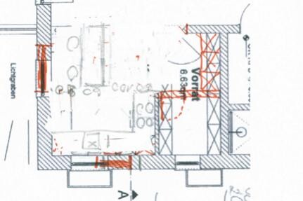

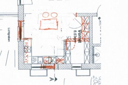

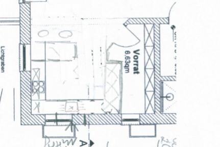

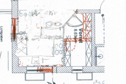

So, I quickly tried a few things, and this is what I ended up with:
Darn, how do I insert PDFs here???? Does anyone know?
5 Jul 2013 15:23
1. Design... Pantry reduced in size, allowing 180cm (71 inches) width for tall cabinets... unfortunately, the refrigerator is then too far from the preparation area.
2. Design... Cooking workspace moved, counter turned... refrigerator still too far away.
3. Design: Pantry narrowed, creating space for built-in tall cabinets... wall cabinets can be placed on both sides of the stove/vent hood for spices and such.
4. Design: Back to the original layout (pantry as planned)... tall cabinets along the exterior wall, counter next to the pantry wall.
I personally prefer design 3, but I would favor a straight wall in the pantry... the side window slightly shifted toward the center, sink centered under the front window, both aligned within the 3.15m (10.3 ft) width.
Maybe there is an idea here that you can use for your own planning. Some feedback on your decisions would be appreciated.
