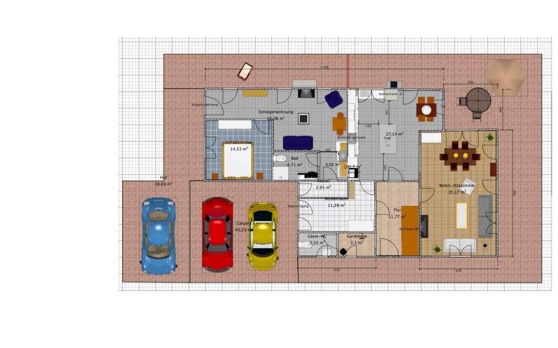

Hello Cybernd,
I’m currently in the same situation. We want to build a house with about 200 sqm (2,150 sq ft) of living space plus a separate apartment of around 50 sqm (540 sq ft). The guest apartment should have access to the main house. Since we couldn’t find any floor plans in the catalogues from prefab house companies that really fit our plot and meet our needs, we started trying to design something ourselves using software. It’s not perfect yet, but it’s a start. I recommend first thinking about what’s important to you. We limited the guest apartment to the ground floor because it’s intended for the older generation (stairs and all). The garden layout also matters—you don’t necessarily want to sit right next to each other and grill in the summer. Another important factor is whether you want a shared or separate entrance and how access to a possible basement would work. I also tried to design it so the kitchens face each other, making the plumbing connections simpler and therefore cheaper. We didn’t fully design the upper floor because it would be far too large. This way, we still have the option to create a rooftop terrace above the guest apartment later on. Also, the upstairs apartment could be rented out separately later if the stairs lead directly to it, so you wouldn’t have to walk through most of the main house to get to the stairs.
There’s really a lot to consider… but it also makes a difference who you share the house with. So far, we have visited the model home park in Hannover twice; that helps to get an idea of room sizes and styles.
Best regards!
Best regards!
