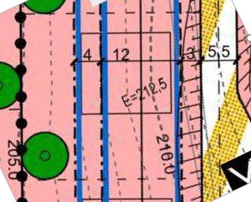

Zoning Plan / Restrictions

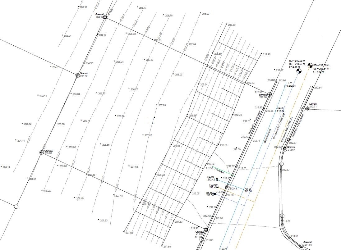

Plot size: 600 m² (22 m wide x 27 m deep) (72 ft x 89 ft)
Slope: yes, steep slope (approx. 8 m on the north side and 7 m on the south side; see attached leveling plan)
Site coverage ratio: 0.4
Floor area ratio: 1
Building envelope, building line and boundary: see zoning plan excerpt
Edge development: no, 3 m setback; garage allowed; 5 m setback required from the street side

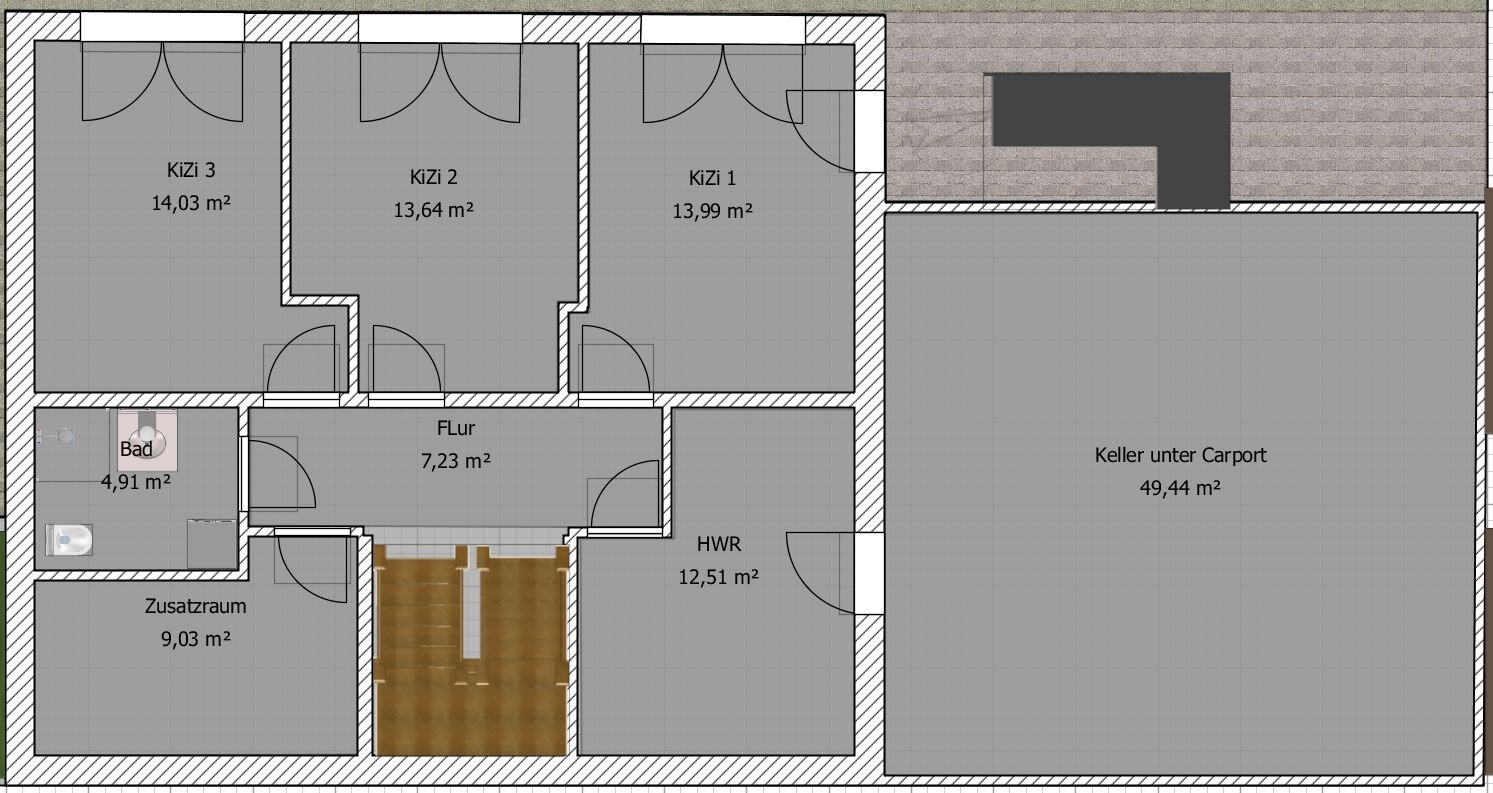

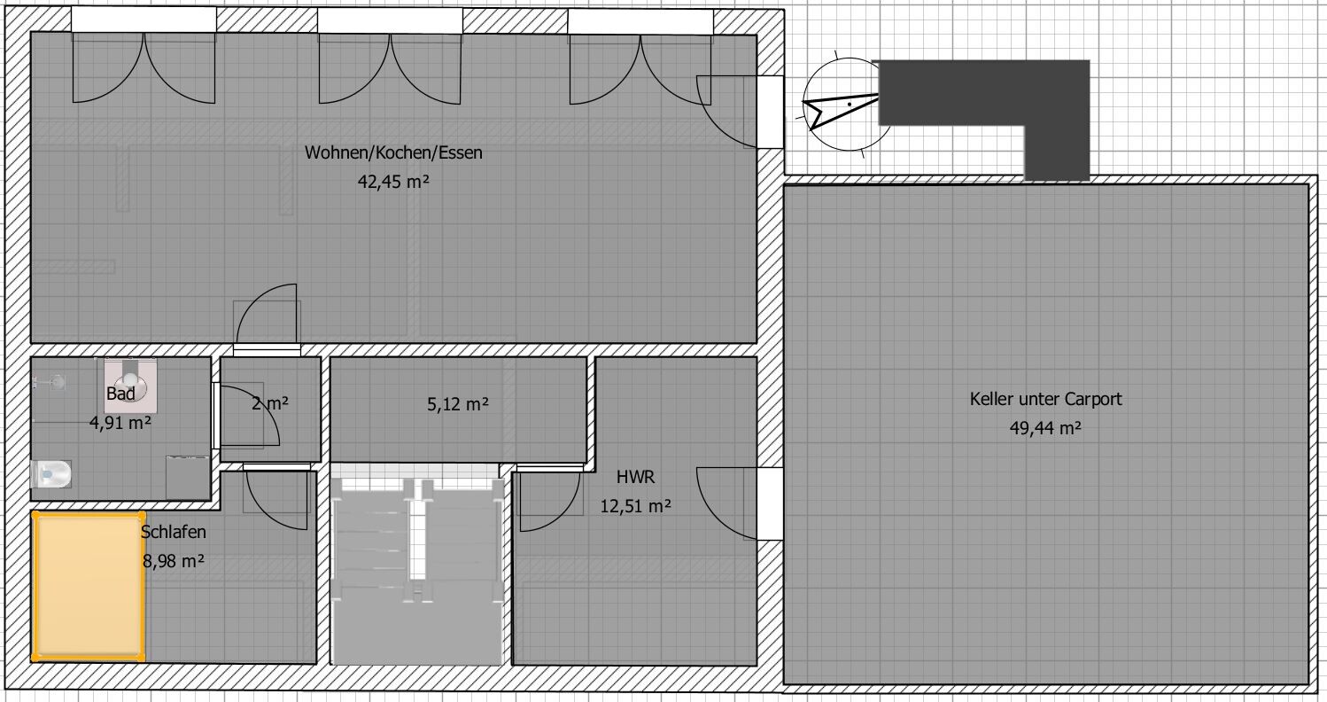

Flexibility is one of the most important aspects of our plan. We want to use the basement initially as a granny flat and later convert it into living space for the children (hence 2 versions of the basement plan). The granny flat would be used for about 10 years before the kids move down there. When the children later leave the house and we no longer need a house of this size, it should revert back into a granny flat. Possibly later, we may also live in the granny flat ourselves and rent the upper area, but that is far in the future. The idea behind this is to alleviate the mortgage payments especially during the first 10 years, when the children are still small and one of us may not be working full-time.
The stepped floor as the parents’ area, or initially a room also for children while they are small. The layout and orientation of the kitchen/living/dining area (maybe a bit small?) facing the sun.
What do you dislike? Why?
Basement: the layout in the rear area of the granny flat (basement version 1): bathroom and bedroom are too small... Any ideas on how to gain space or redesign the granny flat so that the effort to convert to basement version 2 stays minimal.

Survey plan of the property with boundary lines, parcels and elevation data.
Part of a site plan with parcels, dimensions and trees

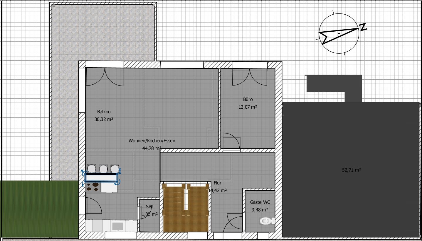

Floor plan of the apartment: balcony, living/cooking area, office, hallway, guest WC, pantry, right area.

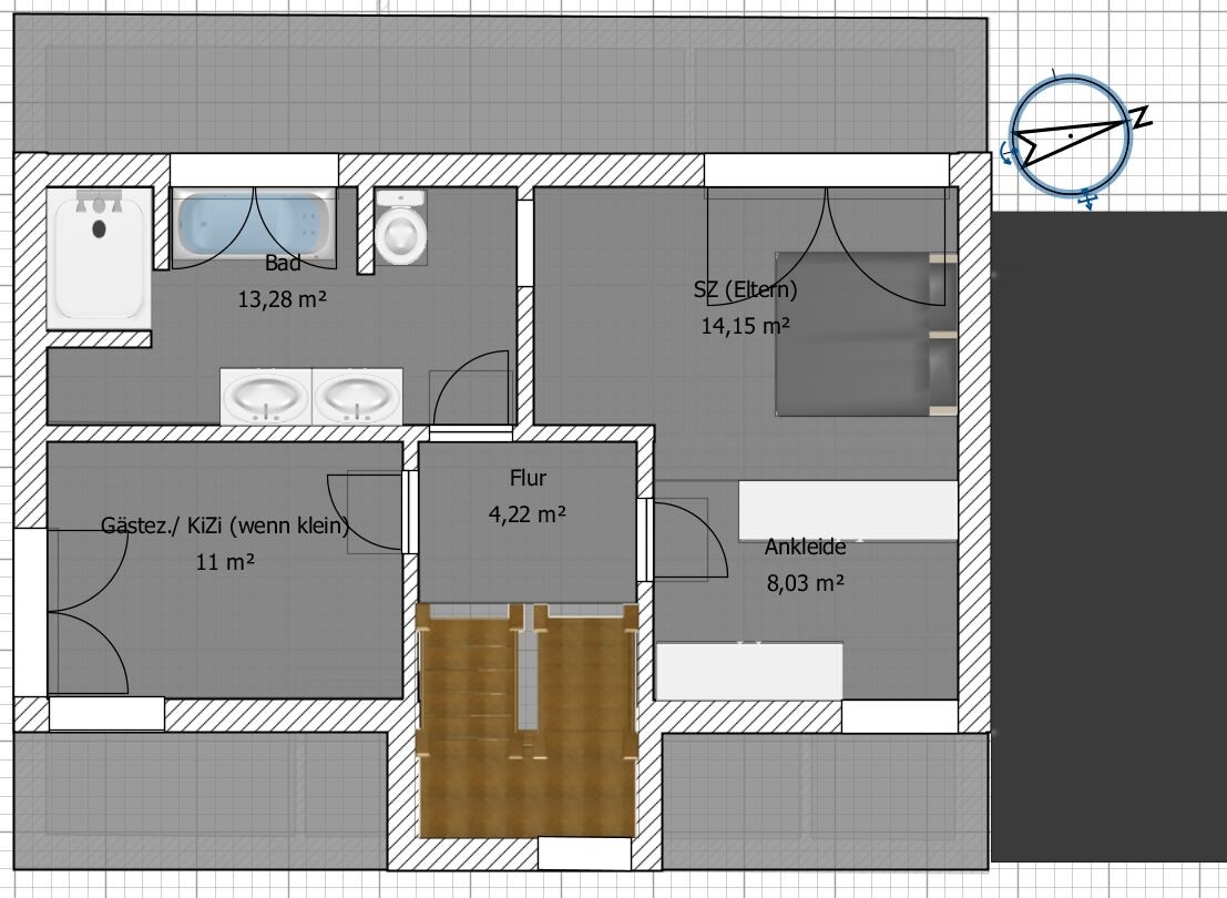

Floor plan of an apartment: bathroom, master bedroom with dressing area, guest room, hallway, staircase.
Floor plan of a house: living/cooking/dining area, bathroom, sleeping, utility room, basement under carport.
Floor plan: three children’s rooms, hallway, bathroom, additional room, utility room, staircase; large basement under carport.

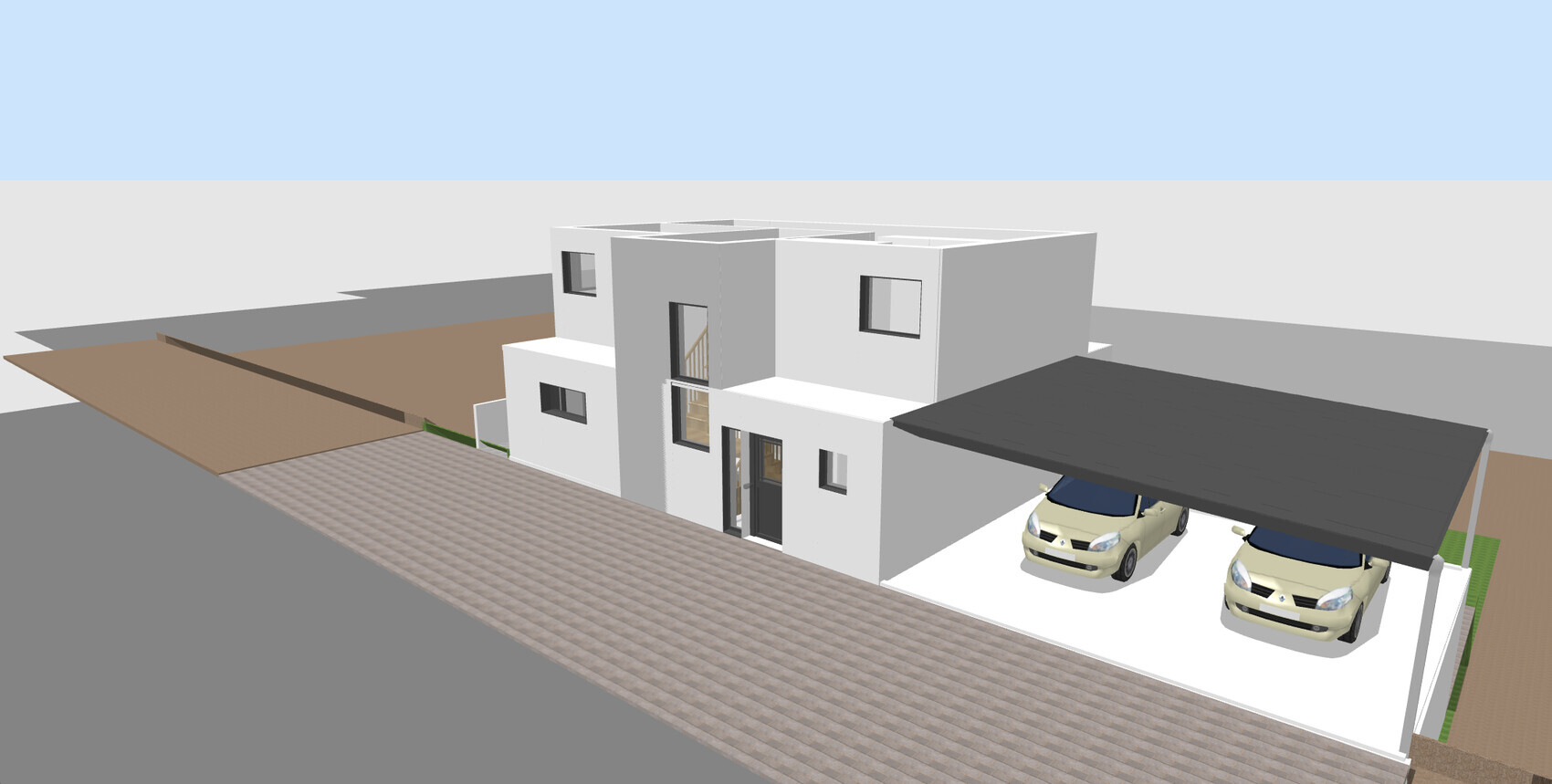

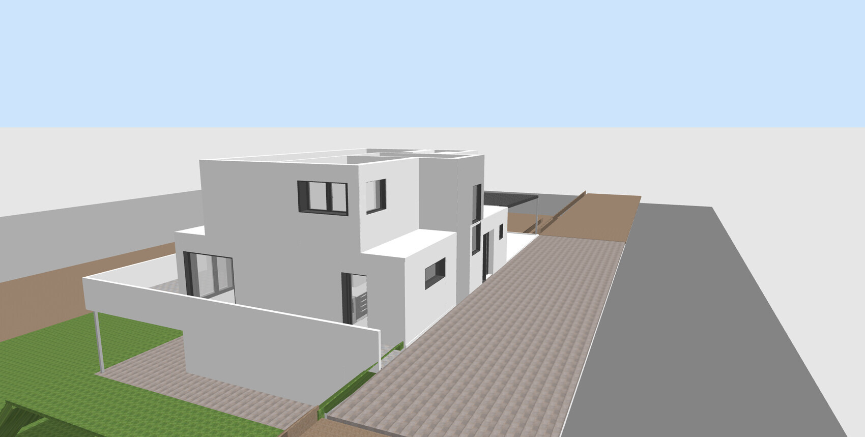

Modern white villa with carport and two parked cars.
Modern white villa with flat roofs, terraces, driveway and garden from a 3D view
Modern grey villa with carport, two cars and balcony on sloping plot.
Modern white villa with terrace, carport, hillside and garden (3D model)

My future partner dreams of enjoying the view from the bathtub.
Where exactly does she want to look?
This post I copied was in response to the earlier comments, then later the discussion about the living room in the lower ground floor came up.
Let me take away the illusion that you consciously look outside while in the bathtub. Usually, you want to relax, close your eyes, and/or it’s dark outside and/or the blinds are down while bathing.
How is that supposed to work? Lying or sitting in the tub with your head tilted? And when you get out of the tub, do you discreetly cover yourself due to modesty?

I took another look at the floor plan and still don’t find it great. The tiny pantry is annoying, the corner in the bedroom as well, only a complicated layout is possible in the dressing room, and so on.

One disadvantage might be that you have to carry all groceries down a full flight of stairs. I consider that negligible.
We have to carry groceries up half a flight of stairs, which was an absolute no-go for us at the planning stage. Eventually, I realized that with a sloped lot you have to accept compromises.
After almost 1.5 years in the house, it feels so normal that I don’t even see it as a disadvantage anymore.
On the other hand, I can go straight from the kitchen onto the terrace and into the garden.
- Exactly, the groceries (for us it’s a whole floor, not half).

I took another look at the floor plan and don’t like it much either. The tiny pantry annoys me, the corner in the bedroom as well, only a complicated layout possible in the dressing room, etc.
I agree. I’m not happy with the pantry either and would remove it given its size. I reduced the bedroom corner at the expense of the hallway and don’t think it’s too bad. Thanks. We also see the dressing room the same way.
Does anyone have ideas for arranging the basement rooms? Preferably only 3 rooms plus bathroom plus utility room.
