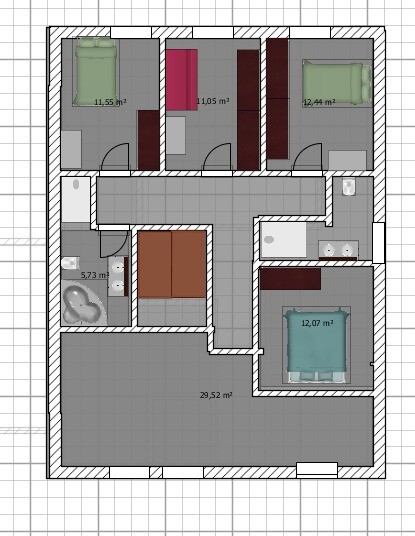

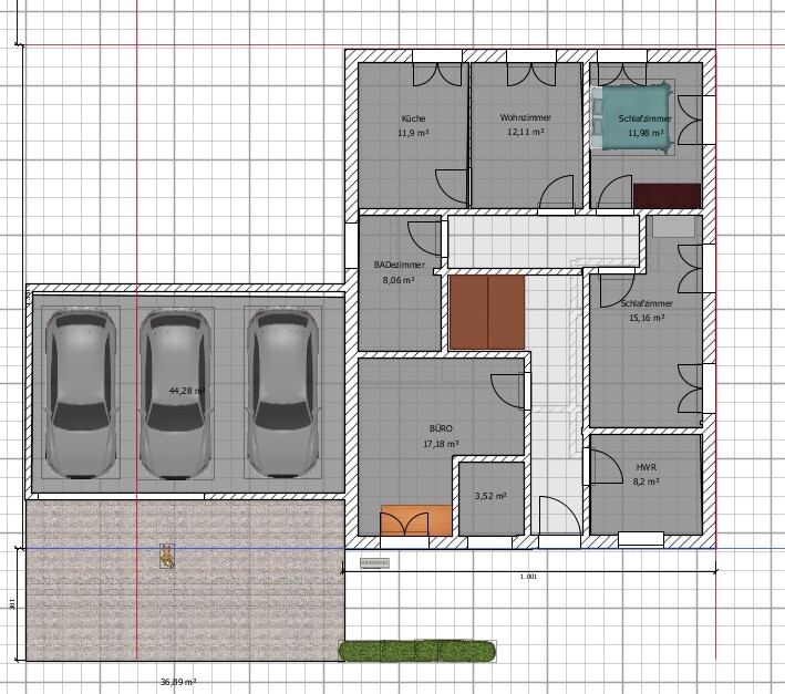

Hello, we are planning our house, which we want to share with my mother (separate apartment approximately 70 sqm (750 sq ft)). We want to maximize the floor area with 137 sqm (1,475 sq ft). Maybe someone has ideas, suggestions, or improvements. We are grateful for any input.
Plot size 459 sqm (4,940 sq ft), 21.5 * 21.4 meters (71 * 70 ft)
Site coverage ratio 0.3
Building area 15.4 * 13.4 meters (50 * 44 ft)
Building line 3 meters (10 ft) and boundary line 5 meters (16 ft)
1.5 storeys
Roof type: steep roof, minimum 35 degrees
Street-facing gable
Maximum heights / limits 9 meters (30 ft)
Other requirements: max 1.15 meter (3.8 ft) knee wall
Owners’ Requirements
2 storeys + expandable attic
Upstairs: 5 people, including three small children. Ground floor: 1 person, mother
Space requirements ground floor
Mother’s apartment: 2 rooms + living room + open kitchen,
separate office with WC.
Space requirements upstairs: 3 children’s rooms, master bedroom, open living and kitchen area, two bathrooms
Office: home office, possibly for visitors
Conservative construction
36 cm (14 inch) masonry
Open kitchen, kitchen island upstairs
Number of dining seats upstairs 6-8
Possibly a balcony
Garage added later
Staircase to attic with roof window accessible from both households
Designed by:
- Do-it-yourself
What do you dislike? Why? Dark corridor
Personal budget for house including fittings: 400,000
Why is the design like it is now?
What do you think is particularly good or bad about it? Maximum size utilized, difficult implementation due to sloping roofs
Thank you, maartina
Grundriss eines Hauses: Dreifachgarage links, Küche, Wohnzimmer, zwei Schlafzimmer, Bad, Büro, HWR.
Grundriss einer Wohnung: vier Schlafzimmer (oben drei, unten rechts), Wohnzimmer, Bad und Flur.
