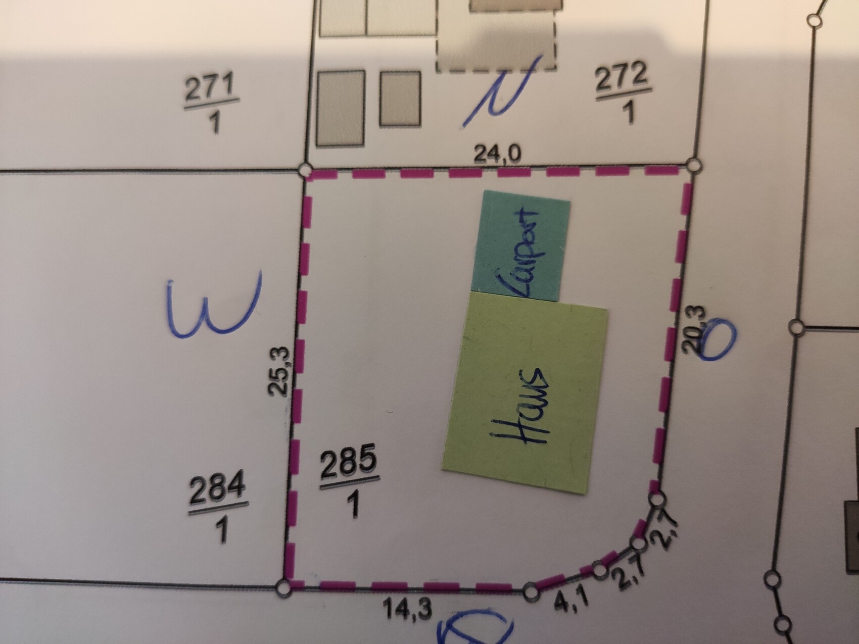

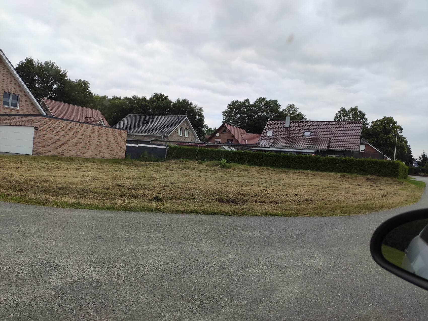

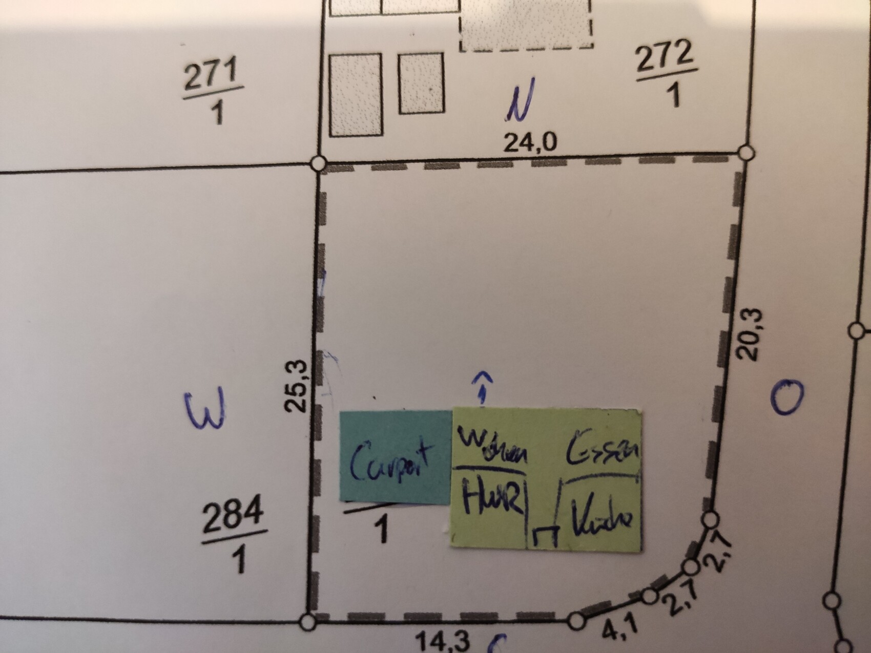

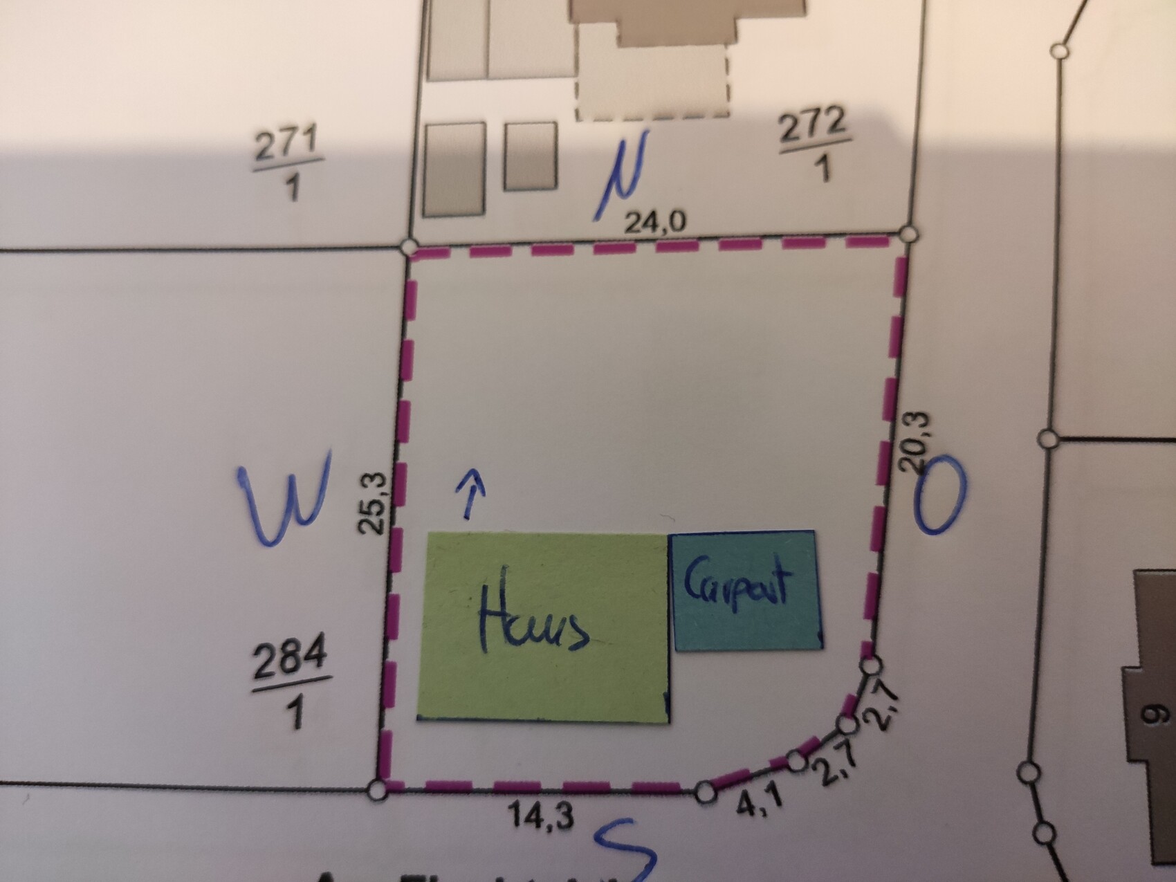

I cut it out the old-fashioned way so I could move it back and forth on the plan to scale—sorry for the rather poor quality. I’ve also attached a picture of the plot.
It’s definitely important to me to make the most of the garden space the plot offers. We’ll be sitting on the terrace mostly in the evenings, except on weekends and during vacations.
With the entrance facing east, I feel like a lot of space is “wasted” because there’s only a small strip available behind the house in the terrace area, and you directly face the neighbor’s garage and driveway to the west—although you would have a larger area to the south, which would be nice. Overall, I have the (subjective) feeling that placing the entrance on the south side provides more garden space, means you don’t have to “block off” so much from the neighbor to the west (in one design, the carport would be next to their driveway), and makes the property boundary, for example with a hedge, simpler and potentially more attractive. Maybe I just lack the creative mindset for designing with an east-facing entrance.
The problem there is, of course, the lack of sunlight on the terrace.
A plus with a south-facing orientation would be the (planned) photovoltaic system later on, which would naturally get more sun.
I think the option with the carport on the corner is the worst of all solutions.
