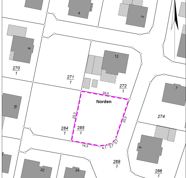

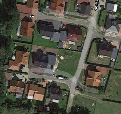

I have been a silent reader so far, but our project is becoming more concrete, and at the moment I am struggling a bit with the orientation of the house on the corner plot.
In brief, here are some details:
Plot size: 557m² (about 5990 sq ft)
Planned living area: approx. 128m² (about 1378 sq ft)
House dimensions: 10.99m x 8.49m (36 ft x 28 ft)
A double carport is also planned
The building setback line according to the development plan is 3m (10 ft)
Attached are the site plan and a satellite image – what are your ideas for placing the house along with the double carport?

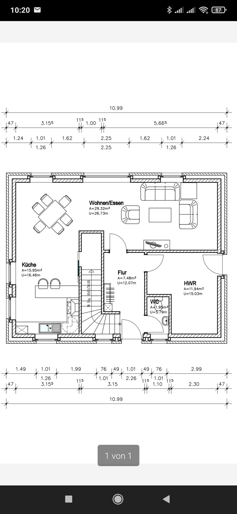

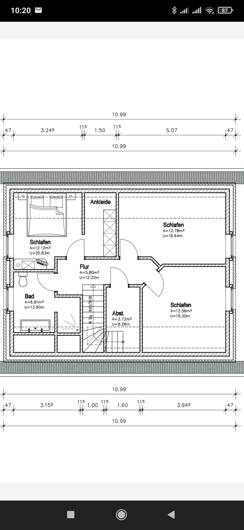

The floor plan is fixed as a draft but can still be changed. Depending on the position, it would theoretically only need to be mirrored.
Floor plan of a residential house with three bedrooms, bathroom, hallway, storage room, dressing room, and staircase.
Floor plan: open living/dining area with kitchen, hallway, utility room, and WC, staircase

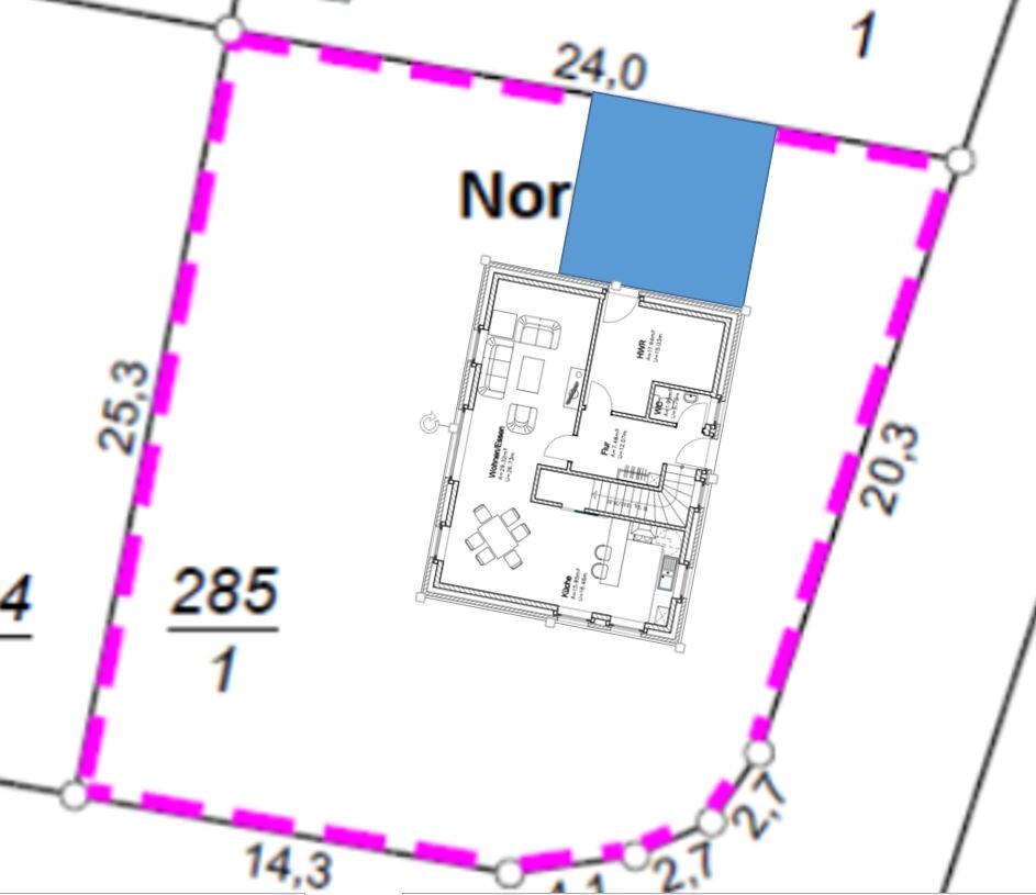

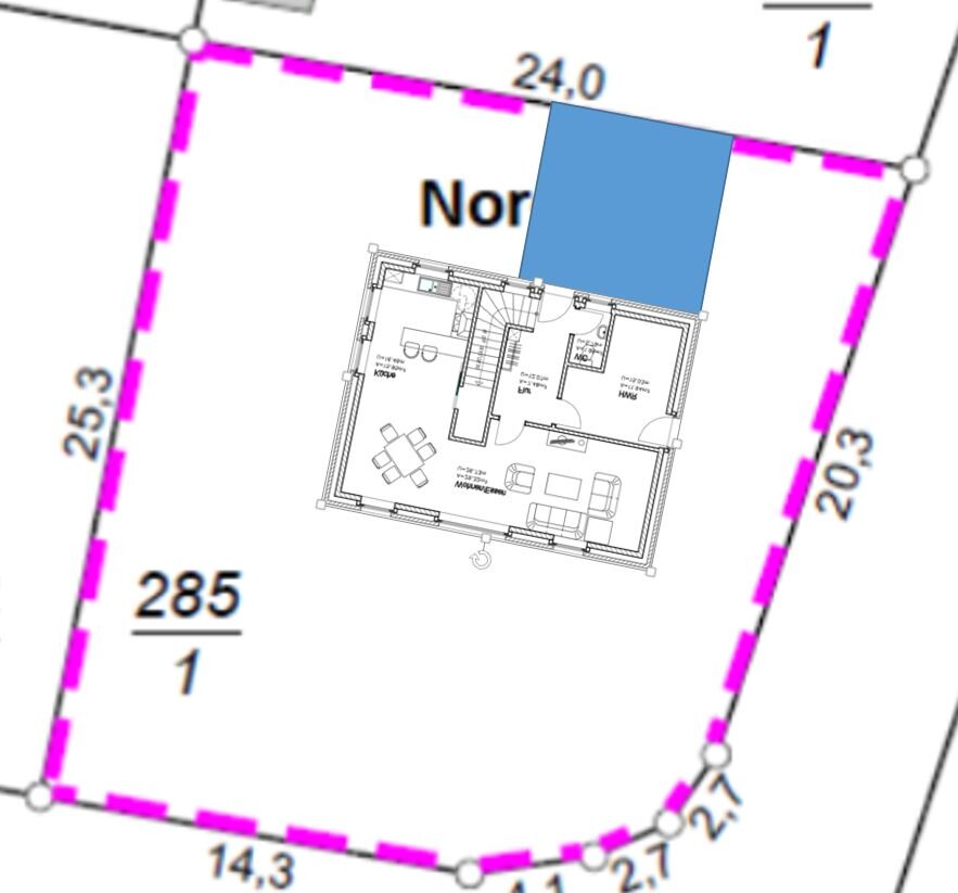

hanghaus2000
26 Jul 2021 11:20
With the entrance facing the street, the floor plan needs to be adjusted accordingly.
Grundriss eines Hauses mit Küche, Essbereich und Wohnzimmer; blaue Terrasse; Grundstücksgrenze

hanghaus2000
26 Jul 2021 12:34
I would not place the entrance on the south side.
Here is another suggestion.
Ground plan of a house on an irregular plot with pink border and blue extension north.
