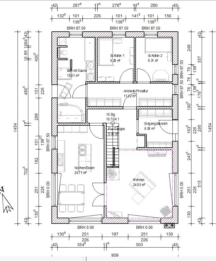

I do not follow most of the accusations: the list of questions has been covered quite extensively in the original post. Not all measurements are given, but the width of 8.75 m (29 feet) between the exterior walls, total length of 14.34 m (47 feet), and 62.5 cm (25 inches) planning grid are recognizable. The staircase is 90 cm (35 inches) wide, and the side aisles are each 3.12 m (10 feet 3 inches). Basic type: hall house, everything understandable.
The bathroom and kitchen are aligned on the same plumbing line, and placing the utility room centrally in between seems like a smart idea.

@He.Di ... as I mentioned before, did a bit of tinkering. Moved the sauna to the ground floor, and the equipment for it to the upper floor.
Here are some unordered thoughts in bullet points:
  • Sauna with an external exit, hopefully enough relaxation space by the window with a view of the greenery.
  • Bathroom on the ground floor also houses the washer and dryer as a stacked unit; there is also an outside exit from the bathroom. Laundry can be hung outside in summer, and almost all laundry will be done in this area in the end.
  • Sleeping, dressing, bathing, showering, and sauna all combined in a kind of private area.
  • The wall between the two bedrooms can be removed to create a large bedroom; even the dressing/privacy corridor area could be arranged differently.
  • In the hallway, a built-in closet flush with the wall to store vacuum cleaner and cleaning supplies.
  • Shelf under the staircase for the living area.
  • Piano included in the living area.
  • Kitchen is now about 350 cm wide (140 inches) with an idea of how I picture the kitchen layout. It would even be possible to integrate storage under the stairs built into the right wall for drinks and similar items.

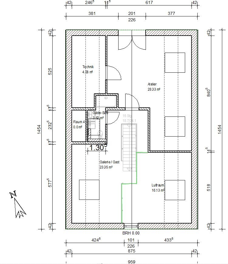

  • Upper floor ... For easy delivery of building services equipment, a double glass door in the studio. Access to the technical room also from the studio.
  • Then a guest bathroom upstairs, guests can also use it as a toilet—they just have to go upstairs, which I consider reasonable. There is space on the gallery for a guest bed. Possibly you might want to separate a room there for use as a reading or guest room.
Roof without knee wall, pitched at 45°.
This is not all perfectly polished and largely follows the original plan, which I find reasonable in many respects. The staircase will only be enclosed underneath, which is always hard to depict (or maybe my skills are insufficient ).
