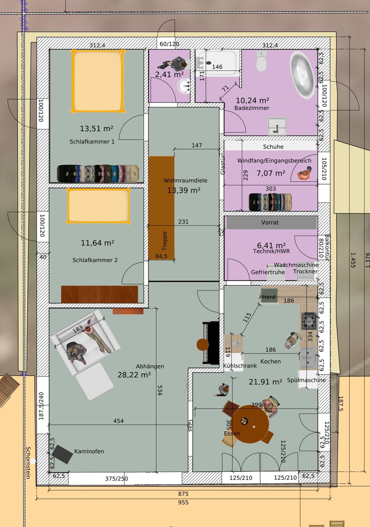

Ah yes. Nice – roughly what would have come out from the architect with this wishlist.
Hello. Hardly away for a day and so much happens. Hey... the plan is great, I’ll take a closer look at it. Thanks. But I already had one before:
Ta-da... I went back to my sandbox and played with my building blocks again.
This time a dream home for people in advanced?? age, walker-friendly!! and with a brighter piano area (which would also fit well in the gallery). Because of that, there are a few more corners upstairs. And I’ve been moving the toilet around again. I designed the staircase according to DIN standards and regulations using an online calculator, though unfortunately I can’t draw arrows with the program. And the bedrooms can even fit double beds now. Have they finally become real rooms? And there’s a fully lit and ventilated guest bathroom as well. Who’d have thought.

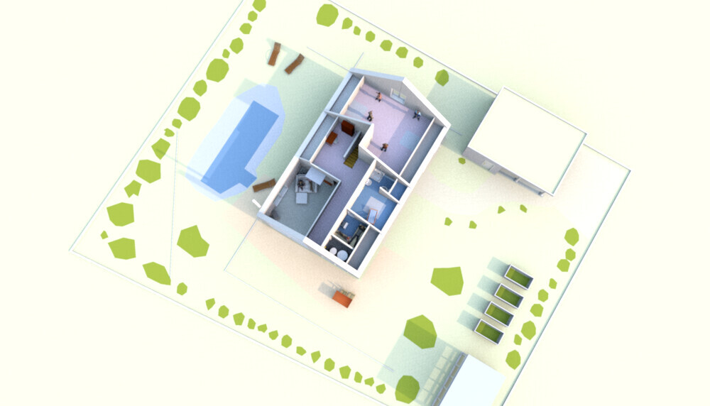

But now: The plans….toot toot:
The house could be rotated a bit more to the south, gable side facing south. The 3D images show the sun position on 01.04. at 10 a.m.

Ouch, you’re probably going to get scolded again because the bird’s-eye view of the upper floor is rotated 180° compared to the ground floor.
You’ve been busy and made quite a few changes. It looks tidier now; I also liked the first version, but the bathroom is now properly arranged.
And I’ll get scolded again if I boldly claim without any proof that the stair arrow tip is supposed to point into the gallery...
@kbt09: The plan is really good, I’m saving it... although it’s even more complex than mine... may I ask which software you use to draw it?
There is a problem, though: my wife wants HER sauna upstairs so she can lie down on the lounge chair after sauna sessions instead of having to stay in the living area. Then I could hang around there. She says she doesn’t want to go outside because sauna time is mostly wintertime anyway. And she doesn’t like cold plunging either.

Ouch, you’re probably about to get scolded again because the upper floor’s bird’s-eye view is rotated 180° compared to the ground floor’s
You’ve been busy and made quite a few changes. It looks tidier now; I liked the original too, but the bathroom is now neatly arranged.
And I’ll probably get scolded again for boldly claiming without any proof that the staircase arrowhead would point towards the gallery...I actually rotated it because looking from the north, you’re right and I can’t draw arrows. Honestly, I don’t know how to plan any tidier or clearer, at least not with the given requirements. I’m most proud of the dining area, which got the most criticism... It’s still not a ballroom, but there’s enough space — even for sharp elbows.

I specifically included a lounge chair in front of the exit in the bathroom.
And, sorry, but I really don’t like your last plan at all. The dining/kitchen area has definitely suffered.. I still can’t quite figure out what the kitchen means to you. I find the private rooms way too public. By the way, you now have a knee wall and what roof pitch angle are you using?
