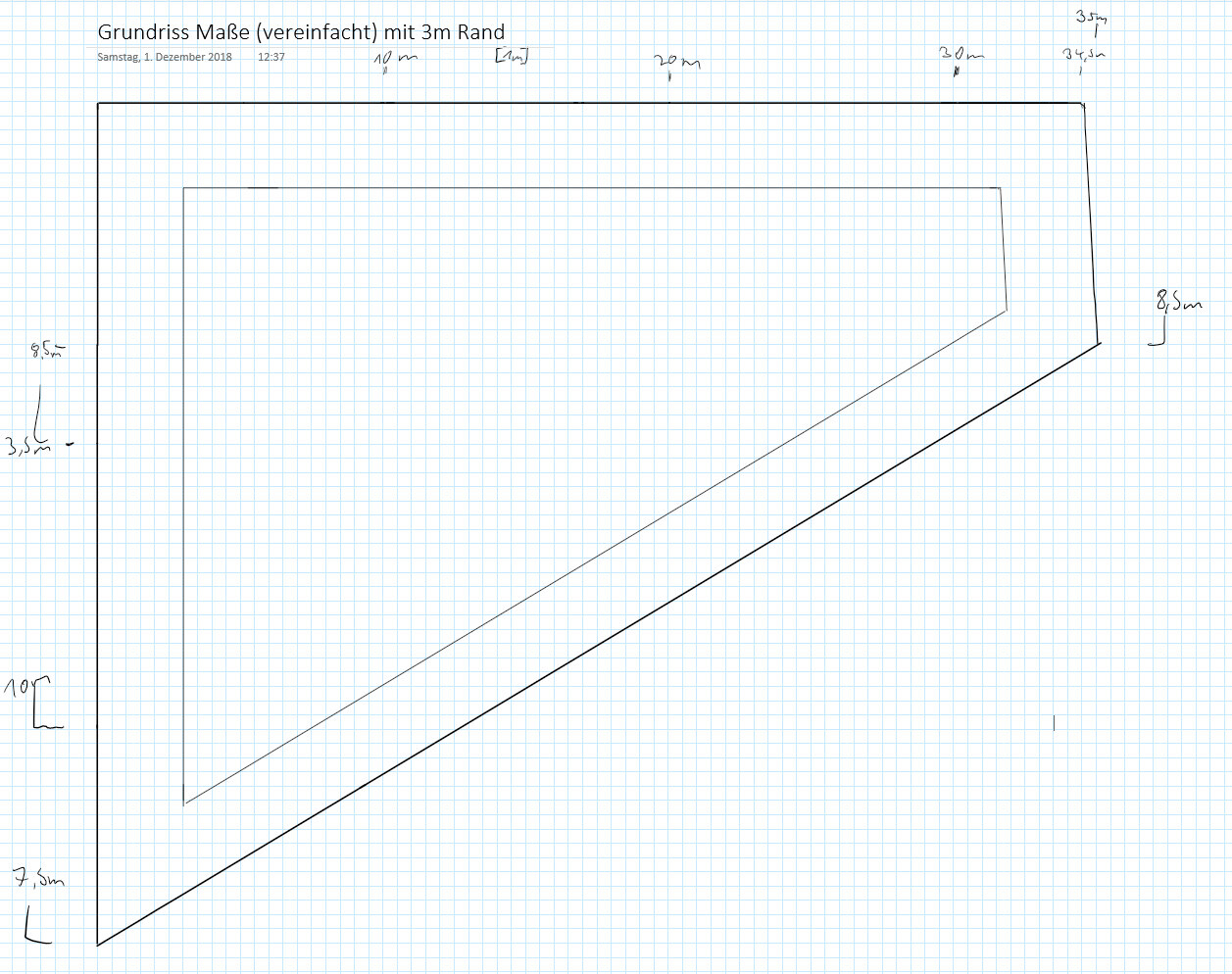

Plot size: 732 m² (7,881 sq ft)
Slope: slight south-facing slope, approx. 2.5 m (8 ft) drop over 30 m (98 ft) length
Floor space index: No development plan
Floor area ratio: No development plan
Building envelope, building line and boundary: Standard 3 m (10 ft) setback from property line
Edge development: Standard 3 m (10 ft) setback from property line

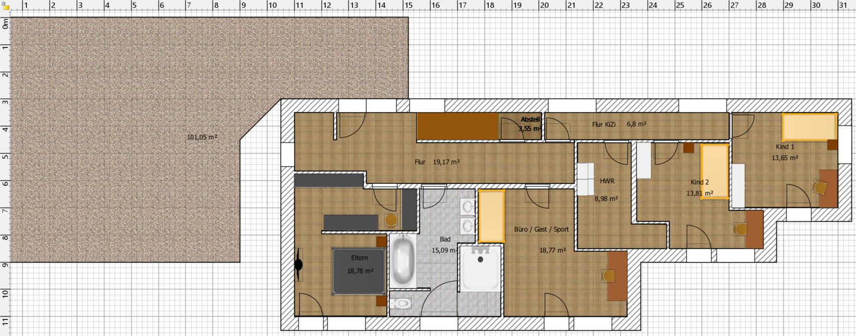

[U]What is the most important/basic question about the floor plan, summed up in 130 characters?[/U]
Am I overlooking anything important that would make this floor plan unfeasible without high extra costs, or does the rough plan seem reasonable so far?

Do you have such a great view?
I am a supporter of having direct garden access from the living areas.
The budget doesn’t fit. It is too small.
Disproportion between children's room and hallway
Hallway is larger than the children's room.
I wouldn’t place the utility room there.
The ground floor looks like Tetris. Remove a few corners.
hampshire5 May 2019 21:16Architecture serves the people who live in it, and you have young children. Supervising them becomes quite challenging with the routes between the living area, bedrooms, and the outside, as well as the layout that allows the children to leave the house without passing through the living space. Since the house was not planned to include an au pair or childcare help, I consider the design unsuitable for a family with children under 16 years old.
The basic idea of living upstairs and sleeping downstairs is appealing—especially if there is a worthwhile view.
The budget does not seem to match the design; you will likely be able to cover only about two-thirds of the costs.
- Staircase too short, it’s only 3 meters (10 feet)
- Entering with no space for a wardrobe... or is the entrance supposed to be on the sleeping floor? How does the building fit into the slope then?
- Master bedroom: 3 meters (10 feet) for the bed (meaning a maximum sensible bed width of 160 cm (63 inches), leaving only 60/65 cm (24/26 inches) on each side for the bed frame)
- Kitchen design: the distance between the island and tall cabinets is not practical
