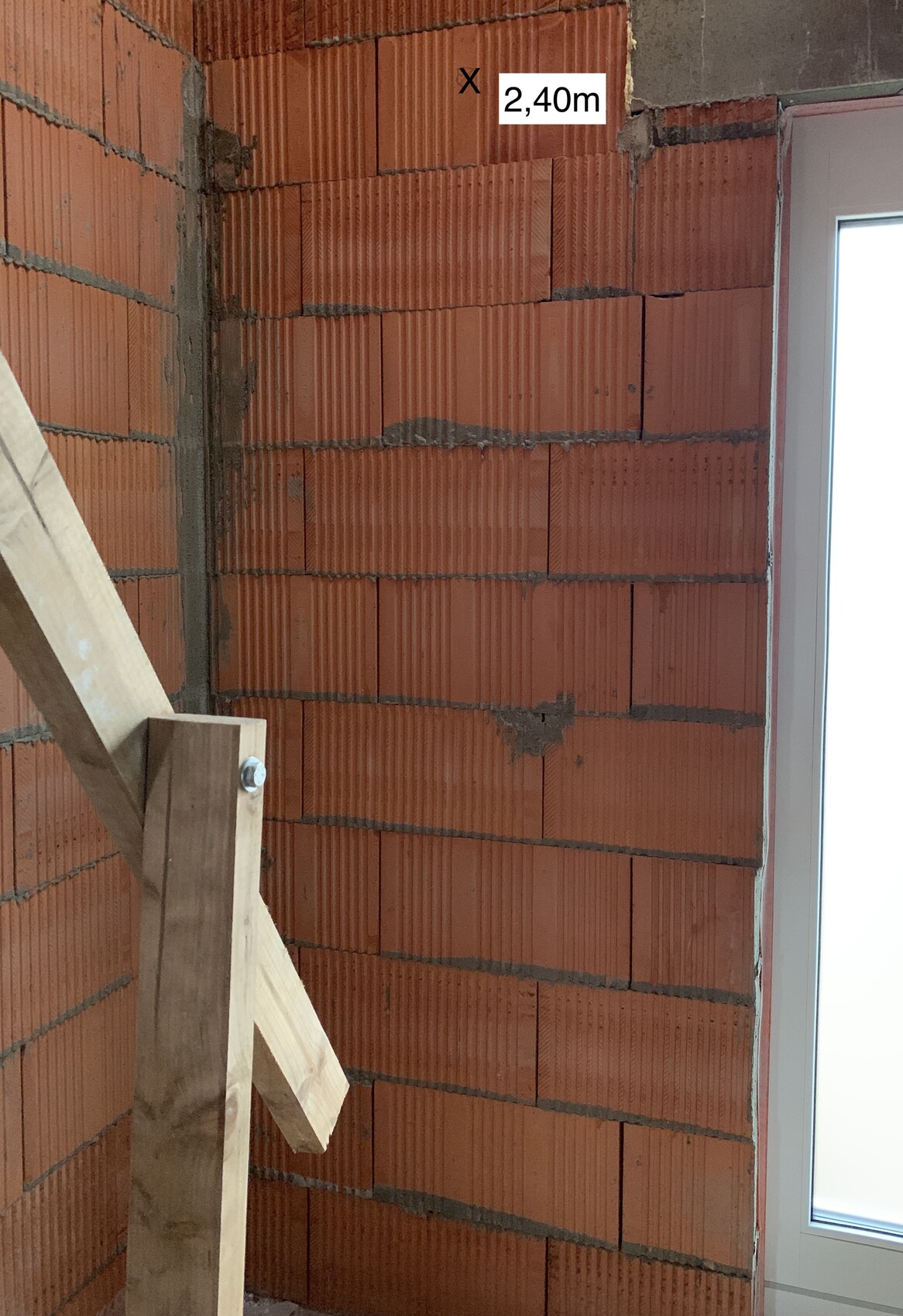

Yes, the original idea was exactly like in your pictures.
Hmm, I would probably choose the safer option and position it high enough. It will be a quarter-turn staircase.
Attached is the position of the first light as well. 2.4m (7.9 ft) above the raw floor level. If I subtract the floor build-up and the possible height of the staircase at that point, maybe around 50cm (20 inches), the distance between the step and the wall light would be about 1.7m (5.6 ft).
Attached is also the position of the first lamp, 2.4m (7 ft 10 in) above the raw floor level. If I subtract the floor build-up and the approximate height of the staircase at that spot, maybe 50cm (20 inches), you would actually have about 1.7m (5 ft 7 in) distance between the step and the wall lamp. Run an empty conduit up to point X and keep all options open. Later, you only need to drill a hole in the conduit once, pull the cable through, and wire it correctly in the distribution box. As mentioned, about 30-45 minutes of work. Without an empty conduit, this won’t work without an exact staircase plan, and even with a plan, measuring everything is more complicated than just drilling a hole afterward.
In this photo, you could probably still lay the cable, but by the “longer” side, you won’t be able to match the exact incline of the staircase.
