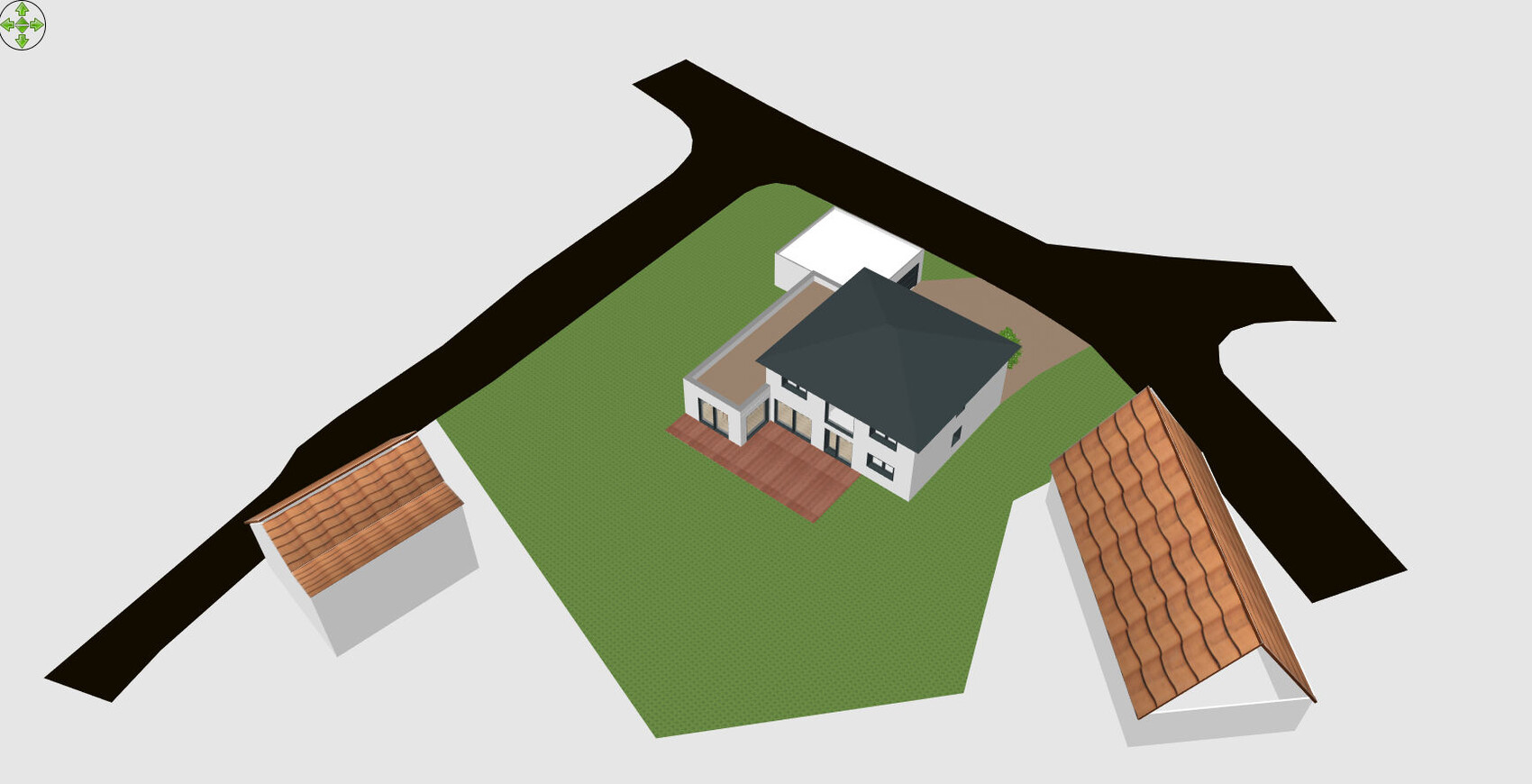

When finalizing our construction contract, we initially removed the garage because it was too expensive (€40,000). It is included in the building permit (7 x 8 m (23 x 26 feet)).
Now that the major risks are gone and the contingency fund is mostly intact, we are reconsidering the garage. The fact is, since we don't have a basement, we need space—even from move-in day—for bicycles, a grill, garden furniture, lawnmower, winter tires, etc.

Anyway, I just can’t decide HOW the garage should be built.
With a slab foundation or paved surface?
Slab smoothed with hard aggregate or with screed?
Solid masonry or possibly a timber frame with fiber cement panels and plastered?
Solid concrete ceiling with flat roof, wooden beam ceiling with flat roof, or maybe a simple trapezoidal sheet metal/sandwich roof?
The garage will primarily be used for two cars and for storing bicycles and garden tools. It should also allow vacuuming the car in winter or rain and performing repairs on cars, bicycles, etc. The adjacent workshop inside the house is too small for large projects like furniture building—so for those, the cars can stay parked in the driveway for a couple of weeks to allow room for creativity.
Current preferences:
- Strip foundations, formed up to +0.30 m (1 foot). Slab with hard aggregate, troweled smooth, and sloped (toward the gate).
Reason: For use as a workshop/work hall, paving is, in my opinion, suboptimal. A smooth floor is easier to clean and water/snow slurry can be removed with a rubber squeegee. To prevent moisture rising from the walls, raise the strip foundations accordingly.
- On that, a timber frame construction with fiber cement panels on the outside, plastered, and raw inside (which can still be finished later or fitted with shelves, etc.).
Reason: Possibly cheaper (?) than plastered solid masonry on both sides; slimmer wall construction provides more interior space.
- The roof’s only purpose is to keep out rain.
I was thinking about trapezoidal sheet metal sandwich panels (to prevent condensation inside). It must also fit with the house extension (single story, flat roof with parapet).
Or wooden beams, boarding, roofing membrane, and parapet with metal flashing?
What do you think??
