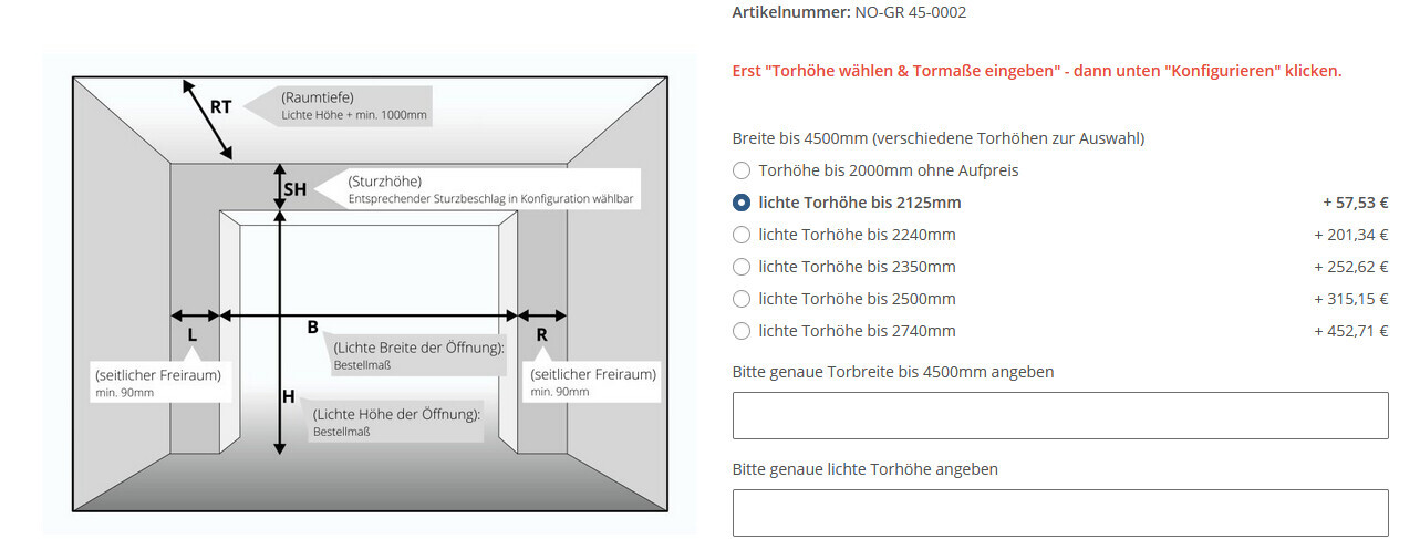

I completed my new build last year and now I’m about to start with the paving.
We haven’t installed a gate yet, so we need to pay attention to the height here. We are still flexible with the height, but prefer the dimensions 5000 x 2125 mm (16 ft 5 in x 6 ft 11 in).
Now my question is, what should the opening height be for a standard gate of 5000 x 2125 mm (16 ft 5 in x 6 ft 11 in)?
1. From the top edge of the paving (after compacting, etc.) up to the lintel (the lintel is also the bottom edge of the driveway opening or garage opening that should be covered by the gate) = 2125 mm (6 ft 11 in), or should I work with some clearance and set the height, for example, to 2100 mm (6 ft 11 in)?
Can someone help me understand the best way to do this?
Thank you very much.

WilderSueden9 Aug 2023 21:37Does the paving extend into the garage? Or would it be easier to pour a small concrete curb under the door that matches the exact height of the door, and then align the paving to that height?
Well, according to the drawing above, you would order a 2125mm (84 inches) gate and would need a clear gate opening height of 2125mm (84 inches).
EDIT:
This means the gate dimension specifications reflect the required installation height. The gate with frame, etc., will of course be slightly taller.
