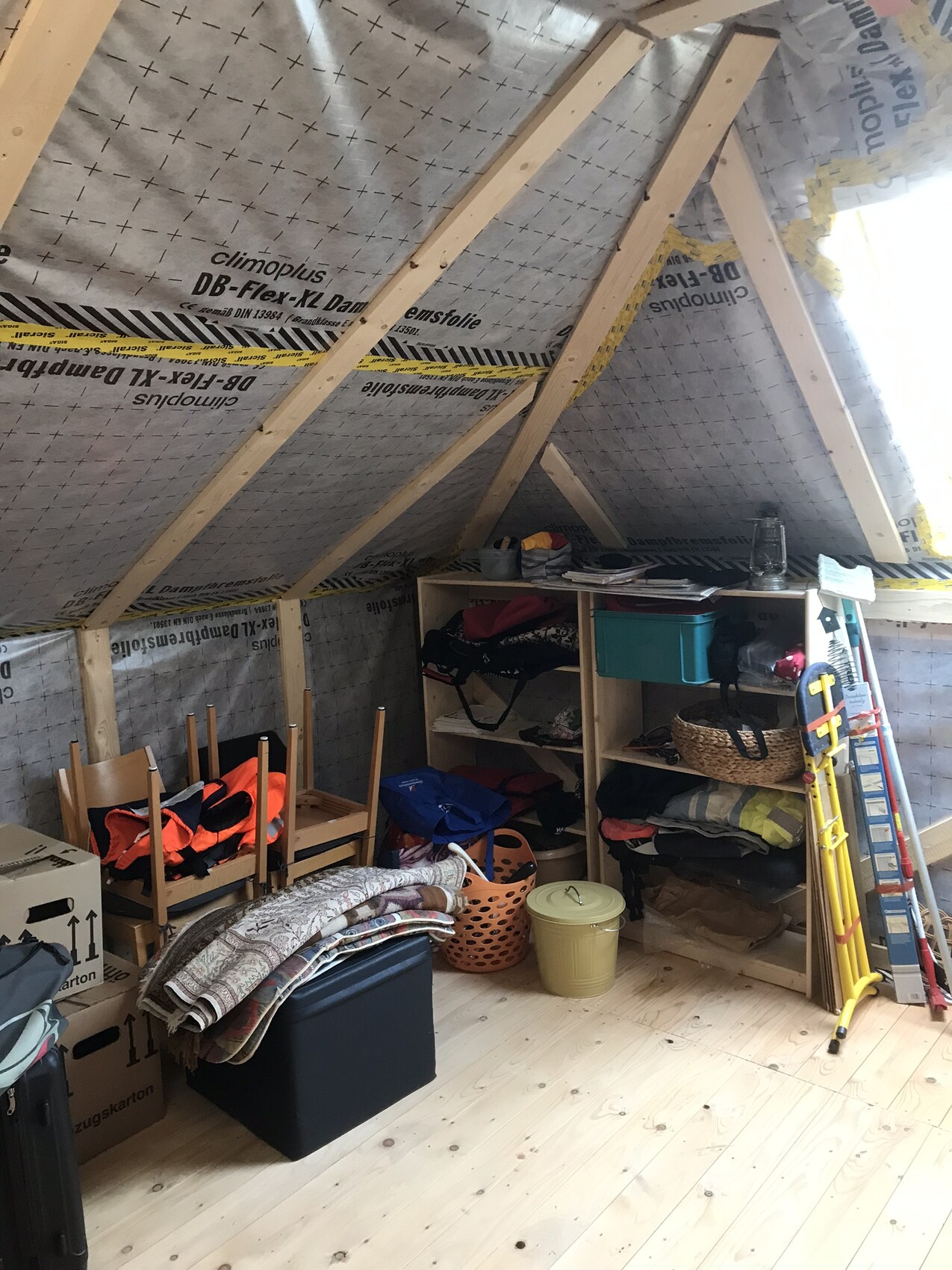

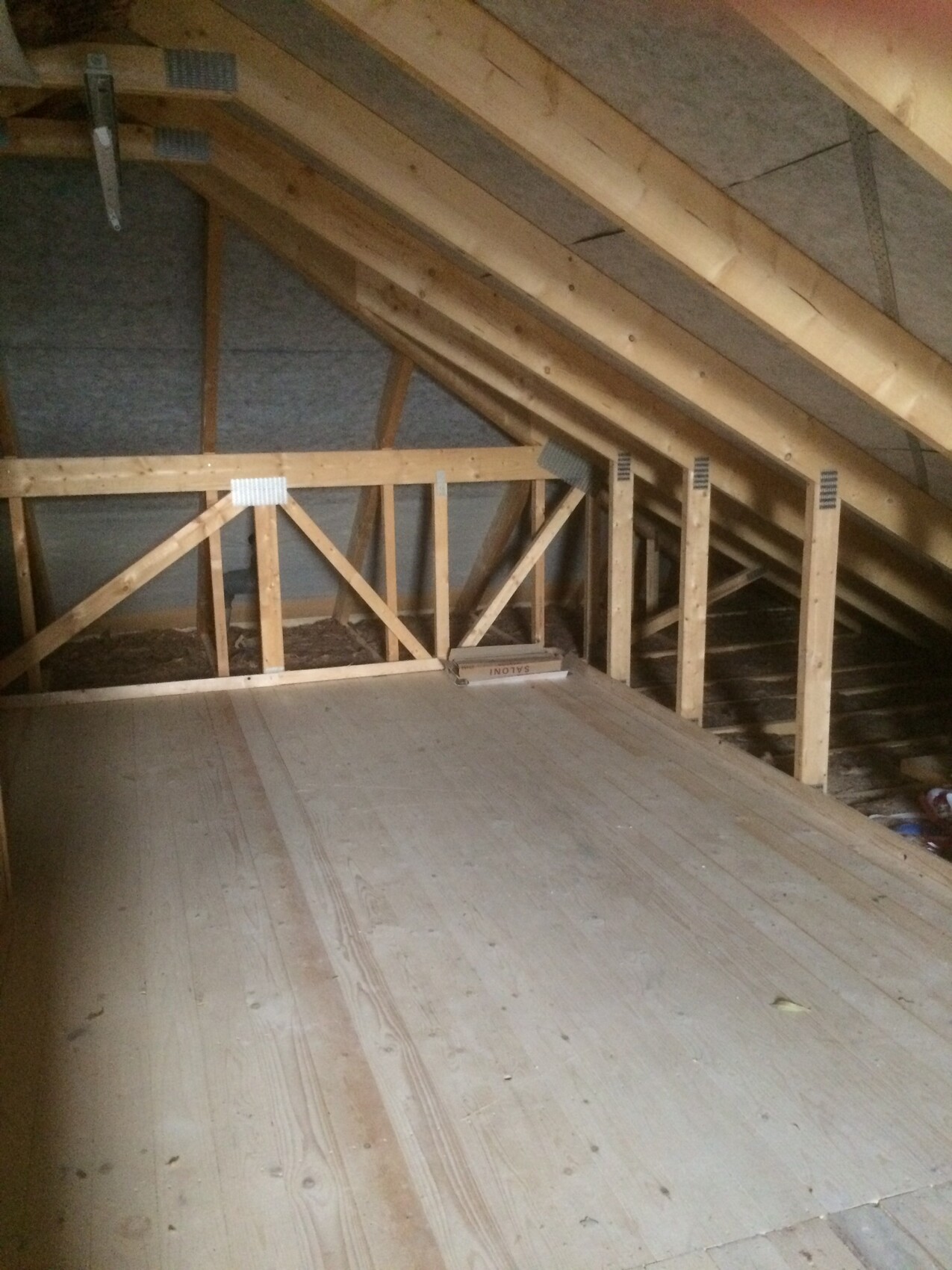

Very precise. Bungalow. The ceiling here is made of wood, drywall, and a lot of glass wool insulation. On top of that, tongue-and-groove boards are nailed, creating a walkable floor. This is the standard construction practice from the builder.
Additionally, between the roof rafters there is compressed insulation batts and a vapor barrier. As a result, the walkable floor is now also temperature-controlled.
