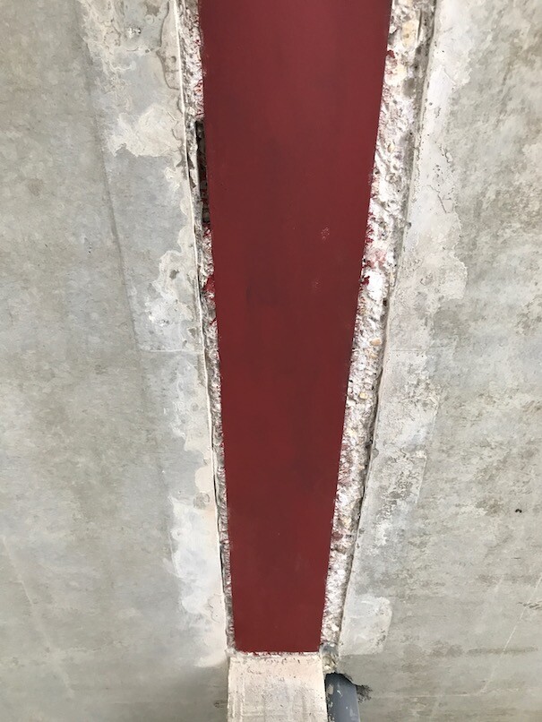

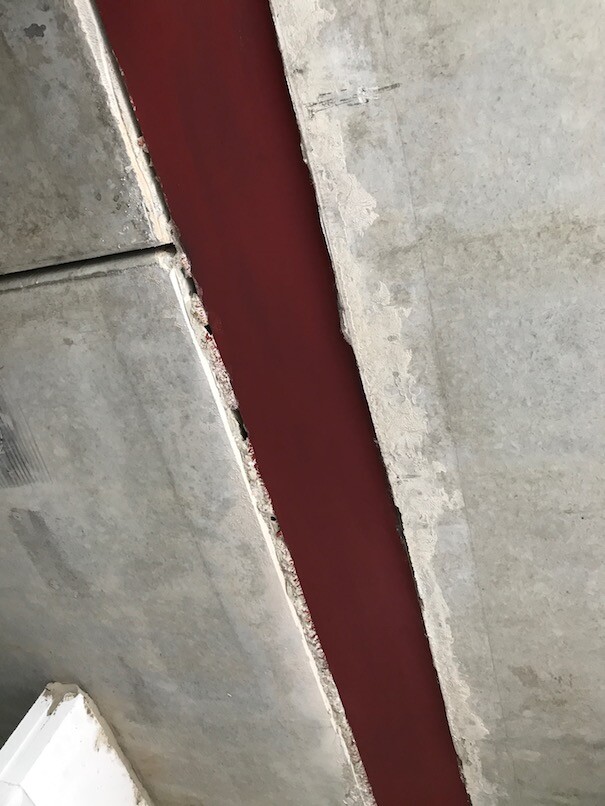

NOUSEFORANAME25 Oct 2017 13:49In our living room, there are two steel beams between the concrete ceiling slabs.
My plasterer doesn’t consider the gap between the individual concrete slabs to be a problem and can fill it.
However, he sees an issue beneath the steel beams. If he were to fill it there, it would only hold for a short time.
Has anyone in this forum dealt with a similar situation?
What would be the simplest solution here?
NOUSEFORANAME26 Oct 2017 13:02Using battens won’t work here. The recess is about 1.5 - 2cm (0.6 - 0.8 inches).
The problem with this "mesh," probably plaster reinforcement fabric, is how to fix it in place. Attaching it under the concrete ceiling is difficult. It would protrude from the ceiling, ruining the smooth, flat surface...

NOUSEFORANAME26 Oct 2017 14:04To explain it more precisely:
Our ceiling will NOT be plastered. It will also not be dropped with drywall, as the recessed spotlights are already planned to be installed in the concrete ceiling.
So unfortunately, applying a mesh on the concrete ceiling is not an option.
