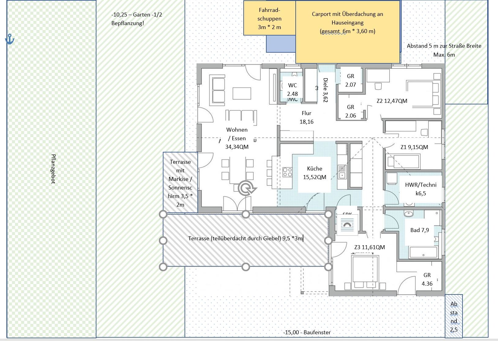

we are currently planning an L-shaped bungalow with the following details.
--> It would be great to get some critical feedback on our current (own) design (Image 1).

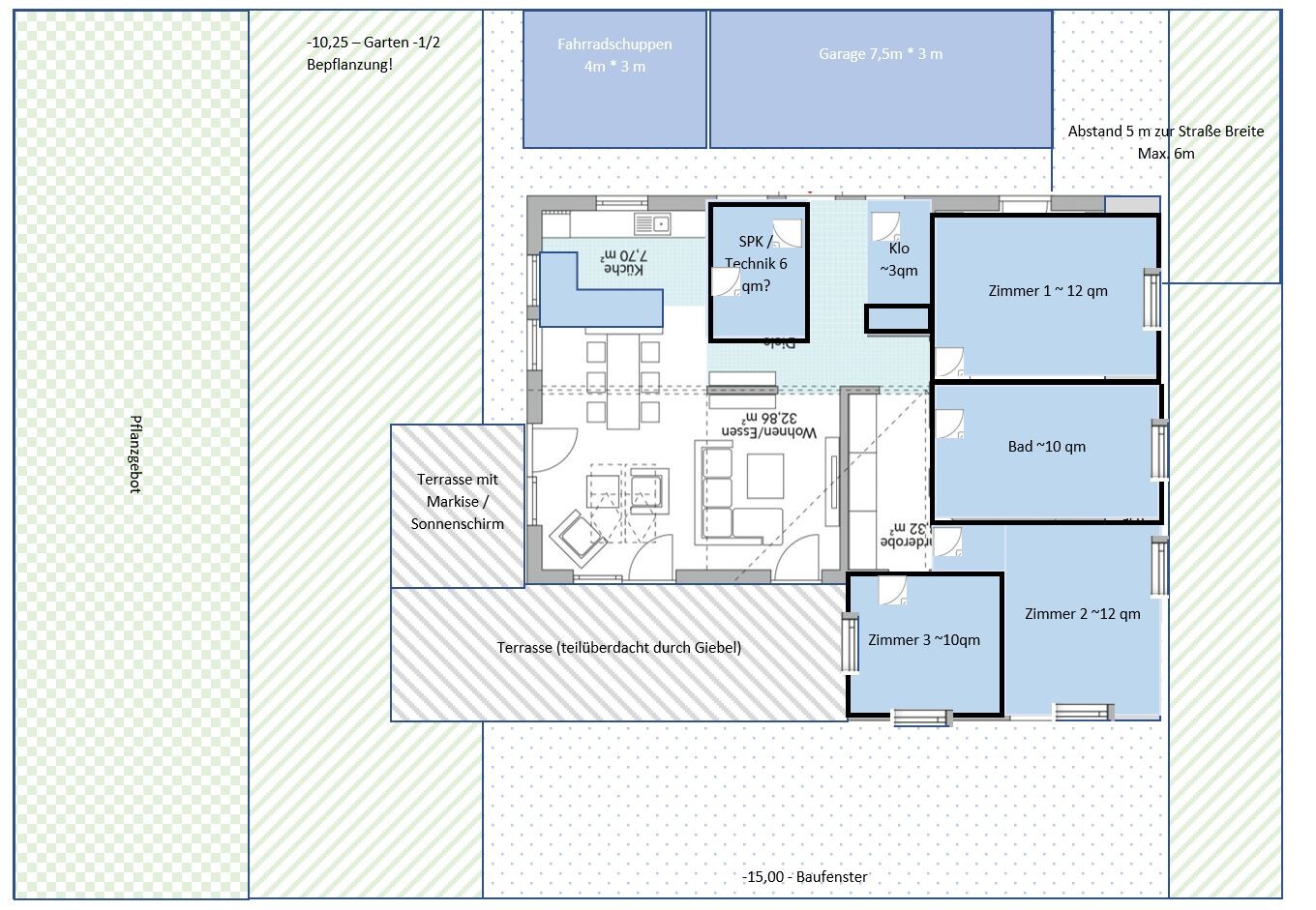

The gable orientation of the main gable is unfortunately predetermined (long side, see site plan, Image 3)

allstar8320 Jul 2019 11:22haydee schrieb:
Furnish the floor plan to scale.
The building systems don’t work for pantry, storage, utility room, and laundry.
I would plan with an interior staircase and use the attic floor as well.Thank you.
I also suspect that the gable roof with at least a 30-degree pitch might still allow for some extra space.

The orientation of the main gable is unfortunately fixed (long side, see building plan, picture 3). Do you mean the ridge? Are you interpreting the arrows on the plot boundaries 2880/2881 and 2904/2905 as such a requirement?
Does the entire plot area count toward the floor area ratio, or is the planting restriction zone excluded?

allstar83 schrieb:
Due to the specified roof pitch and roof shape, a mezzanine level would likely result It would be a large roof because the house width of nearly 13/14 meters (43/46 feet) determines the roof size.
allstar83 schrieb:
Utility room and pantry combined – accessible from both sides allstar83 schrieb:
From the kitchen, the door might open inward or possibly be a sliding door. The issue is that a room with two doors loses usable wall space.
By swapping the utility room and the toilet, you get a setback at the entrance (line of sight from front door to living room access) and an extra corridor between the hall and kitchen. Since this corridor already exists, a second door is completely unnecessary.
However, the design is flawed by placing the door on the side if you have to walk past a garage. It will be very difficult to bring any furniture or even a ladder into your house. This hallway will be extremely drafty; it’s far from ideal, especially in terms of the front door situation.
Check if it is allowed to build the garage outside the building envelope/planning permission area. Otherwise, the front door should be located at the front facade.
The utility room also needs a short route into the house—so it should be at the front as well.
These are basic planning principles that have been overlooked here.

allstar8321 Jul 2019 11:2611ant schrieb:
Considering the redesign of the original floor plan, I would suggest using a different model for inspiration. By stage, do you mean an attic or a loft?
That would already be an example of a more suitable base model.
Do you mean the ridge? Are you interpreting the arrows on the property boundaries 2880/2881 and 2904/2905 as such a regulation?
Does the entire property area apply to the floor area ratio, or is the planting requirement zone excluded? Thank you.
We have now used a different floor plan. We still do not want a basement, so an attic under the main roof with the gable roof and a 30-degree pitch would be a good option.
I haven’t found any information yet indicating that the planting requirement zone would be excluded from the floor area ratio. I am assuming a floor area ratio of 540 * 0.4 = 216.
allstar8321 Jul 2019 11:42Thank you very much for the detailed response!
The roof (most likely a pitched roof) will then be a stage and storage space, since we want to forgo a basement. I don’t think this would be significantly better ecologically.
The main roof would probably be about 14.5m by 9m (48 feet by 30 feet).
The garage is a sticking point – unfortunately, I don’t think it will fit. Therefore, there is now a design with a carport and a covered entrance area.
Attached is the revised design based on the Danwood Perfect 131.
Tomorrow we are meeting the planner. I hope we are not completely off track.

ypg schrieb:In the new design, the utility room/technical room is separate from the pantry. The technical room makes sense in the new design as it is close to the entrance and next to the bathroom (for laundry, etc.).
It’s about the fact that a room with two doors loses usable floor space. By swapping the technical room and toilet, you create a misalignment in the entrance (line of sight from main door to living room access) and an additional corridor between hallway and kitchen. Since the latter already exists, a second door is absolutely unnecessary.
But: the design is already wrong by putting the door on the side if you have to walk past the garage. You will hardly get any furniture into the house or even carry in a ladder. That hallway will be extremely drafty, and this front door situation is far from ideal. Check whether the garage can be built outside the building boundary. Otherwise: front door at the front facade. The technical room also needs to be easily accessible from inside the house, so it should also be placed at the front. These are basic principles that are planned incorrectly here.
