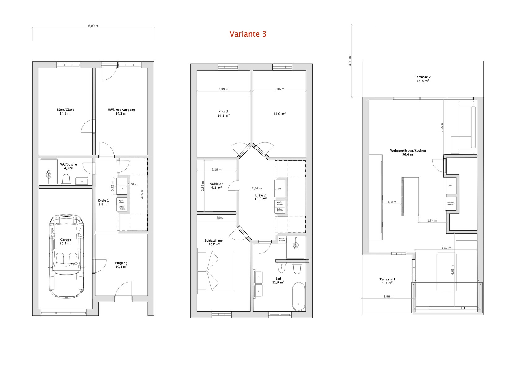

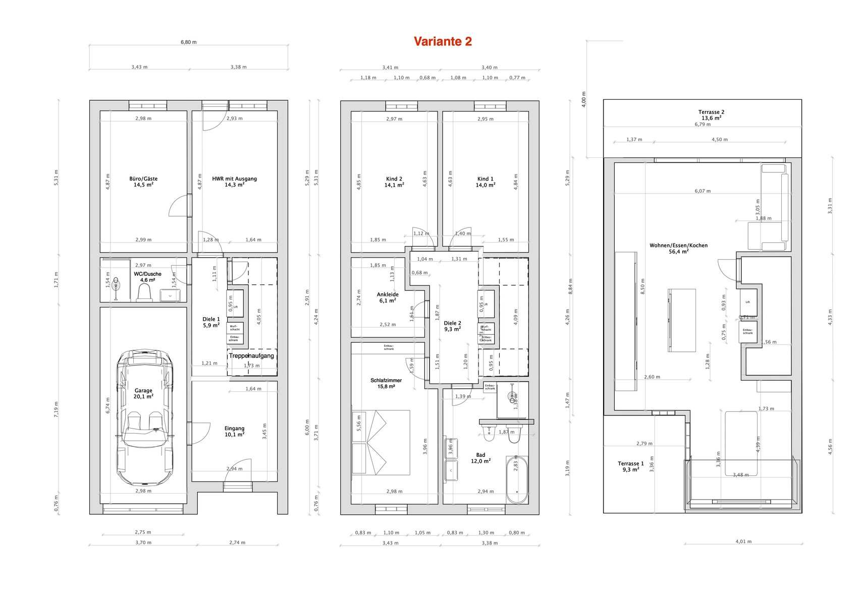

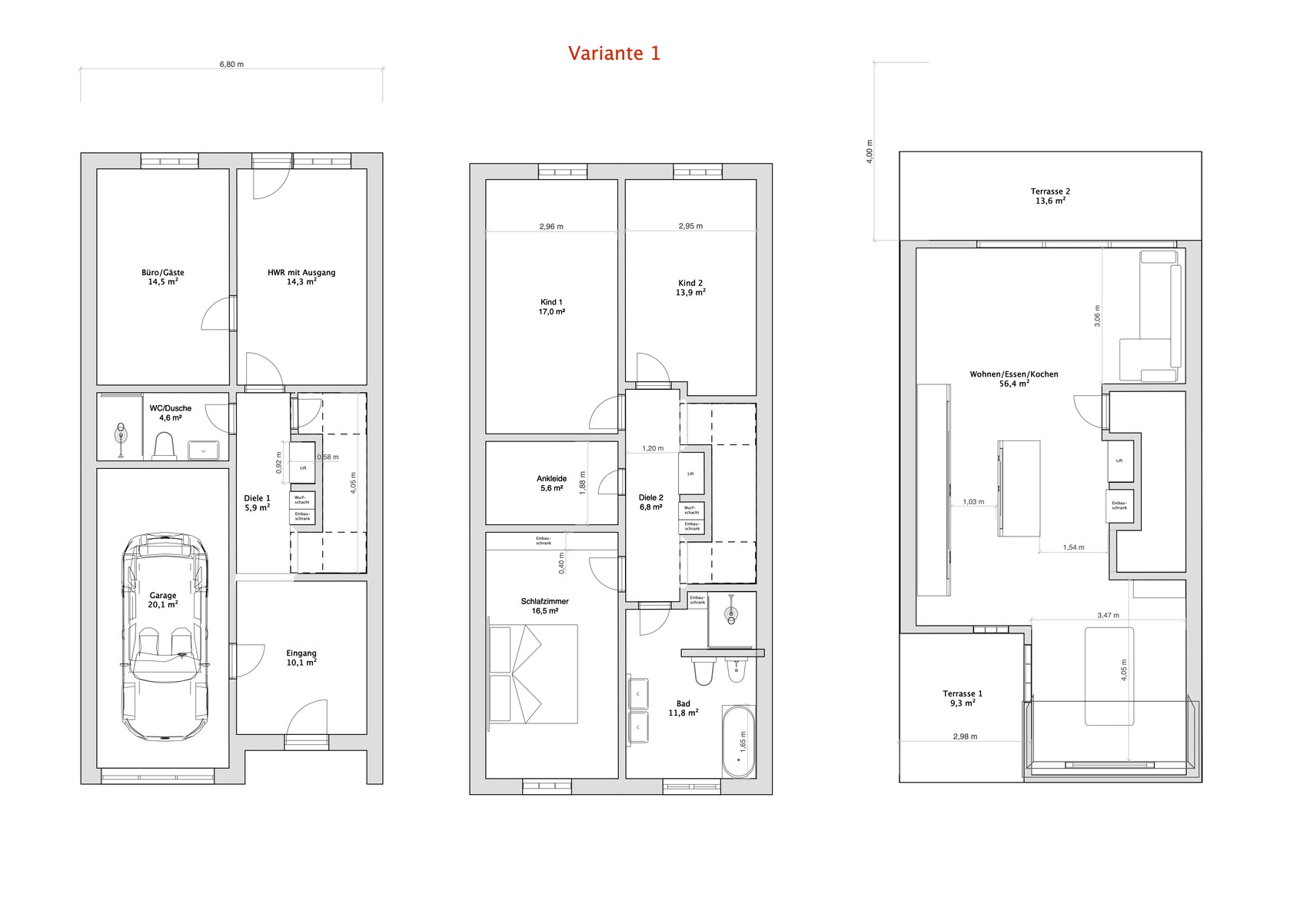

What would you change about the floor plan? I have spent a lot of time thinking about the staircase. I would like a staircase that has a landing on the turns, making it easy to walk on. This requires space. Unfortunately, there is no staircase available in my drawing software that meets my needs, so I have currently only indicated open spaces for the staircase. What do you think about the basic concept and room layout? As I said, the architect will improve the details later. I also keep wondering how much I should specify to the architect? I want them to think and come up with ideas as well. Also, I have created three variants for the 1st floor. They mainly differ in the width of the hallway. Which one do you think is best? Or is it all no good…?

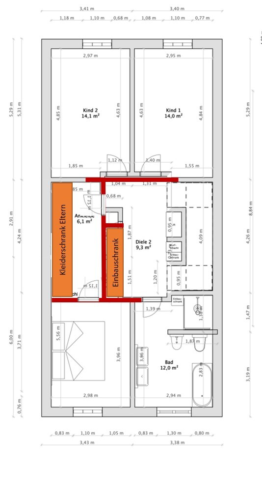

Myrna_Loy15 Jan 2022 14:11How are the neighbors constructing the individual floors? Having the bedrooms below the living areas is rather suboptimal.
Here is a version of option 2 with
- a walk-in closet serving as a pass-through room
- fewer wall (botched) corners
- a large built-in wardrobe in the hallway replacing a storage room (the vacuum cleaner and other items have to go somewhere)
Whether to add a shortcut door between the bedroom and bathroom for easier access is a matter of personal preference.
