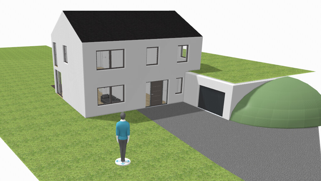

I’m on the go right now and can only reply briefly. But honestly, I think it’s really cool. 🙂I’m glad to hear that… I’ll keep it in my plans in case you have any further questions.So, here’s another idea: rotate the house only 45° (so it’s parallel to the street). Search for "K2Architekten Glueckauf Vier" on Google, they solved this very well. You would need to mirror the design so the entrance faces southeast, but I can easily imagine that working.
Since you already noted this as a rough estimate anyway: forget the garage! Have a carport near the street and a nice pathway to the house, possibly with a branch leading to the basement/ground floor and upper floor. You have so much space; this will feel much more natural and spacious. Of course, it also saves a significant amount of budget and eases access issues like elevation, driveway, and so on. And yes, you might get a few raindrops on you… but is a 10m (33 feet) walk really that bad?
I would probably avoid building a garage as well—only if it’s absolutely necessary.
I have now designed a slightly larger house with a 15sqm (160 sq ft) utility room plus 3sqm (32 sq ft) storage space on the upper floor and made some adjustments, but it still includes a garage.
Unfortunately, I can’t rotate the house. However, you can get an idea of the possible layout.
