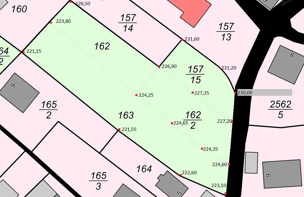

Plot size: 2200 sqm (0.54 acres)
Slope: South-facing slope, about 2.50 m (8 ft) within the building zone

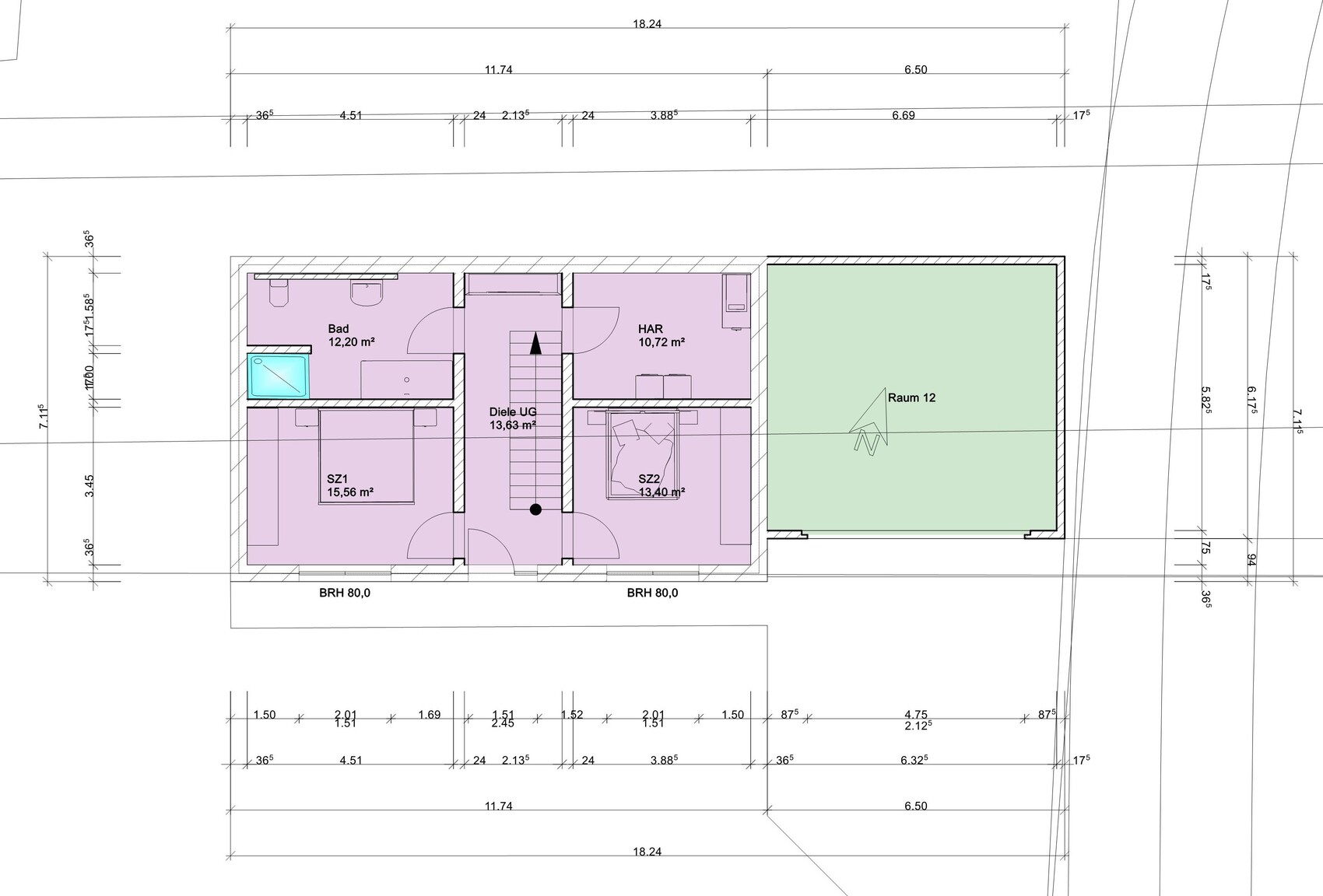

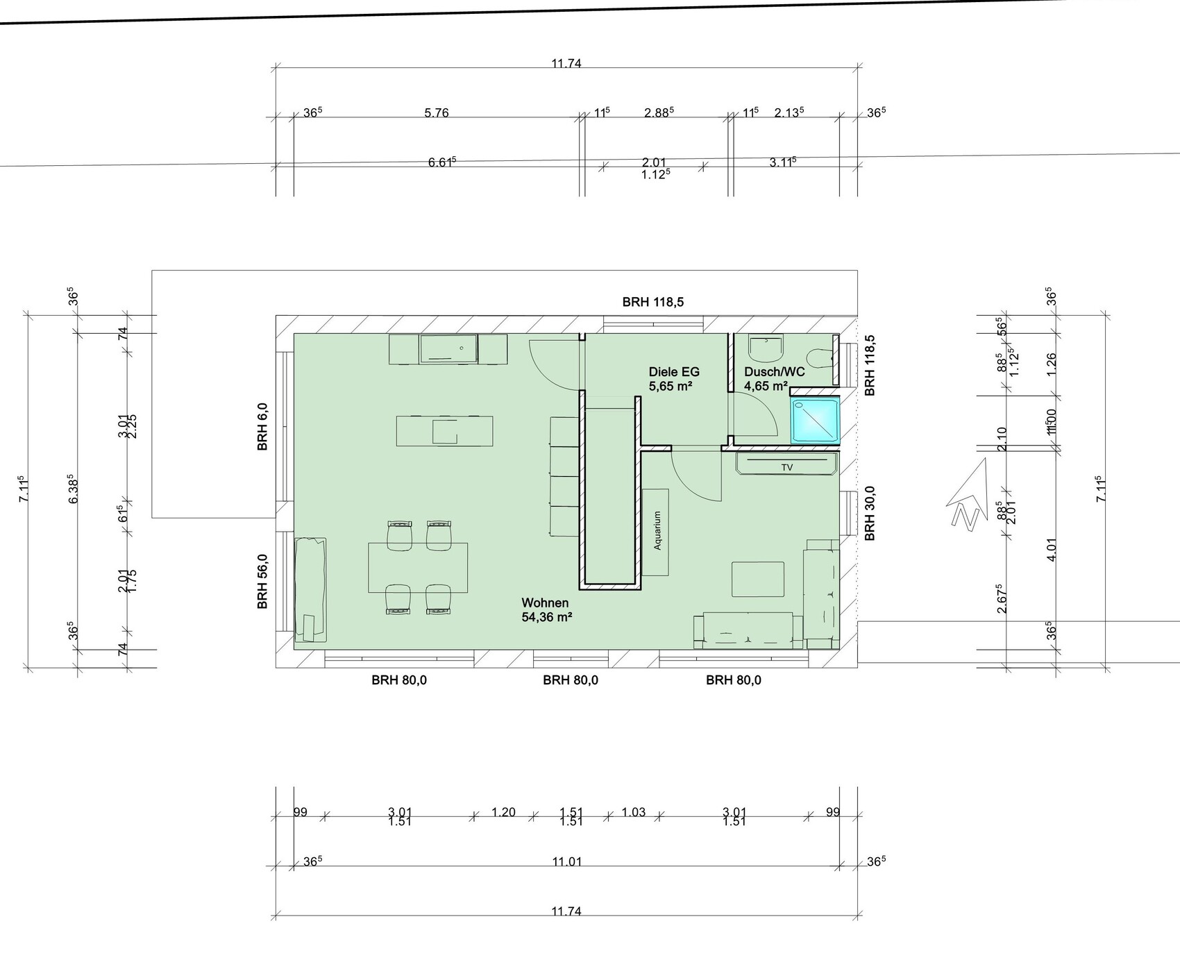

Because of this forum, the building shell is planned as it currently is. The lower residential floor is to be half embedded into the slope on the valley side. On the open side are the two bedrooms and the main entrance. To the right, the double garage, also partly embedded in the slope. In the slope are the utility room and a bathroom. The ground floor above is planned entirely for living, with terraces and garden access, plus a small bathroom.

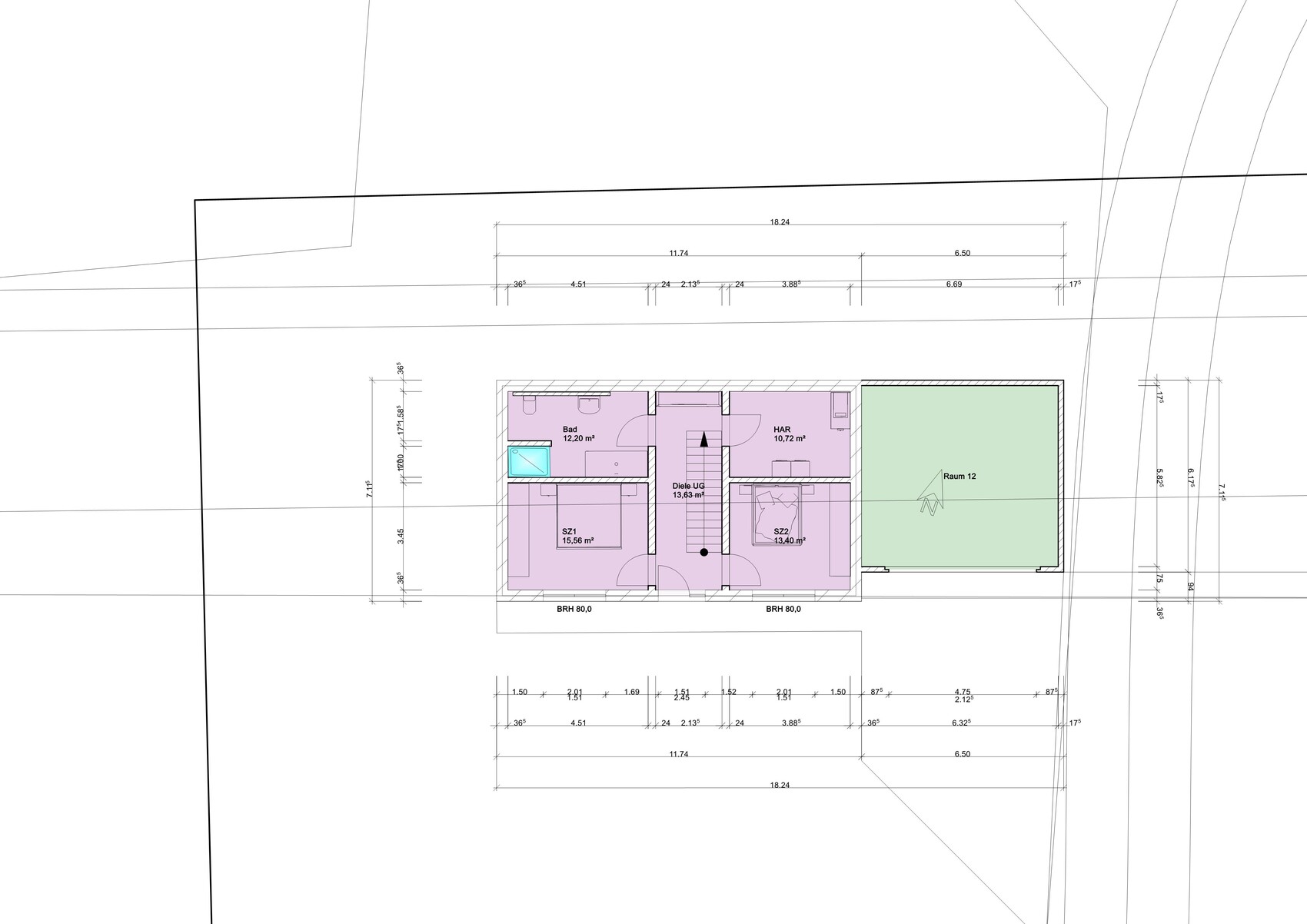

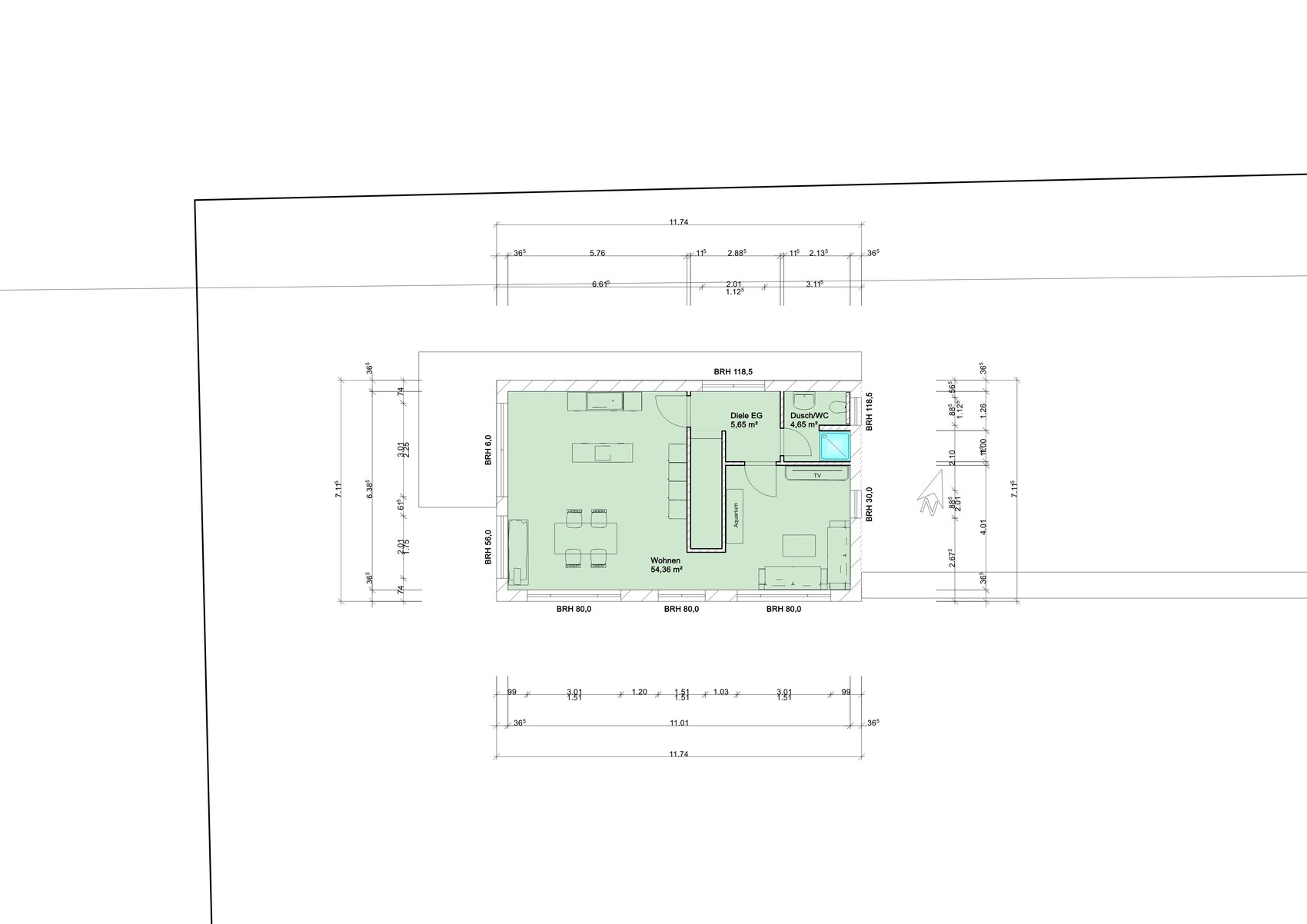

Pitigliano9 Dec 2021 19:25Draw the house on the plot plan, and make the site plan excerpt significantly larger – this way, it is not possible to clearly see the actual building envelope.
I wouldn’t necessarily build the garage attached to the house, especially considering the entrance visible at the top. The sleeping area and bathroom should be located away from the entrance. You can hear everyone coming and going – with an older child, there are often nighttime visitors. Also, you frequently go from the bedroom to the bathroom, sometimes accompanied. I wouldn’t want to run into a delivery person there. Walking barefoot through street grime in winter at night is also something to avoid.
Is it intentional that the terrace is situated uphill?
saralina8710 Dec 2021 07:17I would definitely place the entrance at the top as well. Just thinking about carrying groceries from the car to the kitchen every time... oh no. Otherwise, I like the idea!
hampshire10 Dec 2021 10:18I really like the clarity and simplicity of the design. Upon closer inspection, a few thoughts come to mind:
For me, it’s not about having the entrance at the bottom or at the top; I would build two entrances – one at the bottom for the adult son directly into his area, and one at the top for everyone else. However, this basic idea doesn’t quite fit with the lower floor plan, as a useful vestibule and the staircase would interfere with each other, unless you add a vestibule in front, which could disrupt the clean facade and would also increase costs.
An extra shower is a great feature when living with three people. The location in your house isn’t ideal, but it’s definitely manageable.
A utility room next to the bedroom worries me – make sure to plan for very good soundproofing. Noisy heat pumps (by the way, where exactly will the outdoor unit be placed?) and running washing machines are not exactly conducive to comfortable living.
Do you seriously want to sit in the living room facing away from the view on a sloped site? Surely this can be improved without giving up TV and an aquarium.
The kitchen and dining area is disproportionately large compared to all the other rooms. You essentially have an indoor terrace in front of the outdoor terrace.
The beautiful, well-structured, clear, and straight staircase comes at the cost of spatial inefficiency, making the living room and youth room unnecessarily small.
