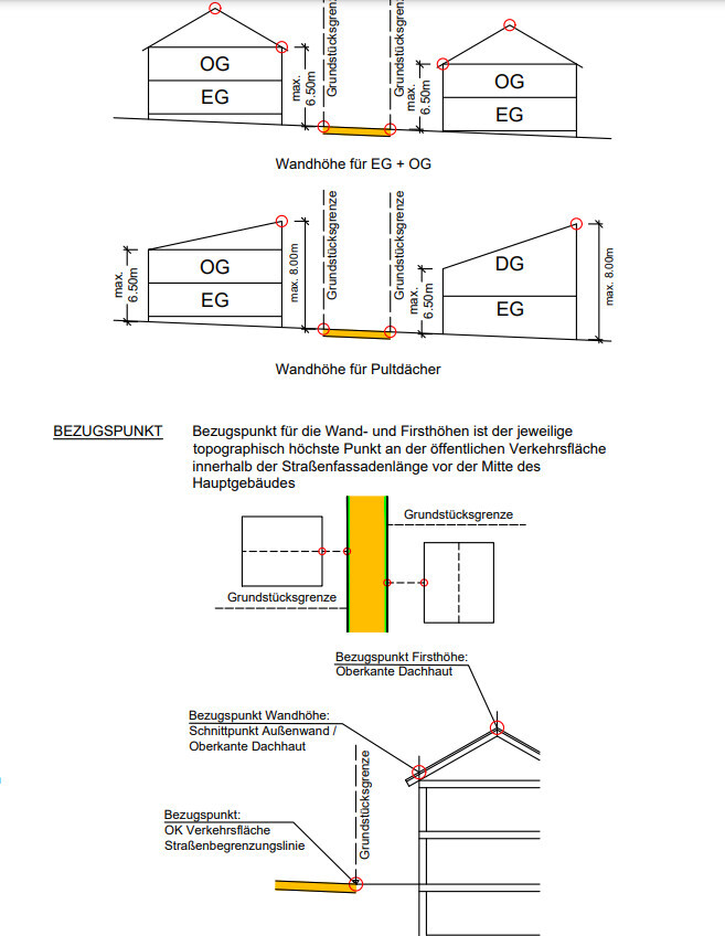

Plot size: 439m² (according to development plan – residential area not fully serviced yet, plot not surveyed. Front approx. 13m (43 feet) wide, widening to 17m (56 feet) after a curve, approx. 27m (89 feet) long)
Slope: Gentle north-facing slope, plot rises about 2.5m (8 feet) towards the south
Site coverage ratio: 0.3
Floor area ratio: 0.6
Building envelope, building line, and boundaries: See development plan excerpt. 3m (10 feet) setback from road, otherwise according to BayBO (Bavarian building code). Carports/garages may also be built outside the building boundaries (not at the rear)
Edge development: Fill or similar up to a maximum of 2m (6.5 feet) above traffic surface
Number of floors allowed: 2 full stories permitted
Roof style: Any allowed
Style: Detached or semi-detached house allowed
Orientation: As far as I can tell, we may choose the access road
Maximum heights/limits: Wall height 6.5m (21 feet) (“reference point is the respective topographically highest point at the public traffic area within the street facade length in front of the middle of the main building”). Ridge height 12m (39 feet).
Further regulations: The development plan feels very detailed, I don’t know what else might be relevant but can look it up. I believe I’m not allowed to share a link?!

K a t j a schrieb:
I really can’t imagine that right now. An entrance on the ground floor on the north side means no ground floor terrace, right? That’s what I have concluded, yes.
BUT: Your terrace will then be more or less on the upper floor. And your light wells will be quite deep. X
xMisterDx16 Feb 2023 11:17Are you sure it works that easily? Isn't the "main road" or the average height adjoining your property taken as a reference? And does the eave height really only apply to the street to which the eave is oriented?
hanghaus202316 Feb 2023 11:41H
hanghaus202316 Feb 2023 14:14K a t j a schrieb:
In my opinion, for corner plots, there is no complete definition. Is it allowed to choose which street to use as the reference point? I would boldly say yes and aim for the maximum height. That’s what I assumed. The maximum height isn’t the issue; it’s rather the knee wall height.
derdietmar16 Feb 2023 16:40Hello,
I cannot fully understand the suggestions made by previous posters. In my opinion, with the available budget for the overall project, it is not possible to build two stories plus a basement. The basement is an unnecessary cost driver.
For this plot, you can work well with the slope and still implement a typical Franconian architecture beautifully over two stories:
Advantages from my point of view:
- Garage on the east side, 4 m x max. 9 m (13 ft x 30 ft)
- Elongated main building connected to the garage and reaching the building boundary to the north, max. 8 m x approx. 14–15 m (26 ft x 46–49 ft)
- Ridge direction north-south
- Entrance and guest WC in the northeast
- Half-landing staircase, 180 degrees at the east wall, daylight from a floor-to-ceiling fixed window on the upper floor in the east wall
- Office/guest room in the northwest corner of the building
- Two children’s rooms in the west
- Children’s bathroom between the children’s rooms
- Technical room and utility room in the southeast (with a light well to the east behind the garage, no light trench), access to garage possible
- Children’s terrace in the west
- Bedroom in the northeast
- Dressing room and bathroom in the north/northwest
- Living, dining, kitchen in the west and south
- Terrace in the south/southwest
- Additional office(s) depending on roof pitch, without knee wall at a roof pitch of around 40 degrees
- Dormer at maximum length (1/3 of the ridge length) to the west, flat to emphasize the elongated building shape
- The best side of the plot is the west. With the building described above, there is at least 13.5 m (44 ft) to the next house. The neighbor to the south will likely move as far north as possible, thus "walling in" the garden.
- The garage roof can be used as a green roof if needed.
- Cost savings by having a living ground floor instead of a basement; excavation and terrain modeling costs should be similar to those of a partially buried basement.
- Living on two levels
- Two level terraces
