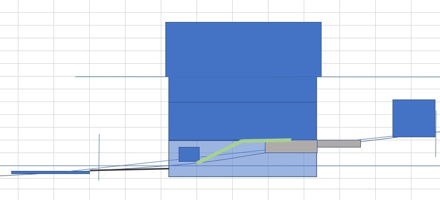

Plot size: 439m² (according to development plan – residential area not fully serviced yet, plot not surveyed. Front approx. 13m (43 feet) wide, widening to 17m (56 feet) after a curve, approx. 27m (89 feet) long)
Slope: Gentle north-facing slope, plot rises about 2.5m (8 feet) towards the south
Site coverage ratio: 0.3
Floor area ratio: 0.6
Building envelope, building line, and boundaries: See development plan excerpt. 3m (10 feet) setback from road, otherwise according to BayBO (Bavarian building code). Carports/garages may also be built outside the building boundaries (not at the rear)
Edge development: Fill or similar up to a maximum of 2m (6.5 feet) above traffic surface

Basement and floors: Due to the slope and a need for plenty of (storage) space, we considered a basement (facing north and partially above ground), plus 2 full floors. Knee wall (kniestock) 1.6–1.8m (5–6 feet) if possible. Preferred roof type is gable roof, currently planned with a 25° pitch.

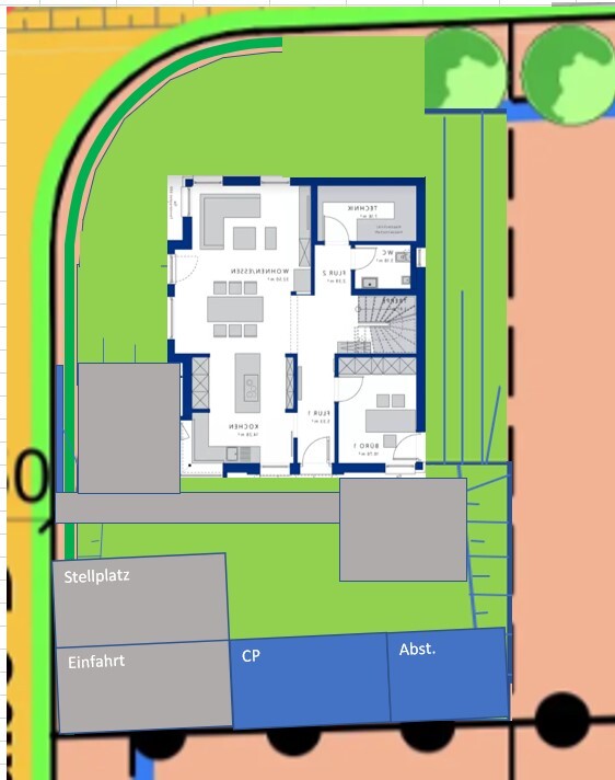

Garage, carport: No garage needed, a carport with storage space for 1 car (+ space for garden tools and bikes, possibly with preparation for electric car charging) would be great

- We would like to modify the shown floor plans as follows (see hand-drawn sketches): In the basement, largest possible windows (light wells or shafts possible?) and 2 rooms as a living basement. On the ground floor, entrance from the east side, large hallway, pantry. On the upper floor, the children’s rooms should face south, the master area north. Generally, as many large windows as possible, especially in living spaces.
- We would like the carport including the shed described above to be located eastwards up to the plot boundary, preferably the full possible 9m (30 feet) length and as wide as possible when the house is sited as close as possible to the road on the west side. However, with the front door on the ground floor, the driveway to the carport would slope upward. The carport should also provide the canopy over the front door.
Who created the design: By us based on the “Evolution139” by Bien-Zenker plus “grid extensions”. Exterior dimensions based on current calculation 9.41m + 11.92m (31 feet + 39 feet).

- We are unsure about the best layout for the entrance area including wardrobe/guest toilet/pantry. Should the hallway’s access to the living area be aligned with the front door or the stairs?
- As currently planned in our heads, only the guest toilet and master bathroom are stacked vertically. Children’s bathroom and utility room are in different areas – will this work?

The floor plan screenshots come from the catalog or a preliminary plan from the seller. The hand-drawn floor plans reflect our ideas for the layout and the plot arrangement. I haven’t added windows yet.
With our ideas/wishes (and hopefully input/tips from you) the next step is the architect. Our architect so far does not seem to want to be very creative – if we give him a finished plan, he will probably just use it?! Hence, beforehand we ask for your opinions.
What is the most important/fundamental question about the floor plan, summarized in 130 characters?
- Does the plot layout make sense? Are there better alternatives?
- Are the carport and driveway feasible (incline? space by front door?)
- Can the bathrooms be located as per the sketches?
- Is a living basement financially possible?
- How much space is needed for light wells in front of basement windows?
- Ideas for floor plan variations or obvious mistakes?
