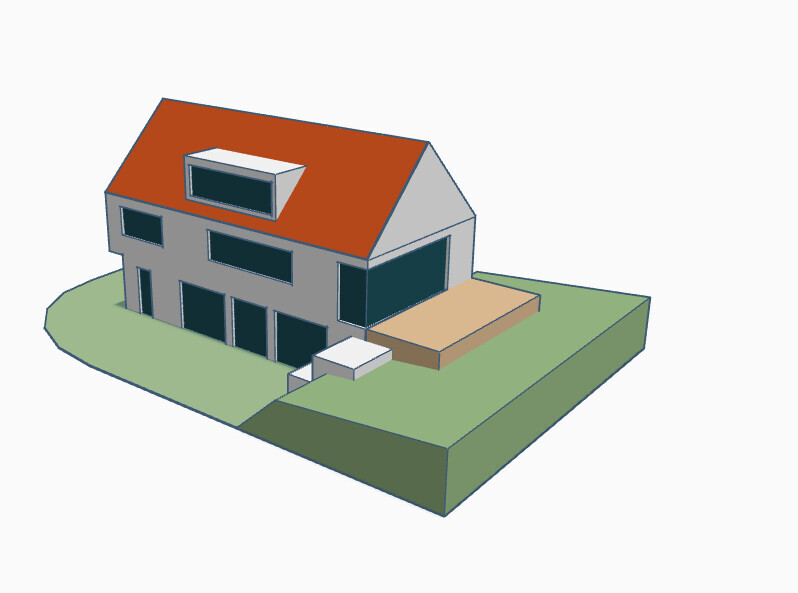

derdietmar16 Feb 2023 16:51H
hanghaus202316 Feb 2023 16:58@derdietmar You probably didn’t read the original poster’s requirements. Of course, what you’re suggesting is possible. Unfortunately, the original poster already has a contract with the prefabricated house builder.
Shall we just ignore that the road on the west side has a 10% slope?
derdietmar16 Feb 2023 17:06Hello,
on the west side, the plot obviously needs to be retained. The house could overall be built a bit taller, if the wall height can also be measured on the west side. You can see this on the terrace in the illustration.
Adjustments to the prefabricated house would need to be discussed, as Bien-Zenker also supports custom planning to my knowledge. In terms of cost, it would also be cheaper than a basement.
hanghaus202316 Feb 2023 19:12K a t j a schrieb:
I don’t see any financial difference compared to the basement option. Basically, you only save the knee wall masonry. But you have to excavate the entire site and also need to shore up the excavation. I would even estimate that this is more expensive. It can’t be that much more expensive. The windows in the basement on the west side don’t have to be floor-to-ceiling. 😉 There are definitely some ideas that could be integrated.
