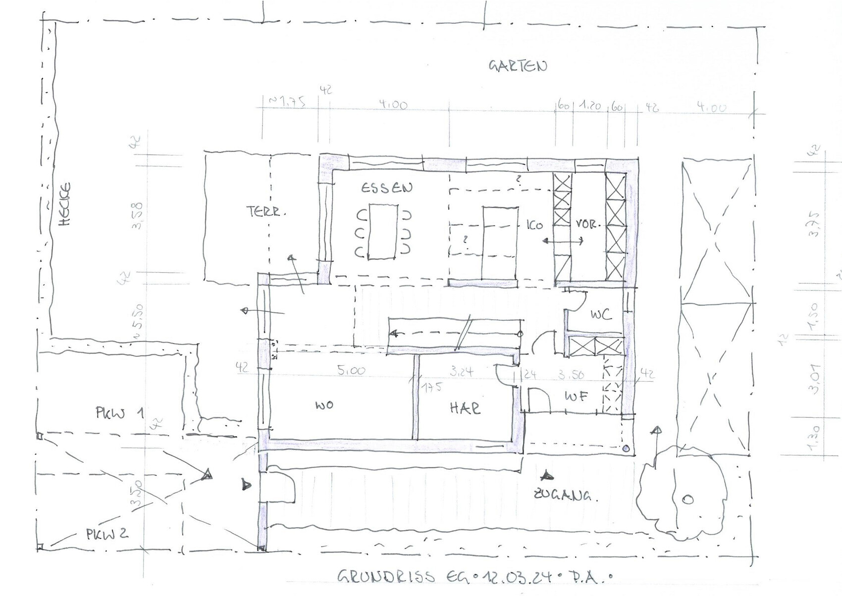

Cubus3f
12 Mar 2024 22:26
Good evening dear house building forum members,
after we shared our wishes again with the architect, we received a completely new design. We really like it 🙂
We moved the garden to the south and swapped the living room with the kitchen, among many other changes.
Do you see any potential for further improvements?
Thank you very much in advance for your feedback.
