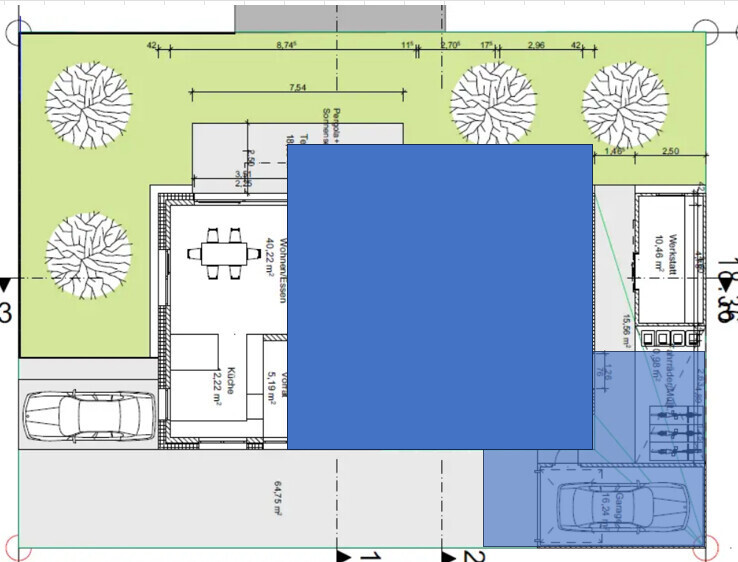

What do you particularly like? Why? Workshop at the back, bicycle stand, size of children’s rooms, master bedroom area on the north side, staircase option 1
What do you dislike? Why? Very small garden, especially between the terrace and neighboring house

Do you have suggestions on how we should plan the living/dining/kitchen area to create an L-shaped layout? There should be space for a kitchen island (2.35m x 1.1m) (7.7 x 3.6 feet). The staircase should be placed centrally in the house to improve the layout of the upper floor rooms.
Any other improvement suggestions?

Option 1:
Ground floor:
- Bad: Kitchen too small, freestanding kitchen island measuring 2.35m x 1.1m (7.7 x 3.6 feet) does not fit, entrance to living area too narrow
- Good: spacious hallway, open staircase with landing
Upper floor:
- Bad: Access to children’s bathroom through utility room, entrance to master bedroom through dressing room, makeup table in master bedroom instead of dressing room
- Good: spacious master bathroom, size of utility room and children’s bathroom
Option 2:
Ground floor:
- Bad: no staircase landing, small entrance/hallway, entrance to living area directly from the foyer
- Good: large kitchen
Upper floor:
- Bad: utility room too large, entrance to sleeping area awkward (one walks into a wall), makeup table in master bedroom, master bathroom too small
- Good: separate entrance to utility room

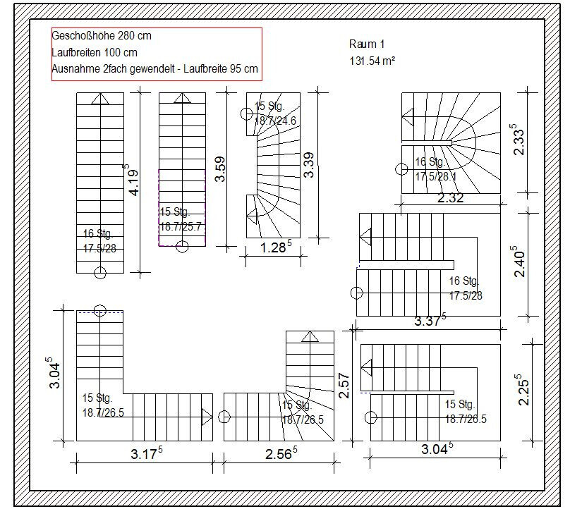

K a t j a schrieb:
I’m also curious about the floor-to-ceiling height. Your platform staircase has a length of 3.46 m (11.35 ft), which is quite substantial. For a house of this size, it seems very dominant to me. Usually, about 3 m (9.84 ft) is needed with floor heights around 2.90 m (9.51 ft). I have to disagree here ... as always, my previously created stair design example
Floor height is "only" 285 cm (9.35 ft) ... I find the example with 337 cm (11.06 ft) comfortable to walk on.

hanghaus202318 Feb 2024 11:19Is there a development plan with a building envelope (building window)?
hanghaus202318 Feb 2024 11:57Cubus3f schrieb:
We prefer it sunny and are willing to accept the noise during rush hours for that. Sitting on the west side for this reason.K a t j a schrieb:
Ah, okay. But why not just choose the south side completely then?Then I would place the bicycles and trash bins along the boundary next to the street.https://www.instagram.com/11antgmxde/
Cubus3f schrieb:
We actually like a bay window. However, we’re unsure about the additional costs involved.
We want to keep the ground floor offset for weather protection. The ground floor offset here reduces the usable width of the house, which is already limited. The bay window only adds the extra effort needed to insulate the overhang, starting with the “isolation baskets” (TM).
