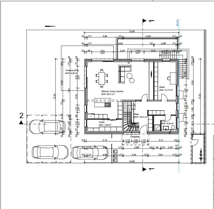

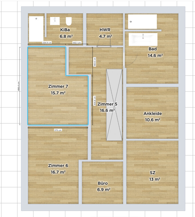

Cubus3f
Basically, I consider this an improvement. However, the upper floor has been somewhat neglected. What bothers me most are the bathrooms above the living room and the associated, also drawn, waste pipes running right through the middle of the room. Additionally, the utility room is extremely small. I’m afraid I would start over again there.
I would probably make the restroom on the ground floor accessible from the entrance hall, as otherwise it feels too close to the kitchen/dining area for my taste.
Really fascinating in a positive way.
I have to admit, it’s challenging to fully grasp this custom design when you’re mostly used to seeing the usual standard layouts.
On the ground floor, I would have considered an open space that then becomes a children's bathroom on the upper floor. … That would be the downside: bathrooms located above the living area.
Am I correct in understanding that there is a wall at the front and you have a courtyard? In that case, I would also suggest adding an extension from the living room side—a narrow patio door.
Possibly, the children’s bathroom and the office could be swapped, as well as the master bathroom and the bedroom? The room sizes would need to be adjusted accordingly.
By the way, I really like the overall structure.

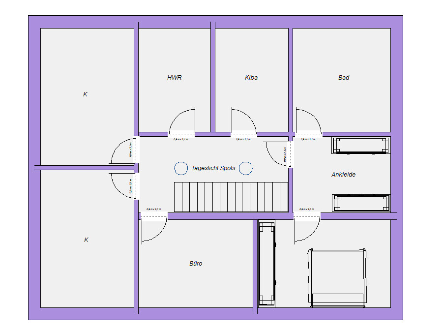

Maybe the kids' bathroom and the office could be swapped, as well as the master bathroom and bedroom? Adjust the room sizes accordingly. What I meant was to keep the wet rooms on the left side of the plan and rather place them more on the right side where it fits better. Move things downwards on the plan as needed so that the utility room has enough space and the office (on the left side of the plan) doesn’t become too small.
Here is an alternative layout for the upper floor to remove the bathrooms above the living room and make better use of the rooms, in my opinion.

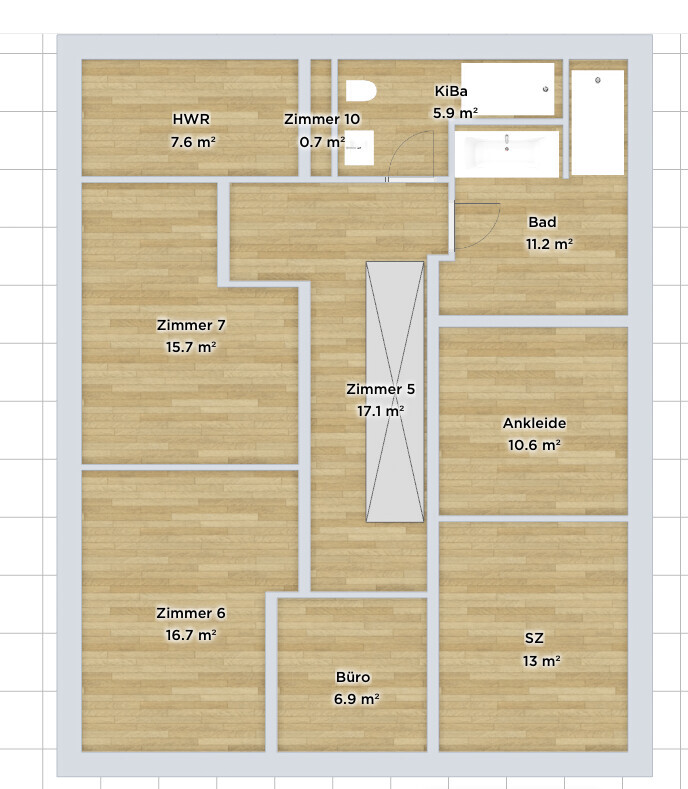

The children's bedrooms occupy the south gable, giving both rooms the chance for windows on two sides and plenty of natural light. Ideally, the bathrooms would be connected via the pantry behind the kitchen. Whether this still works with the kids’ bathroom would need to be checked. The utility room is similar – only "thin" pipes run here, which could possibly be extended somewhat. The bedroom is located on the cool north side, and the office has to take what remains.
Now, one could also consider making the hallway narrower again and incorporating the setback into the children’s room. These are minor details that could easily be implemented. Without the elevations, however, it’s hard to say if it’s worth it.
hanghaus202314 Mar 2024 14:27@K a t j a did you move the staircase or plan it shorter? The one designed by the architect is about 4.5 meters (15 feet) long.
hanghaus2023 schrieb:
The one from the architect is about 4.5 meters (15 feet) long.Yes, but somehow his house width doesn’t match that.Quick & dirty:
