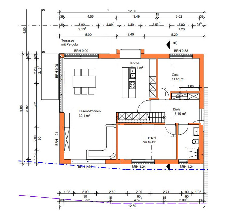

Hello dear community,
We are in the final stages of planning our floor plan and would like to hear your opinions on our design and any suggestions for improvement. When you look at a plan for the hundredth time, it’s easy to lose perspective...

Basically, we are satisfied with the floor plan. What I am still not completely happy with is the exterior appearance. I am concerned that it might look too much like a barrack.

We had several wishes that influenced the design:
- Large hallway window upstairs
- Window seat in the kitchen (we don’t want a bar counter with stools)
- Hidden door from kitchen to pantry (not shown in the current plan but possible and already discussed with the kitchen planner)
- Garden should be as large as possible
- Is the living room big enough? (just the TV area)
- Will the hallway on the ground floor be too dark?
- Is 51 cm (20 inches) depth enough for a wardrobe?
- Any other general suggestions for improvement? What do you think is bad or would you do differently?
Thanks a lot in advance!

The guest room will actually be used as a guest room... or more likely, the office will be downstairs and the guest room upstairs. And the guests will then pursue a hobby in the guest room?
Here’s a suggestion on how to create a more spacious kitchen without any tight spots. You can install additional cabinets for dishes and such under the stairs. The wardrobe cabinet can be enlarged by reducing the size of the guest room, which isn't necessarily needed. The living room layout and the windows have been adjusted accordingly. I would find this much more appealing than the narrow kitchen with a dead end and the oddly shaped hallway. Upstairs, you can also initially use Room No. 3 as a playroom if there are only two children.
