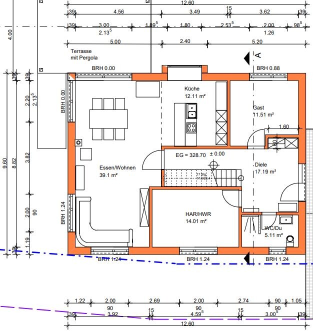

Hello dear community,
We are in the final stages of planning our floor plan and would like to hear your opinions on our design and any suggestions for improvement. When you look at a plan for the hundredth time, it’s easy to lose perspective...
Here is the questionnaire first:
Plot size: 776 sqm (8,356 sq ft)
Slope: no
Site coverage ratio: 0.3
Floor area ratio: 0.6
Building envelope, building line, and boundary: see blue line
Adjacent buildings: no
Number of floors: max. 2 full stories
Roof type: no specifications
Style: no specifications
Orientation: no specifications
Maximum heights / limits: eaves height 6.50 m (21.3 ft); building ridge height 10.50 m (34.4 ft)
Other specifications: none
Homeowner Requirements
Style, roof shape, building type: gable roof, 22 degrees
Basement, floors: 2 full stories, no basement
Number of people, age: currently 2, both around 30 (planning for 4)
Space requirements on ground and upper floors: as in the floor plan
Office: family use or home office: both
Guest bedrooms per year: not relevant
Open or closed layout: open
Number of dining seats: at least 6
Fireplace: yes, currently planned
Music / stereo wall: no
Balcony, roof terrace: no, only garden terrace
Additional wishes / special features / daily routine, also reasons why something should or should not be included
Who designed it: custom architect design based on our drawings
Preferred heating system: air-source heat pump with underfloor heating and photovoltaic system (KfW 40+)
What do you like most? What do you not like? Why?
Basically, we are satisfied with the floor plan. What I am still not completely happy with is the exterior appearance. I am concerned that it might look too much like a barrack.
If you absolutely have to give up on certain details / features,
- could you do without: possibly the fireplace (probably doesn’t make much sense with KfW 40+)?
- can you not do without: large upstairs hallway (because of the beautiful view), open living/dining area, walk-in closet
We had several wishes that influenced the design:
  • Large hallway window upstairs
  • Window seat in the kitchen (we don’t want a bar counter with stools)
  • Hidden door from kitchen to pantry (not shown in the current plan but possible and already discussed with the kitchen planner)
  • Garden should be as large as possible
  • Is the living room big enough? (just the TV area)
  • Will the hallway on the ground floor be too dark?
  • Is 51 cm (20 inches) depth enough for a wardrobe?
  • Any other general suggestions for improvement? What do you think is bad or would you do differently?
Scale of the design is 1:100.
Thanks a lot in advance!

So, we had the design revised again and would like to ask for further suggestions.
Some preliminary notes on the design:
Regarding the ground floor:
- We have swapped the kitchen and living room here as well. I am not sure whether the kitchen storage space is now sufficient.
- The window seat should no longer remain in the kitchen as in the original design but shift eastward between the living room and dining area.
- The guest toilet and utility room have been exchanged.
- The utility room has become slightly larger; however, the pantry has been eliminated. I am still bothered by the wall projection that this creates in the living room. I need to clarify whether this was specified by the structural engineer.
- The staircase has been moved to the other side.
- The wardrobe niche has become deeper. Additionally, due to the changed entrance area, there is still space for placing furniture.
- The staircase will also serve as additional storage space for coats and shoes with the help of a built-in cabinet.
- The fireplace will not be installed in this location.

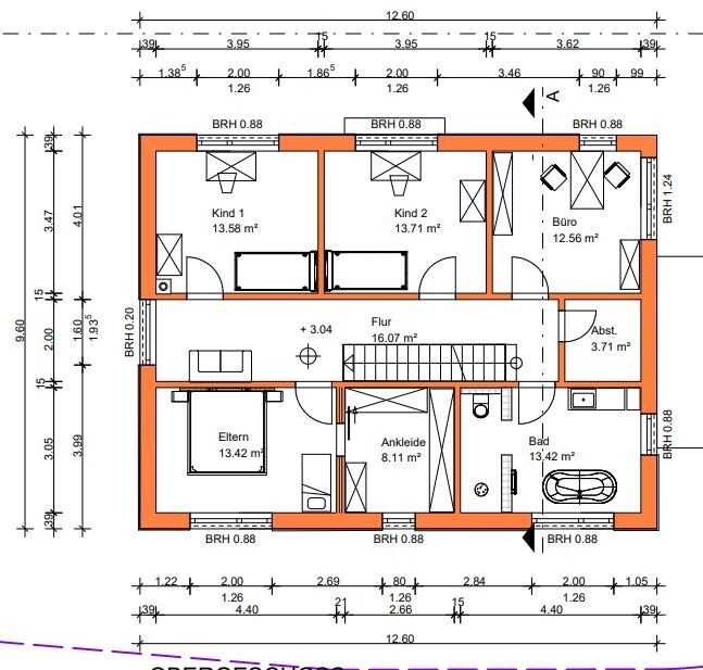

Regarding the upper floor:
- We specifically requested the large hallway, and it will be implemented accordingly. Therefore, no further "criticism" is needed here.
- The staircase has been moved to the other side so that the awkward small hallway near the office disappears.
- We are still considering whether to give up the office and allocate the space to the two children’s rooms. However, this would leave no room for a possible third child.

Alessandro
8 Nov 2021 14:47
Do you always have that many guests, or is that why you have both a guest room and an office?
