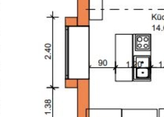

- Large hallway window upstairs
- Window seat in the kitchen (we don’t want a bar counter with stools)
- Hidden door from kitchen to pantry (not shown in the current plan but possible and already discussed with the kitchen planner)

Kreisrund30 Oct 2021 09:33Why did you orient the living room and kitchen to the east instead of the west towards the evening sun?
Kreisrund30 Oct 2021 09:36ypg schrieb:
I need to say something again about the window seat: is it really comfortable to sit in front of kitchen cabinets? You’re not looking at the countertop but at cabinet doors – I think this is a case where imagination played a trick on you (like with the 2-meter (6.5-foot) hallway...) No one will sit there...We have a kind of window seat in the kitchen, and it is one of the most frequently used seating spots in the entire house.M
Myrna_Loy30 Oct 2021 09:56Kreisrund schrieb:
We have a kind of window seat in the kitchen, and it is one of the most frequently used seating areas in the whole house. Even at a distance of 90cm (35 inches) from a kitchen island?
Kreisrund30 Oct 2021 10:05No, not like that. But I think the crucial question is how high the seating surface is. In our case, it is at a standard sitting height, and when you sit there, you don’t look sideways at the cabinets but rather look straight down at the countertop or mainly outside.
However, I would recommend taking a closer look at the kitchen layout. There are very good specialized forums for that. I'm not sure if they can be mentioned here...
Kreisrund schrieb:
Why did you orient the living room and kitchen to the east instead of the west toward the evening sun? The living room is actually facing west…
However, I would also swap the kitchen and living room. You need a lot of light in the evening to prepare dinner, good natural daylight.
I would also place the terrace more on the west side.
hanghaus200030 Oct 2021 10:54ypg schrieb:
Definition of shack: lightweight, low-profile, usually modular [wooden] structure for temporary accommodationWe had a two-story site office. The resemblance is striking. Of course, it didn’t have windows with seats or floor-to-ceiling patio doors. When I look at the view with the window seat, I stick to my opinion.
