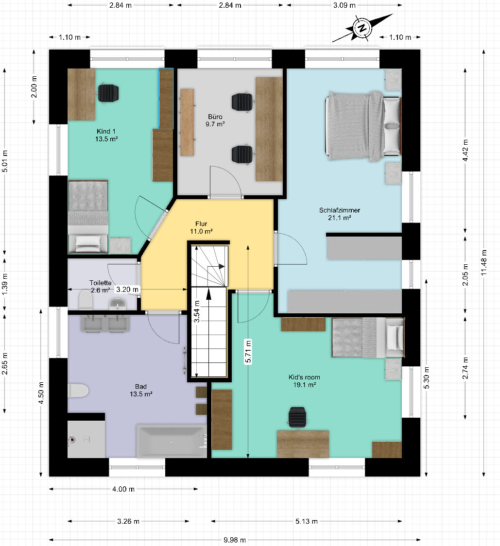

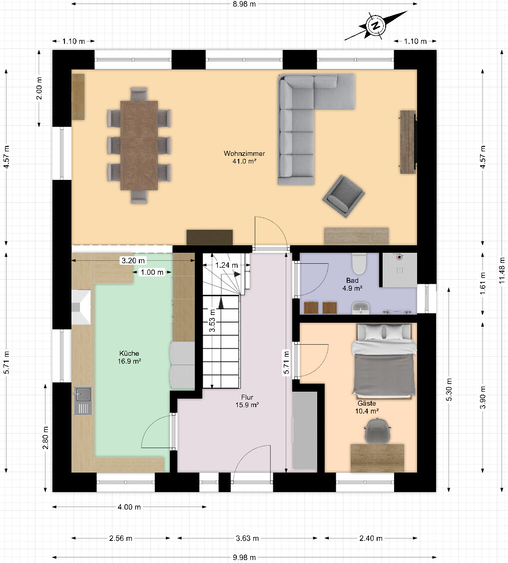

saralina8722 Jun 2020 08:26Your new floor plan is already much better! However, the staircase is far too small: 2 m x 1.60 m (6.6 ft x 5.25 ft) is never going to be enough. More like 2.2 m x 2.2 m (7.2 ft x 7.2 ft). Because of this, the ground floor won’t work as it is. There would be space on the upper floor though. I also don’t like Children’s Room 1. I like Gussek houses, but unfortunately the Regnauer one doesn’t fit well. The living room is not facing the garden and the entrance is on the side.

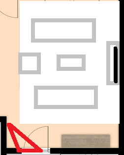

Regarding the sofa position: everyone is different. For example, I like to sit on the sofa with my morning coffee looking out into the garden. Or in the evening with a glass of wine or chatting with friends. Thanks to the lighting, the garden still looks great even after dark. For me, having the sofa facing a wall and with its back to the window or the room would be a no-go. Then it only really works for watching TV, and it’s no surprise that it doesn’t get used otherwise. You could also put a narrow room divider between the dining and living areas and mount the TV there? Someone planned it like that recently, maybe @saralina87?

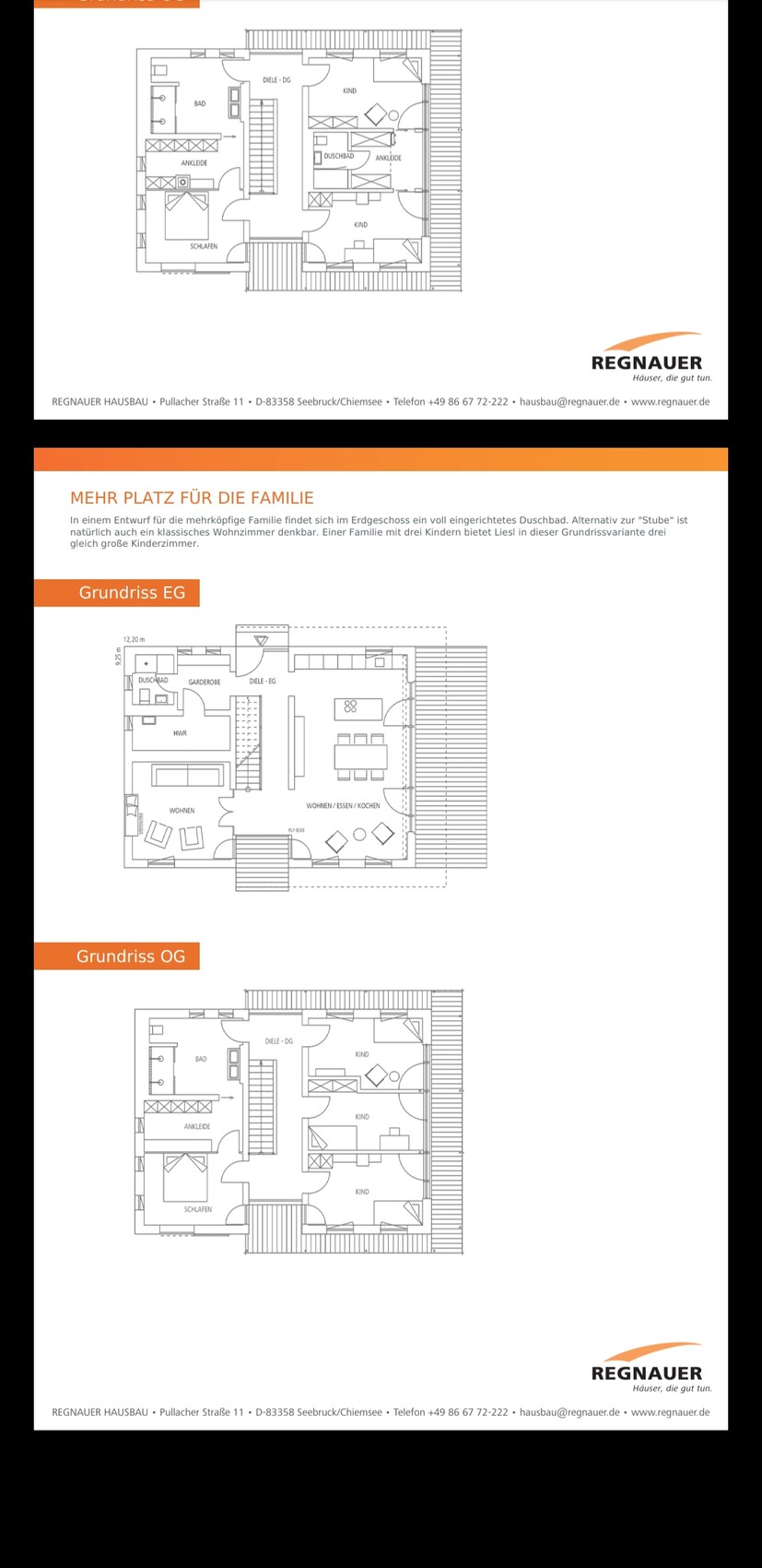

saralina8722 Jun 2020 09:07Regnauer could work if you place the kitchen in the living room indicated there and move the guest room to the basement (which I also find somewhat "wasted" otherwise), but that’s a matter of personal taste.

I’m not so fond of the Regnauer design; we prefer an entrance from the front, and we don’t want the bedroom facing the street. The kids’ rooms there are also very narrow.

Your new floor plan is already much better! However, the staircase is way too small: 2 m x 1.60 m (6.5 ft x 5.25 ft) is never enough. More like 2.2 m x 2.2 m (7.2 ft x 7.2 ft). Because of that, the ground floor won’t work as is. There is space upstairs though. I also don’t like children’s room 1. The staircase is now 2 m x 2 m (6.5 ft x 6.5 ft). I think 2.2 m x 2.2 m (7.2 ft x 7.2 ft) could fit well too, that would only require moving a few walls by a few centimeters (inches).

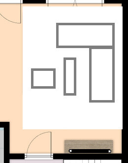

The sofa placement is indeed a bit tricky. We don’t want to place the TV in the middle of the room and would probably feel most comfortable with the arrangement shown in the sketch. Having both a view out the window and a clear TV line of sight is difficult to achieve at the same time.
