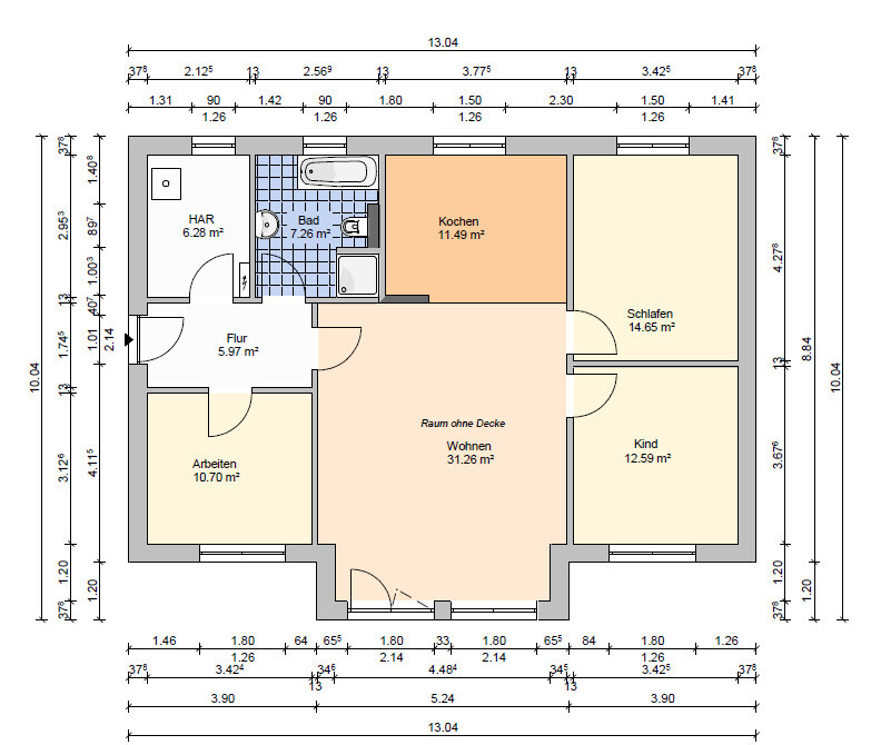

after taking some time to use our plot provisionally, we now want to build a house on it. It will serve as a second home while the children are small and later as the main residence for us parents. The plot rises by 3 meters over the first 19 meters from the street, see site plan. After that, it is flat. The house is planned to be located there. A large garage will be built into the hillside at the northern boundary.
I would appreciate any advice on possible errors and optimizations. In particular, common modular dimensions for the kitchen units (facing each other). I want to optimize the connection to the garden. The facade is made of larch wood, and the ceiling in the living room is open.

11ant7 May 2025 00:45
Patrick. schrieb:
One of the goals in the planning was to minimize circulation areas. That’s why there are practically no hallways.
This is a typical aim of non-professional planners; unfortunately, it leads into a trap (the circulation area paradox): the actual space used for circulation often increases when trying to eliminate "hallways."

I would first question the targeted 280,000, definitely not with the garage built into the slope. That alone will cost a fortune. Or require a lot of DIY work...

Arauki11 schrieb:
I find it difficult to comment appropriately on this floor plan. You currently live in a house with children, and this new, smaller house is intended for old age but also still for children. As a couple, you could live much more openly and would only need to cover both of your needs and habits. But as it is, it has to work as a holiday home and for then teenagers or young adults, whose behavior you can’t predict or how your life with them will be. I can rather imagine a solution where youth rooms or guest rooms even have direct outdoor access, and where I don’t have to share my private space with my spouse in old age in an even smaller area than before, having to tolerate their justified peculiarities. A home in old age should fit me and my partner, and possibly have space for visitors (children, friends, etc.). In my opinion, this floor plan tries to meet too many needs and thus already runs into problems with simple things like a wardrobe or maybe a more spacious utility/storage room.
You are exactly addressing the core issue that kept us from building for years. It is a conflict of objectives that currently cannot be resolved. The alternative would be to build later. Whether one still wants to do that, can afford it, and is willing, is another question. We currently live in a major city apartment of similar size. So I don’t worry about privacy. Initially, I wanted to plan with three rooms. That was strictly discouraged because it would be very disadvantageous for a possible resale (worst-case).
Have you tried furnishing the open living space? A square room is difficult to zone into TV area and dining area. I would probably rotate the house spontaneously. Otherwise, I think the symmetry at the bottom of the plan and the lack of parental privacy do not benefit the design.
The symmetry is probably the second amateur mistake. It results here from the design with the central dormer in the gable roof, which first enables the open living space. I have also noticed the furnishing problem. What do you mean by parental privacy? Why would you rotate the house? I intend to have the living room look out to the large garden on the east side. Also, this would create an east-west orientation of the roof surfaces for photovoltaic panels.
This is a typical amateur planner’s goal, unfortunately leading into a trap (the circulation area paradox): the effective area used for circulation paths even increases when you try to save on corridors. Yes, it is impractical — where does your current primary daily living take place, if you don’t yet know?
I am open to counterproposals. Would a niche for a built-in wardrobe be useful?

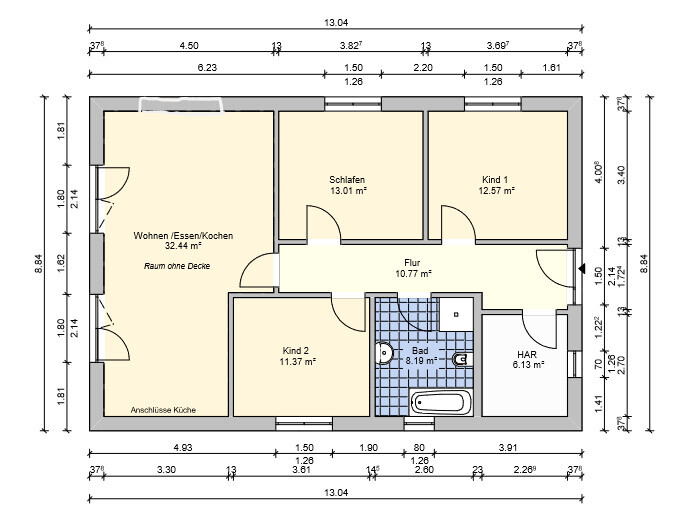

Attached are two designs we have already discarded. Maybe they have more potential than initially thought.

Floor plan of a house with living room, bedroom, bathroom, hallway and kitchen
Floor plan of a multi-room house: living, cooking, sleeping, child, work, utility/storage room, bathroom, hallway

7 May 2025 09:04

7 May 2025 09:05
Patrick. schrieb:
The mechanical ventilation system with heat pump should take up less than 1m² (11 sq ft).
Who says that? Technology today is definitely more compact, but you still need ducts that connect the unit with the wall and have to be accessible. Also, a technician needs room to work around it, a hot water storage tank takes up volume, and so on.

Patrick. schrieb:
What do you mean by the parents’ privacy?
If someone is sick in bed with diarrhea and the other is having guests, you have to pass by the guests to reach the bathroom. Or you have visitors watching a game while the partner wants to do wellness activities in the same living area—they run into each other’s space. Good planning avoids this by zoning and a hallway helps. Or a visual separation. The goal is to have better arrangements than in an apartment.
Because a transverse wing dominates the plot and divides it into two disconnected parts.
Patrick. schrieb:
I am open to alternative suggestions. Would a niche for a built-in closet make sense?
List what the house needs first, and then plan accordingly.

nordanney
7 May 2025 10:14
Patrick. schrieb:
Initially, I planned with 3 rooms. This was strongly discouraged because it is very disadvantageous for a possible resale (worst-case scenario).
I will only address this point.
With the floor plan—access to the bedroom and child's room through the living room, as well as access to the bathroom (from the bedroom) through the living area and entrance hallway (great when you want to quickly use the toilet at night)—you will likely exclude 90% or more of potential buyers.
This is really disastrous for resale. No one wants to buy a home expensively like this. You may want to live this way, but that makes you a definite exception.
