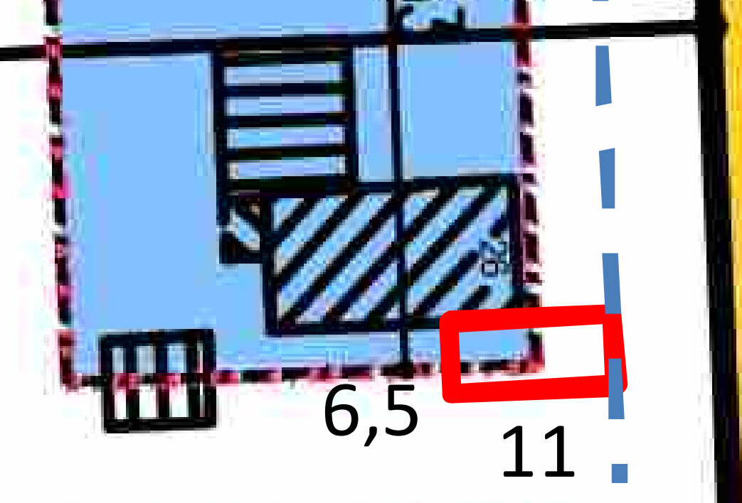

I have a plot where I am allowed to build a house with a maximum size of 6.5m by 11m (21 feet 4 inches by 36 feet 1 inch). One single-story building is permitted (gable roof, roof heights currently not limited). So, it won’t be a huge house, but of course, it should have everything you need.
Since we need to excavate 1.5m (5 feet) anyway, I’m considering building a basement as a waterproof concrete shell (“white tank”). This way, the boiler room as well as storage space can be located underground.
Because the house (especially the ground floor) should be planned to be accessible for people with disabilities and the elderly, I’m thinking of including a bathroom, kitchen, living room, and bedroom all on the ground floor.

First of all, thank you very much for the quick responses.
This concerns a plot with a house where I live with my family. Now, an extension is planned, as shown in the attached picture. Originally, we planned to build an 8.5 x 8.5 m (28 x 28 ft) structure, but the local authority did not approve it that way and said it will only be permitted as shown in the picture.
It is unfortunate, but better to have some approval than none at all, so we prefer to find a compromise.
My parents, who are over 70 years old, will move in. Since you never know, I thought it would be good to plan it to be senior-friendly and accessible.
I hope this helps a bit more...
Thank you very much and best regards
