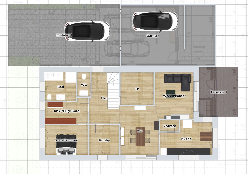

Second draft by the architect
Desired is a bungalow with double garage. Separate kitchen with enough work surface, small pantry. Living and dining rooms. An extra room for crafting/ironing or later use as a bedroom for a caregiver. Bathroom to be barrier-free with bathtub (the bathtub does not need to be barrier-free, only the shower, toilet and sink). My parents want a terrace facing east to enjoy the morning sun while having breakfast; natural shade from the house at midday and evening would be great.
I have attached the site plan and current floor plan.
What ideas do you have to optimize the house design? I have also considered integrating the garage partly into the house to possibly gain more space. Or, in the second plan, placing the kitchen crosswise and moving the living room further back. This would create more space on the lower level, but the question is how best to use it. Moreover, the pantry would no longer be integrated.

I sat down today and came up with the following floor plan. kbt09 schrieb:
A few measurements would really improve a floor plan so that the rooms can be better assessed. I only see the usual “only the artist can recognize anything” drawing — gray walls with parquet flooring and furniture from the drawing software’s clipart library. Sometimes I really wonder if people have forgotten how to find the grid paper supplier; and yes, measurements are extremely helpful for understanding the dimensions. But explanations are also useful for anyone who can’t read the house planer’s mind.

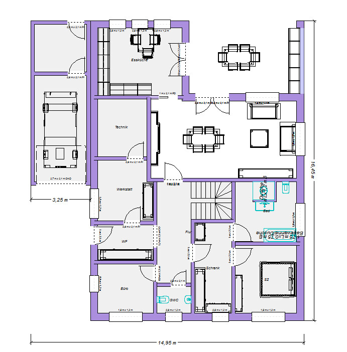

I don’t think the design from 1 is bad at all given the circumstances. I have an alternative as well, although I wouldn’t claim it’s better:
The double garage was changed to a single garage. Instead, there is a proper workshop inside the thermal envelope, which is a huge advantage in winter. The northeast terrace was replaced by a southeast terrace. However, it is very large and covered – an outdoor kitchen would be ideal.
I also have this design available 🙂
However, I would choose a wooden staircase instead of a concrete one and plan gable ends at the top instead of a hip roof, to allow for more living options in the future. Additionally, a guest room or office next to storage space under the roof would be a nice feature. Even if your parents seem to prefer a conservative lifestyle, having a sauna or space for yoga can help keep joints flexible, which tends to be more important with age 😉
