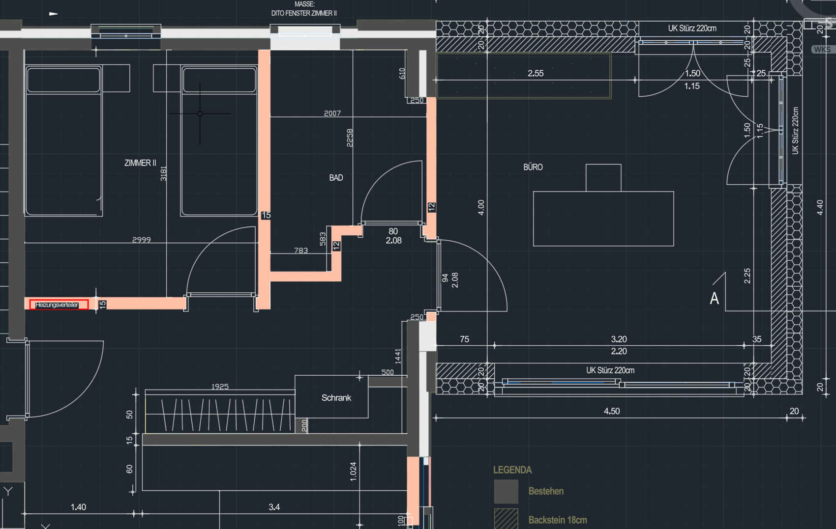

I am planning a small bedroom (on the right in the picture) and next to it a small bathroom (the middle room in the picture).
It would be nice to have a bathtub in the bathroom.
I have tried to create some sketches. I am not sure which layout to choose or how the bathroom should be arranged.
On the far left in the picture is the main entrance, where there is a small wardrobe area.
The entire space needs to be accessible.
Option 1
Grundriss eines Wohn- und Bürobereichs mit Zimmer II, Bad, Büro, Heizungsverteilung, Türen.

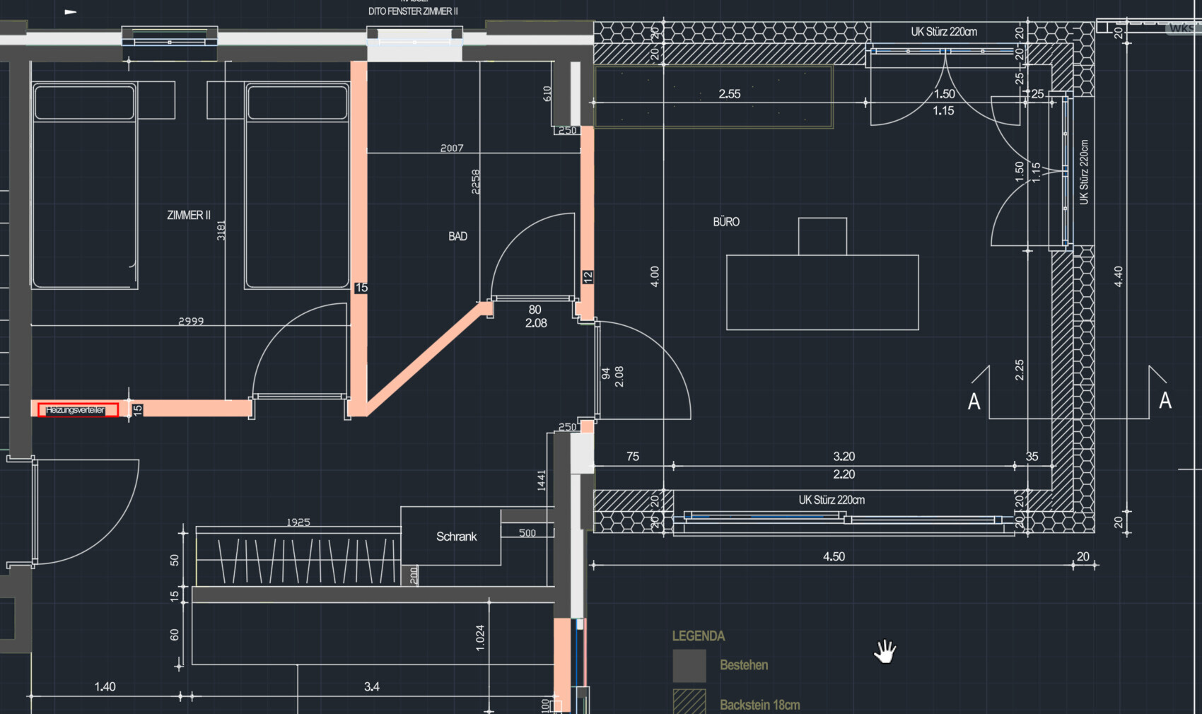

Option 2
Grundrissplan eines Wohnraums mit ZIMMER II, BAD und BÜRO, Türen, Wänden und Maßlinien.

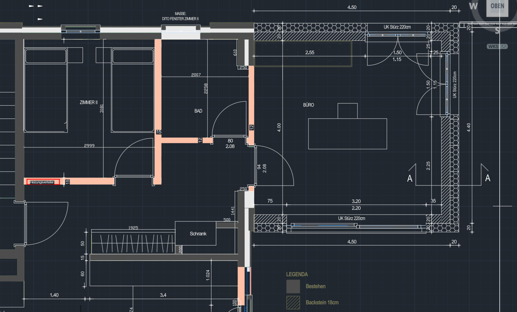

Option 3
CAD-Grundriss eines Innenraums: Zimmer II, Bad, Büro, Heizungsverteiler, Türen, Maße.

kbt09 schrieb:
@natbur01 .. you should get used to briefly sketching your own ideas as well. And, accessible areas outside the bathroom ... see the green arrow and define what type of accessibility you mean by barrier-free? Movement with a walker, a wheelchair ... or something else?
[ATTACH alt="grundriss-fuer-kleines-bad-und-schlafzimmer-690230-1.png"]91934[/ATTACH]
These brief remarks, as already seen in the thread about the step, are counterproductive for meaningful suggestions. We cannot read your mind to know what ideas you have already considered. You need to explain them here.
Thank you for the suggestions.
By barrier-free, I mean access with a walker as well as a wheelchair.
The arrow you drew indicates a distance of 85cm (33.5 inches). From what I have read, barrier-free access requires at least 80cm (31.5 inches).

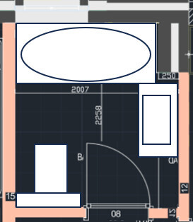

26 Jun 2025 11:28
This is possible with a bathtub. Possibly like this. It is not feasible to make it barrier-free.

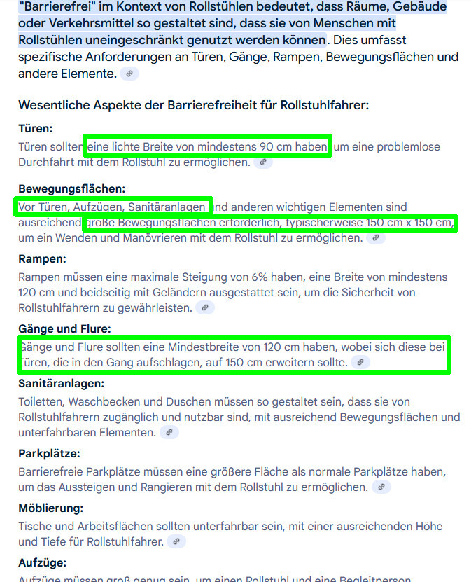

The door in such a small bathroom should probably open outward. That was the best choice for my similarly sized bathroom.
80 cm (31.5 inches) is far too narrow. With manually operated wheelchairs, the hands are always at risk. Google’s AI provides the following answers:
Dokument mit barrierefreien Vorgaben zu Türen, Flächen, Rampen, Gängen und Sanitäranlagen.

Option 1 works for access to the bedroom, option 2 does not work at all, option 3 is tight (especially since the pointed corner in the bathroom offers no added value).
