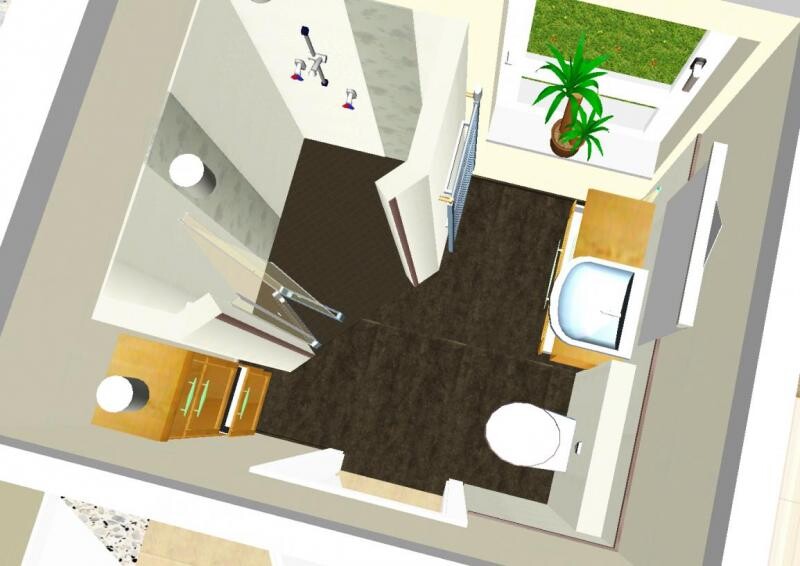

Floor plan of my bathroom, but with a nice, generous walk-in shower on the left side of the plan... in your case, it would have to be mirrored because of the window.
Grundriss eines Badezimmers (Bad) mit pinker Fläche 4,54 m², grüne Wände.
3D-Grundriss eines kleinen Badezimmers mit Dusche, Toilette, Waschbecken und Fensterpflanze
Not completely finished yet, mirror missing, etc.

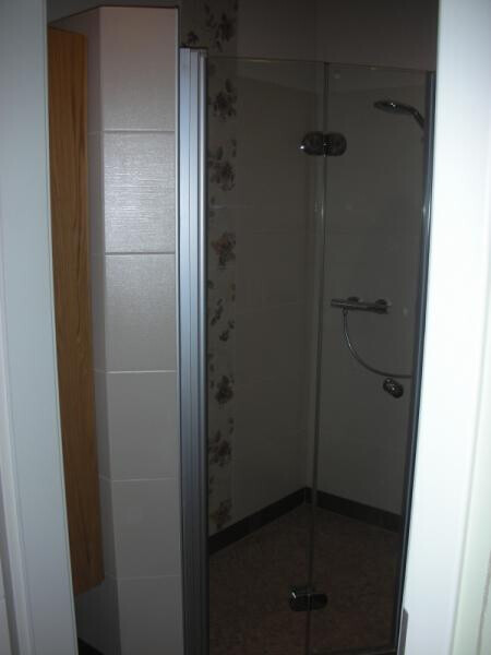

Duschkabine aus Glas im Badezimmer mit Metallrahmen, Fliesenwand dahinter.
I have been using this bathroom since 2011 and wouldn’t change anything about the layout.
